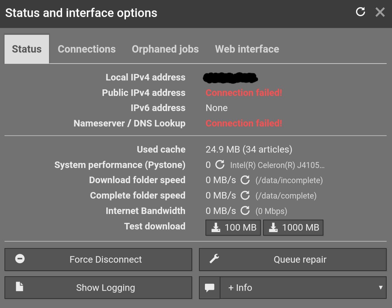

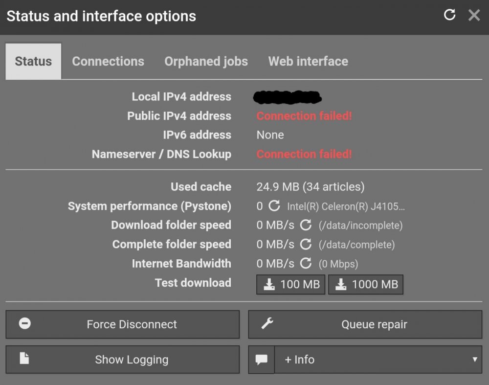

On 7/19/2020 at 8:06 AM, stridemat said:
I have my system set up to back up docker containers every Sunday morning. However, without fail I seem to get a ‘connection failed’ error within SABnzbdVPN upon the container restarting. Frustrating as none of the other containers that rely on the proxy will work either, until I go in and manually restart SABnzbdVPN.
Any ideas what might be causing the connection failed? I have a working system otherwise.
I have added some logs which I think may show the issue:

On 8/3/2020 at 6:53 AM, stridemat said:
So this is still happening every Sunday morning and I’m at a loss as to why.  The setting within ‘CA Appdata Backup/Restore v2’ are as below. Looks ok to me and no other app has this issue.
 So still having this issue and at a loss to why. Looking at the Unraid logs and not just the docker logs the following is noted:

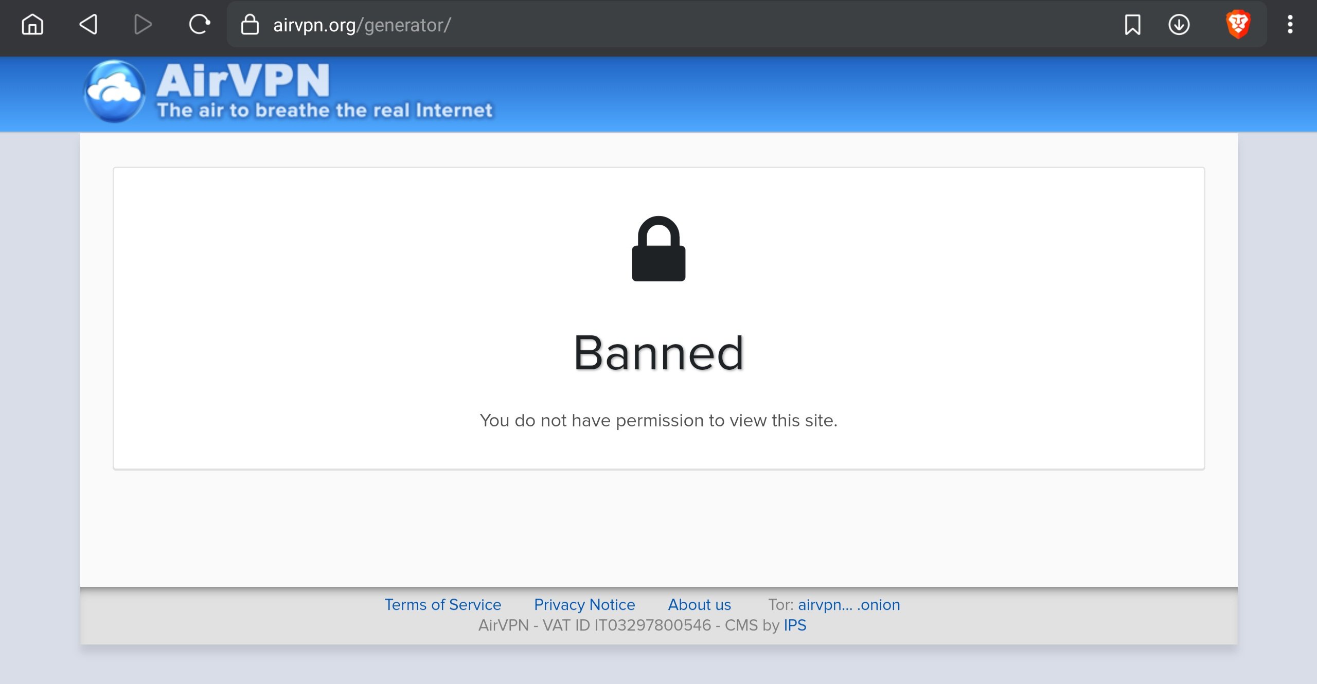

***EDIT - I might have to hang fire on moving over to AirVPN, I've just tried to log back into my account and it states I'm banned from their entire site! I don't think I've ever been banned from anything before. Not even two hours of use, and I only tried SabnzbdVPN and DelugeVPN, from the same computer. 😂
***EDIT two - Well, AirVPN customer service got back to me and apologised for the mix up and reinstated my access. I think I'll give them a miss and try Mullvad instead, if they are this prone to mistakes. On a side note, I've managed to get Mullvad working with SabnzbdVPN. I'm currently using ovpn files from Mullvad however they also supply WireGuard config files. Would these work with SabnzbdVPN somehow?

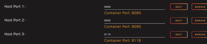

Do you know if there is a way to use any other port than 8080?  I current have unifi controller that needs 8080 for it to communicate with the managed switch.  I have a non-dockered sabnzbd running on 8800 and would like to move all that over to SabNZBDVPN.
Thoughts?
Edited by Mecheng70
Thoughts?
If I’m understanding the question correctly you can just map to any unused ports when setting up the container.
Don’t forget to check your docker allocations to make sure your aren’t using the port for something else.

I found a problem a couple weeks ago with SabnzbdVPN not displaying the Public IPv4 address and Nameserver / DNS Lookup (same error seen in some posts above).
After much trial and error i was able to fix the problem by deleting the 209.222.18.222 name sever from the config. It look like that server is timing out most of the time.
It looks like the DelugeVPN docker has the same server configured by default as well.
Tried this in the hopes to fix issue I've been having with DelugeVPN and SabnzbdVPN with PIA for about two months now but still SABnzbd is stuck on listening to port 8080. About the only potential red flag I can see in the logs is:
