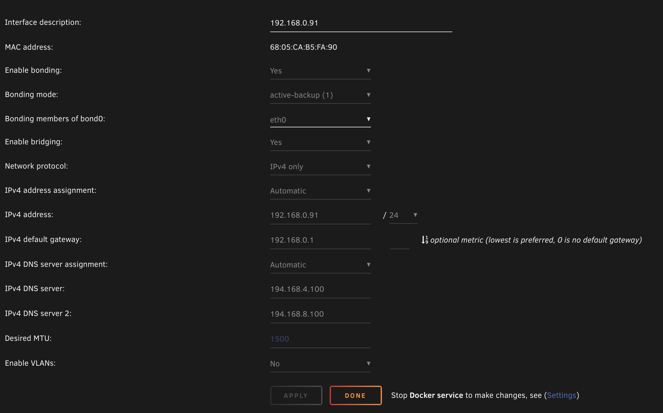

Hello, please can someone help me. I am using SABNZBDVPN and although it is connecting fine in my Unraid docker, I am unable to load the WEB UI. It started working for me last weekend but has all of a sudden stopped again. I have rebooted my router and my server but nothing seems to be fixing it. All of my settings are fine in terms of getting it working and it is still downloading fine. I just can't access the WEB UI. Please if anyone knows what the issue might be I'd be very grateful.
Same for this and DelugeVPN.  Working but can't access the WebUI.  Logs aren't showing anything unusual that I can see, just started happening. I've restarted the Docker service as well as the UnRaid server.  Thanks!
your issue will be most probably vpn provider related, please do the following:-
https://github.com/binhex/documentation/blob/master/docker/faq/help.md
Edited by binhex
Edited by binhex
Hi Binhex. Thank you for this. Here is my log file. I have added the word REMOVED where my log in details were.
that looks like a successful start to me, what is the ip address of the client you are using to access sabnzbd web ui?
192.168.0.91
 Thank you!  It was the modprobe: FATAL: Module iptable_mangle not found in directory /lib/modules/4.19.107-Unraid error.  That made me re-look at my configs.  When I had restored this container it was from a previous backup that had the wrong LAN_NETWORK defined.  Interestingly though, if I manually ran the modprobe iptable_mangle command, I could access the WebUI even though I had the wrong LAN_NETWORK defined.  But I corrected it the proper way.  Thanks!
3 hours ago, binhex said:
then thats your problem, you have lan_network defined as:-
2020-07-06 04:56:04.965798 [info] LAN_NETWORK defined as '192.168.1.0/24'
read Q4 here on how to set it correctly:-
https://github.com/binhex/documentation/blob/master/docker/faq/vpn.md
The IP for my Server on my router is 192.168.0.91. So when you say client do you mean my VPN or my Router? I have included my network settings as a screen shot.
