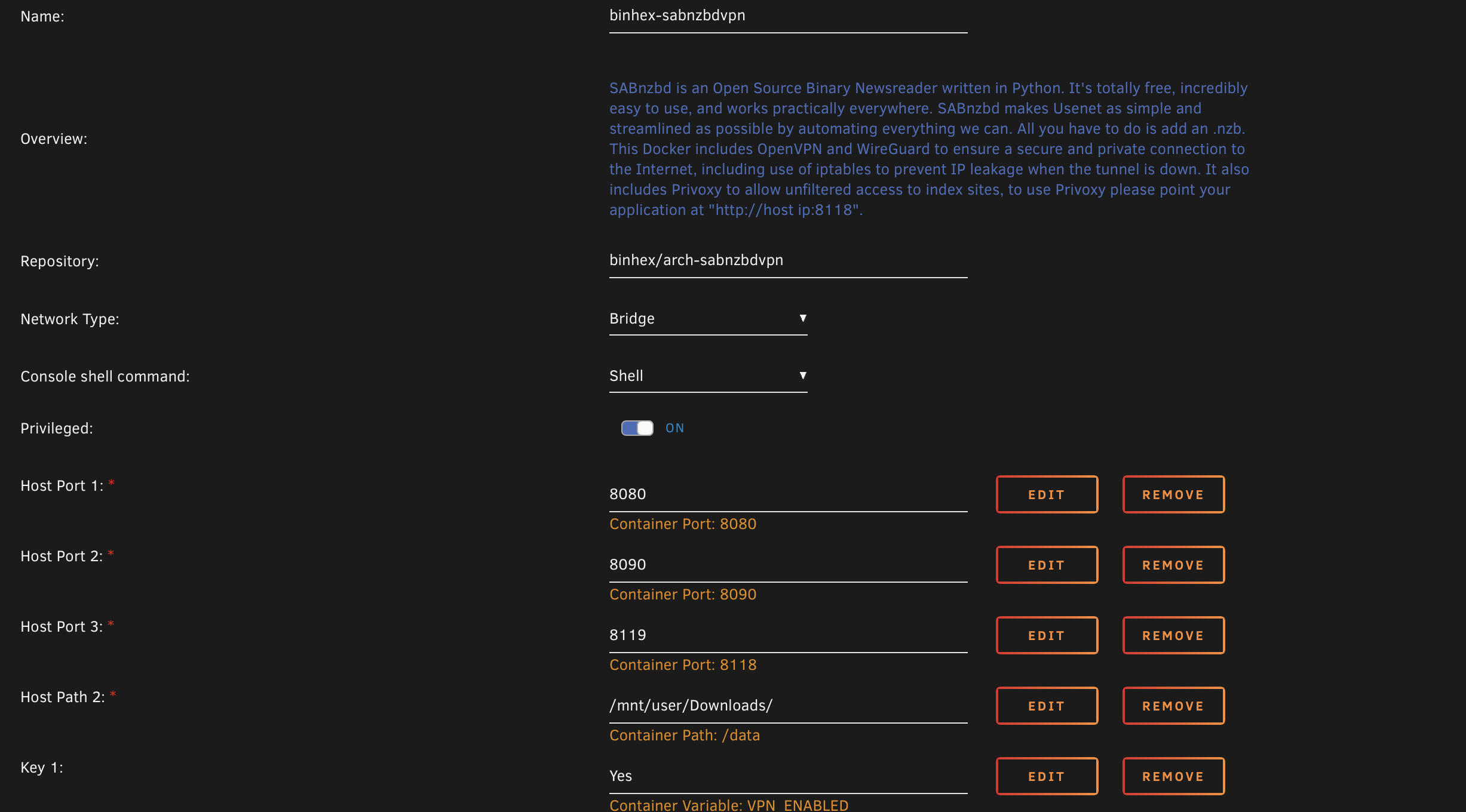

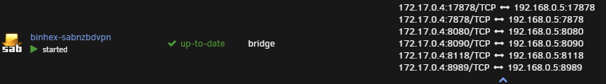

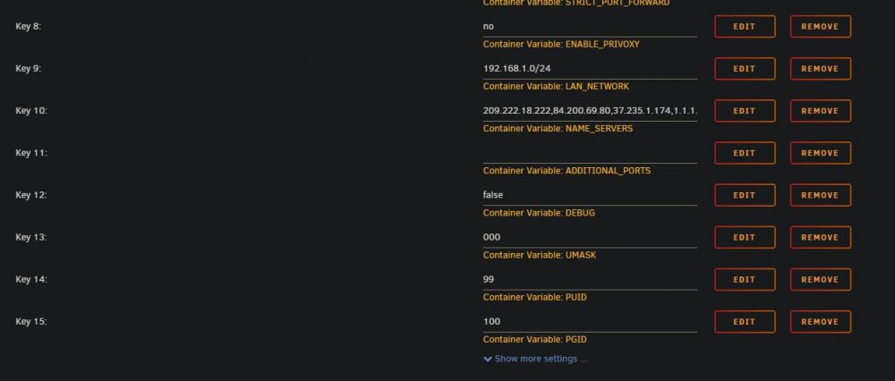

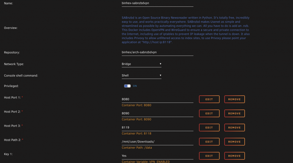

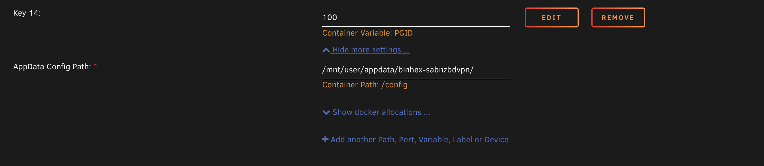

Ok so I suppose I really should of not updated my sabnzbdvpn docker until reading the forums. Been running stable with OpenVPN configured and once I performed the docker update I am seeing a couple of things.
1. The first thing is I can't access the Dockers WebUI
2. The second is my other dockers such as Radarr/Sonarr can't connect to the sabnzbdvpn docker
3. I am also seeing in the logs (supervisord logs) the following errors.
021-02-26 16:21:34,066 DEBG 'start-script' stdout output:
[info] Starting OpenVPN (non daemonised)...
2021-02-26 16:21:34,071 DEBG 'start-script' stdout output:
Options error: Maximum number of 'remote' options (64) exceeded
Use --help for more information.
2021-02-26 16:21:34,075 DEBG 'start-script' stdout output:
2021-02-26 16:21:34,080 DEBG 'start-script' stdout output:
2021-02-26 16:21:34,083 DEBG 'start-script' stdout output:
2021-02-26 16:21:34,088 DEBG 'start-script' stdout output:
2021-02-26 16:21:34,092 DEBG 'start-script' stdout output:

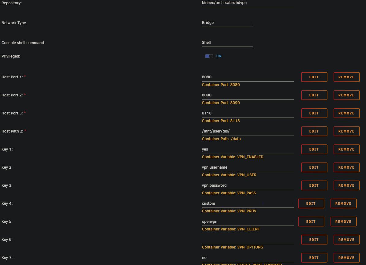

Also note that I have been searching the internet based on this error and I see results like this from this forum. Not sure if its related but it looks like I can't complete the VPN connection process for some reason and I have verified that the endpoint remote sites are reachable. https://unix.stackexchange.com/questions/386105/openvpn-daemon-not-using-config-file

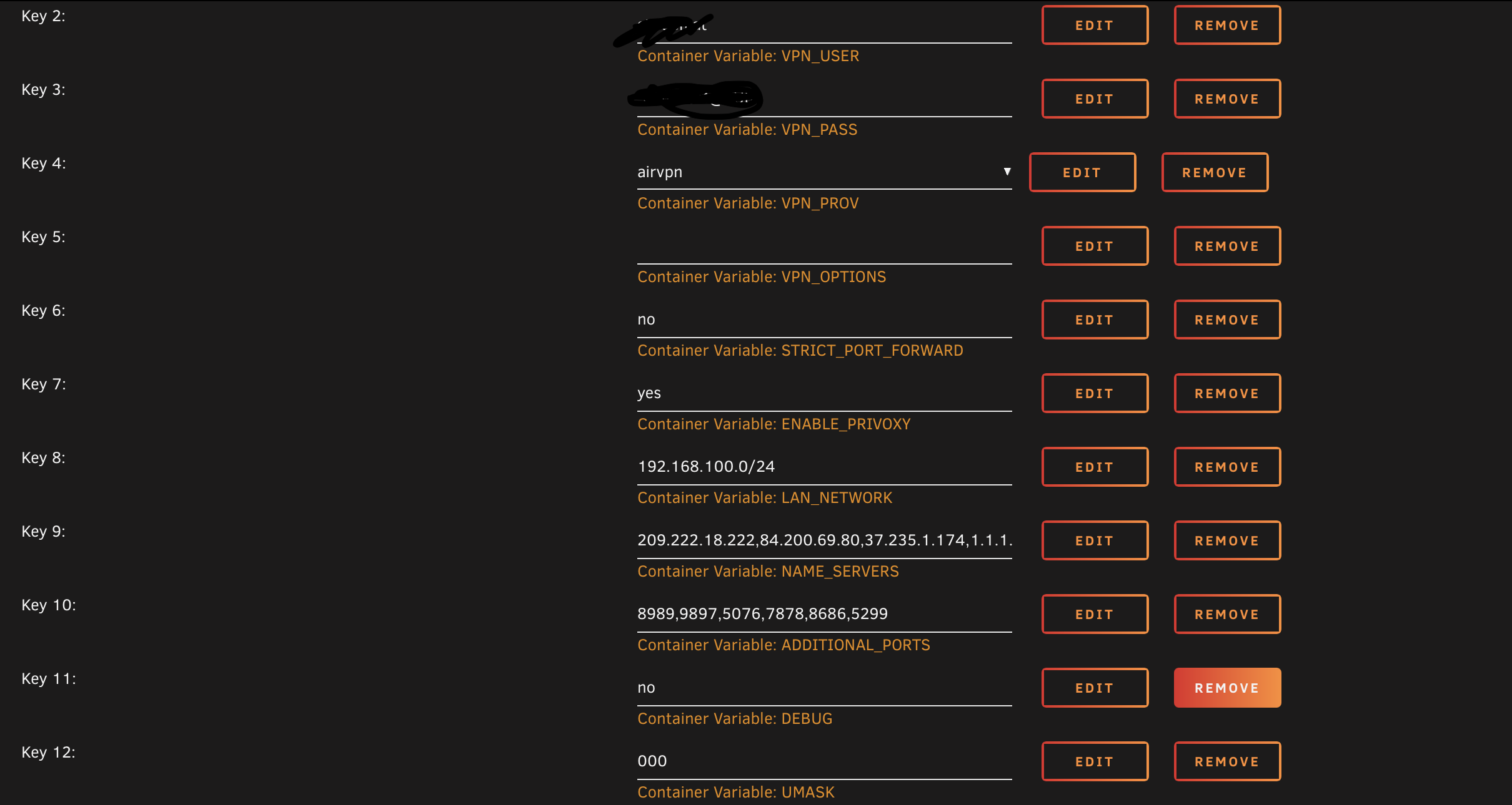

I have attached screen shots on my docker config to help better paint the picture as to what could be the issue. Please provide some guidance as to what might help. I have read through what other users have done with small workarounds but its a bit hard to follow without better screenshots & documentation to try. Thanks for the help, support, and development of a great docker/app .1383894846_sabnzbddockerconfig2.thumb.JPG.926ca9d94786e5796a27657b2030433e.JPG1215215065_sabnzbddockerconfig1.thumb.JPG.423a6a56b6333c315d525ccb608575b5.JPG
Edited by SubRetro

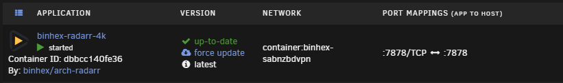

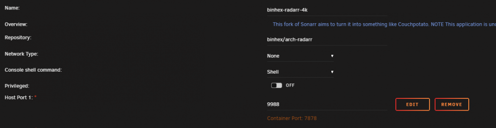

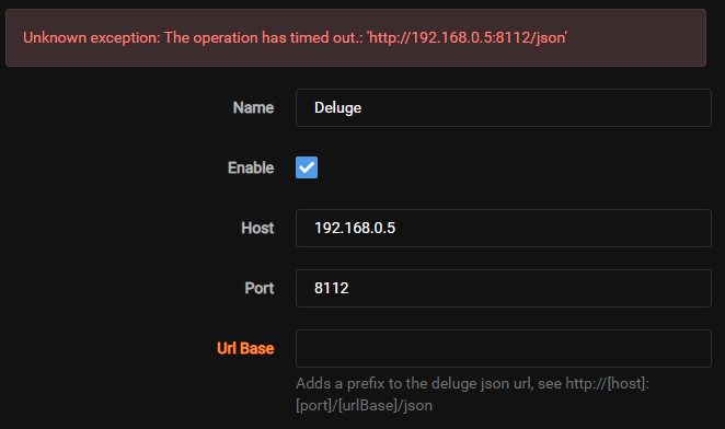

Hello, is it possible in Sickchill also to enter an address which is ignored by the proxy ?

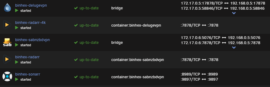

Got everything back up and running, I have sonarr, radarr and nzbyhdra2 running inside this container, and I was able to quickly get nzbhydra back up and running but I ran into a wall with sonarr. I ended up fixing by mapping the port to the internal port vs the external port. For example for my SABNZBD installation, the port 8080 is mapped to 6700 externally, and while I previously connected sonarr and radarr via IP:6700, I not only had to change from IP -> localhost but also 6700 -> 8080.
Not sure if its worth adding to the FAQ because my setup was weird/bad, but if anyone else runs into issues trying to connect sonarr and radarr, make sure not only is the internal IP set to localhost, but also the internal ports.
Thanks again for everything @binhex! you the GOAT.

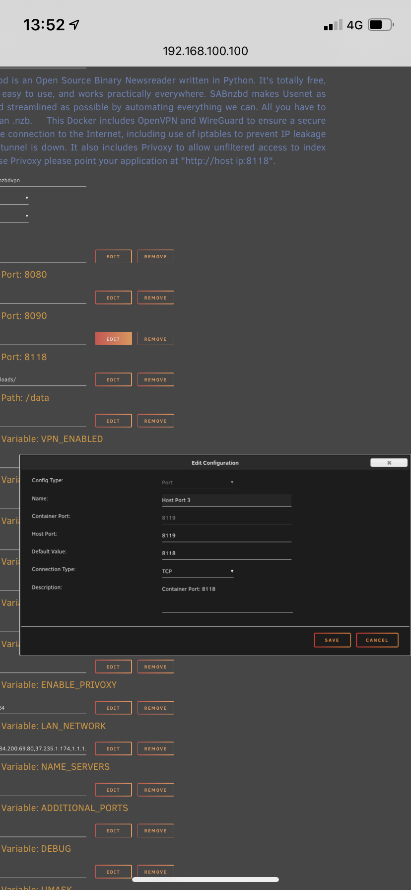

Hi ,
After the last two updates of binhex/arch-sabnzbdvpn (3.2.0)  I have also had issues with Radarr & sonarr connecting to binhex/arch-sabnzbdvpn .
Found that I needed to turn of proxy function for Radarr & sonarr that runs through 8118 in sabnzbdvpn.
This is not what I want to do, but so far have been the option where I can keep all the functions in the arch-sabnzbdvpn ON. (VPN, STRICT_PORT_FORWARD and ENABLE_PRIVOXY)
It does not seem like the tick off for the "Bypass Proxy for Local Addresse" in sonarr & Radarr does what it should do.
So any help on this issue would be greatly appreciated.

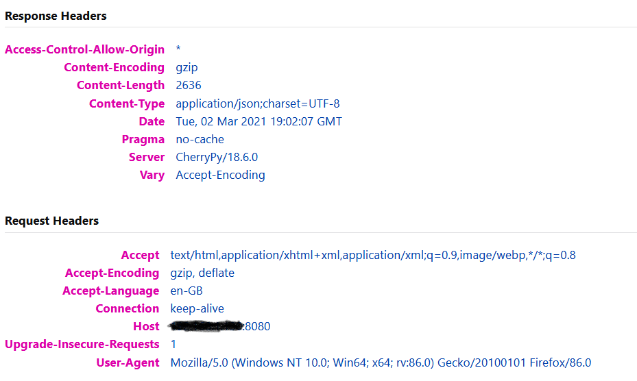

Hi, about when the new version came out SABnzbd seems to have stopped working. Now its probably something obvious, but nothing seems wrong when I look though the config and the logs.
Sonarr / Radarr etc all work fine as does testing connections to providers from within SAB. Any ideas?

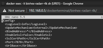

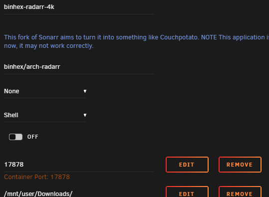

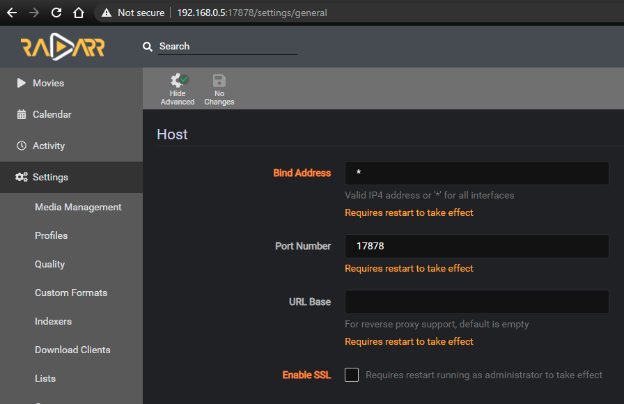

What are people doing when running multiple instances of a docker?
I have 2 Radarrs. One for 4k, to automatically keep the library separate. But the only way I could get it running through Privoxy was to run Radarr through SABNZ and Radarr-4k through Deluge.
After fixing this up as per Q24 to Q26 in the FAQ. All is working except the Radarr going through SABNZ can't see Deluge and the Radarr-4k going through Deluge can't see SABNZ.
The reason they were setup going through different Privoxys was even when I assign a different port number for Radarr-4k, it still didn't want to load. Maybe I need to go back and revisit that?
But on my Docker page it looks like this;
I'm not sure why port mapping still says 7878 and not 17878 as I have set in the docker and in Radarr-4k.
Hopefully others who have multiple docker instances too can help.
Clearly I'm not doing something properly.
Cheers

On a separate note, it’s is possible to change the proxy port on the VPN container from  8118 to say 8119? Is it as simple and just changing the mapping when editing the container?
yes simple enough, the golden rule is ONLY change the host side though, never change the container port as its hard set, but the host port can be whatever you want, as long as its not already in use.
Thanks. I think I may also have ballsed that up.
The container port is greyed out. It reads 8119  when the value it should be is 8118. I guess it a case of recreating the entry again then removing this one?
yep delete the stuffed up port, add port and re-define it with the correct port numbers
Thanks. All sorted now. Much appreciated.

20 minutes ago, IrishBiker said:
Hi All
Anyone else has issues with sabnzbdvpn? Both Radarr and Sonarr are reporting they can't connect. Checking the sabnzbdvpn log file, nothing is jumping out at me, all seems fine. I even forced a re-download of sabnzbdvpn with the same result. It worked on Sunday but stopped working yesterday.
Sonarr reports the following:
HTTP Error - Res: [GET] http://not.telling.you:8080/api?mode=queue&start=0&limit=0&apikey=(removed)&output=json: 503.ServiceUnavailable
however running
http://not.telling.you:8080/api?mode=get_config&apikey=_specialkey_&output=json
displays the usual json enteriesjson.png.09a2a8b998dc3f4894448610e5247e47.png

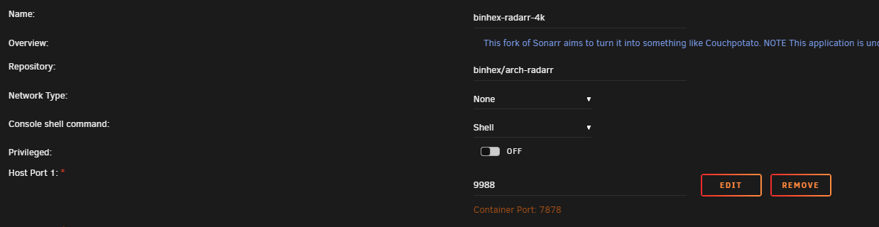

It doesn't seem to want to map?
It should be port 9988 on the Host side in the image below right?
I was looking in the wrong spot. :P
All good now. Back to using my original port 17878 when it was going through deluge.
Ok, one last thing. Is there something special I need to do to make radarr/sonarr to talk to binhex-delugevpn, when radarr/sonarr are going through binhex-sabnzbdvpn?
I keep getting;
Other then that, all containers are running and I can connect to them all. All indexers are working.
Just can't connected to Deluge in radarr/sonarr.
Edit: And connecting to SABNZ is all good too.
Edit2: I guess I could download the normal Deluge docker and route that through SABNZ. Then I could just use localhost like I did for Sonarr/Radarr connecting to SABNZ.
Edit3: I tried various combos for Host; Server IP, localhost. But oddly putting in the Docker IP works;
