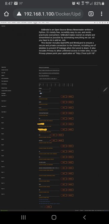

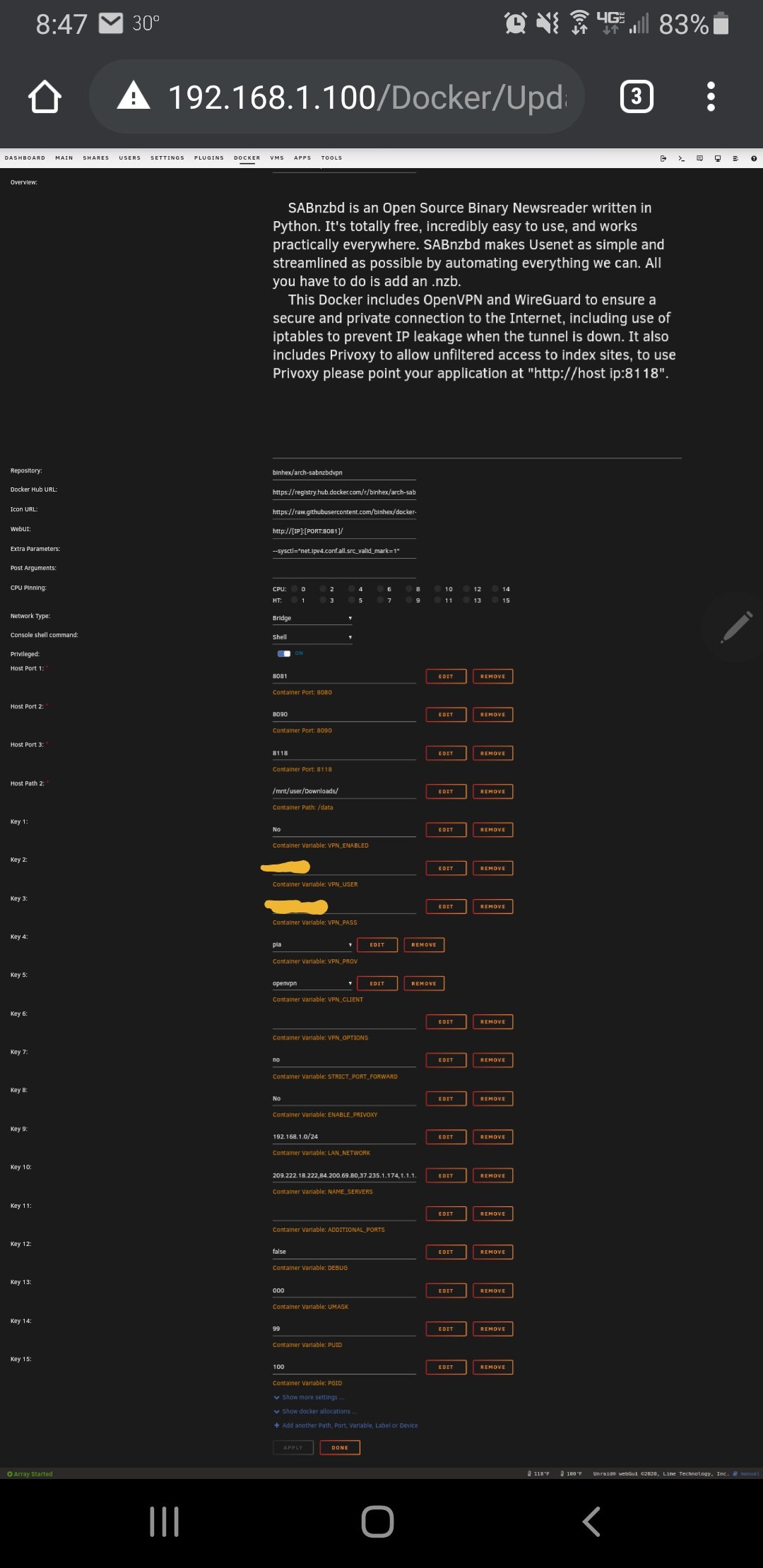

4 hours ago, binhex said:
what do you mean by this?, you didnt change the container port by any chance did you?, if so you shouldnt do that, you change the host port not the container port.
I am very much a noob when it comes to dockers.  Please see attached
the attached looks fine, you have configured it correctly, have you tried accessing the web ui from another machine or a different browser?, it should work, especially with vpn disabled as there are no iptables in play then. also what url are you using to connect to the web ui?.
looking at your screenshots the url should either be (depends on whether you turned on tls):-
http://192.168.1.100:8081/
or
https://192.168.1.100:8090/
Edited by binhex
