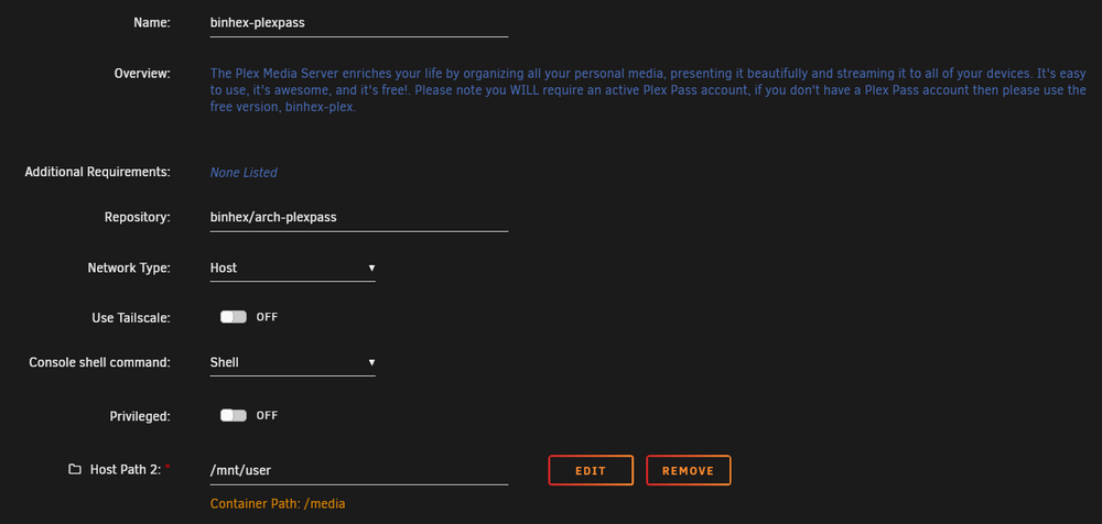

For this reason I deleted the image and also removed the entire appdata/binhex-plex folder.
But now I see another docker container in the apps library "binhex-plexpass" what is the difference between this and "binhex-plex"? Both have the same description.
I seriously don't see any difference between these:
https://github.com/binhex/arch-plexpass
and
Nevermind, I got my answer from this:
Think it could be a little bit easier to tell the difference in the name/description/README.md that plex-pass is the beta/early access container.
Th
Edited by plantsandbinary

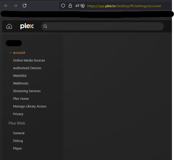

Plex Server Not Working - Server "Disappeared"
Short background: Set up like 1 year ago if not more. Never had a problem. Few days ago, I wanted to watch a film, and nothing worked.
Here, more or less the sequence of actions:
  1. Went to Unraid and checked the Docker App was running and it was. But once opened WebGui, everything was gone:image.png.a9c7c24747e1e5334ef084794ab8ea99.png
  2. After several restart App, Docker and even the server, with the same outcome I completelely removed the App, App Imaged and used Appdata Cleaner to removed files left. Installed again (not from template), but as new but same outcome.
  3. Logging on the website instead of the local docker I get the same page. It is like Plex Server it is not running. Here is a screenshot from the website. No error, no nothing. Server completely disappeared.
  4. I started trying some low level stuff like removing Preferences.xml, manually inserting a new Token, insert the Token in the settings of Docker app, nothing. I was not even once able to get the "first setup page" as like I set up the first time, where it asks me Library and stuff...
  5. Yes, I have checked Library path on Unraid, it is correct. Just to prove it, I log in console from Unraid GUI and I can browse my Media files from Plex Docker App:
  6. I tried to run "Docker Safe New Perms" on Unraid. Nothing changed.
I have absolutely no idea. I am going crazy...already also asked for help on Reddit on both Unraid and Plex sub, no luck again. Here it is Reddit post.
Please, really, help me fix this. 🙏

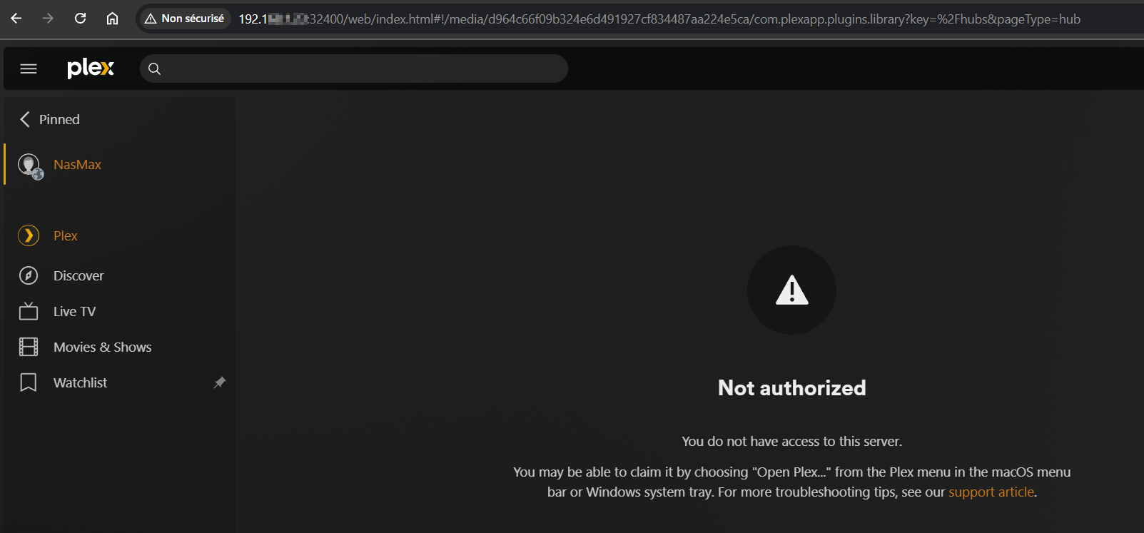

No access to the webUI Access, Thoughts/suggestions? other dockers are running fine.
Upgraded to the new container available just now, the WebUI no longer comes up (400 Bad request) and the logs end in:
Critical: libusb_init failed
Search is telling me that this is not a problem so it is possibly just a coincidence I'm seeing this error in the logs and something else is stopping the webUI from loading. Any thoughts appreciated, these plex containers have run flawlessly for more than a year only to be borked by this.
Edit: I did a backup of the folder in my appdata, then uninstalled the container and reinstalled it from Community Apps. This did fix the 400 Error (I can get into Plex WebUI now) but I still have the libusb_init failed error. The pages on this were probably right and this is unrelated to whatever issue was breaking the WebUI or server app.
In any case the fix seems to be a simple Uninstall/Reinstall, although I also went to the trouble of rebooting the containers and then the machine (it did nothing).
Edited by ezgoodnight
updated/fixed issue
ignore it, that is a stupid error reported by plex, its not critical.
this may of been due to plex performing a database upgrade for you, always check the logs before stopping the container, i know Plex Pass users have been seeing this, so i suspect the upgrade is now pushed to Plex.
The easy fix was removing the container and setting it up again. It was like losing nothing because everying was still in appdata.
Just now one of my other computers was getting the 400 Bad Request and the fix was clearing the cookies in the browser I was using. Everything is normal now.

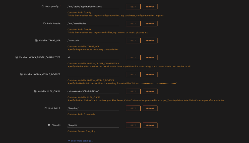

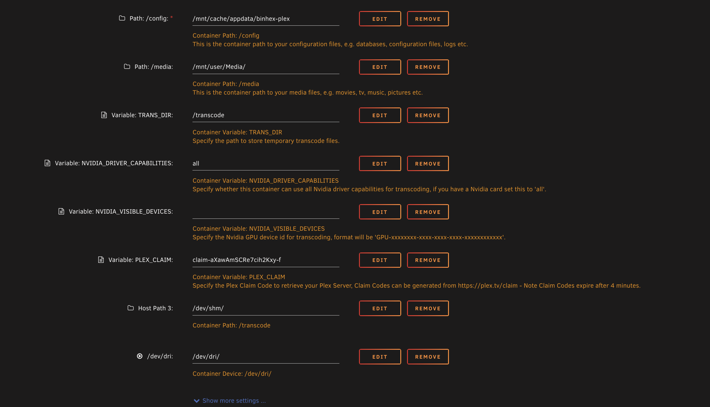

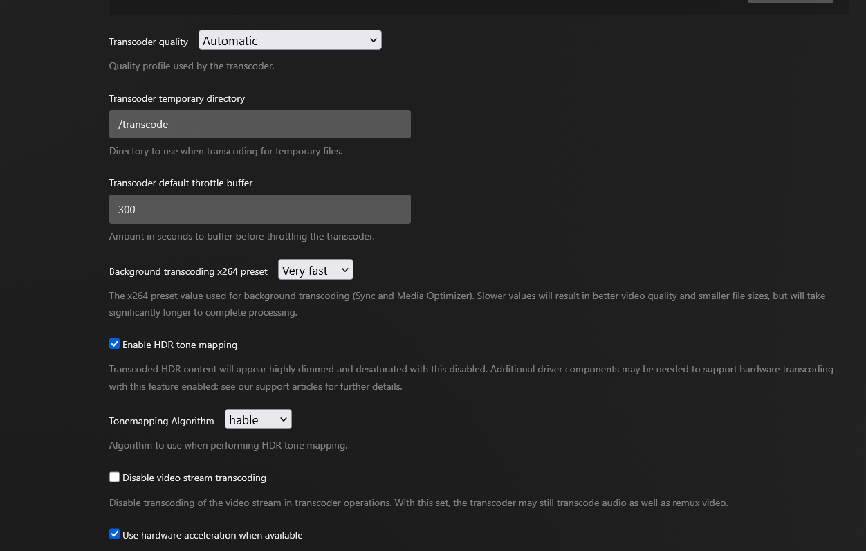

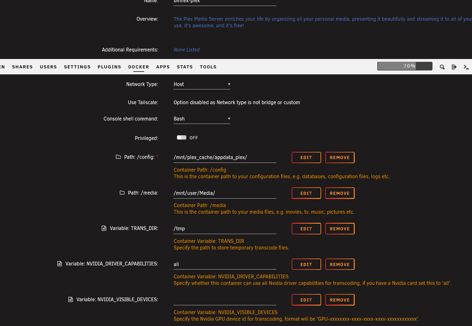

Having a problem with plex constantly filling up my docker VDISK with cause my server to go unresponsive, i know it's probably a mapping in the container but for the life of me i can not figure it out.
-Currently on unraid 7.1.4, worked fine for years on 6.12 till i upgraded, then started having issues and reinstalled plex multiple times and different containners after deleting the vdisk.
-Did memtest multiple times, shows pass.
- When you look at container size, plex has grown to 23gb, my docker image is now 50gb, all other dockers do not grow.
any assistance greatly appreciated.
R,
Trevor
offroadnut-diagnostics-20250708-1953.zip

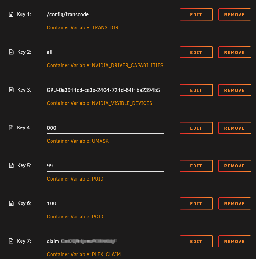

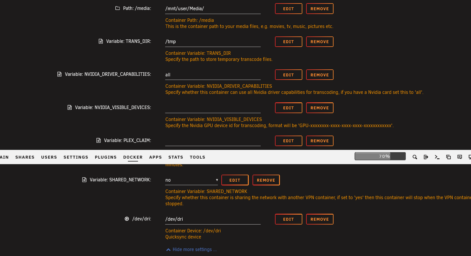

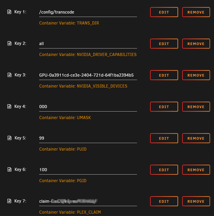

I can see one issue, TRANS_DIR, this env var defines where transcodes get written to, you have defined it as /tmp, that means transcodes get written to the /tmp directory inside the container (not the host), if you want to transcode to ram then follow Q1:- https://github.com/binhex/documentation/blob/master/docker/faq/plex.md
EDIT - Just spotted you also have Plex 'Transcoder temorary directory' set to /transcode, well that doesn't exist in your configuration (according to your screenshots).
Thank you for the info, i did the changes you mentioned in Q1. Do I need to change the Plex transcoder temporary directory or leave it as /transcode?
was that all I needed to correct? greatly appreciate the assistance, still learning the ends and outs of linux and dockers.
that depends on the container path name you use for the bind mount for /tmp, if you named the CONTAINER path /transcode then you are set.
as far as i can see, yep the rest looks ok.
I would like to transcode to RAM on my Unraid. I have 32 GB. Do I have my container set up correctly?
In the plex app .....settings transcoder-temporary transcoder directory..... I have it set to /transcode

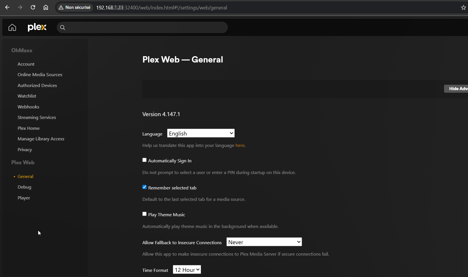

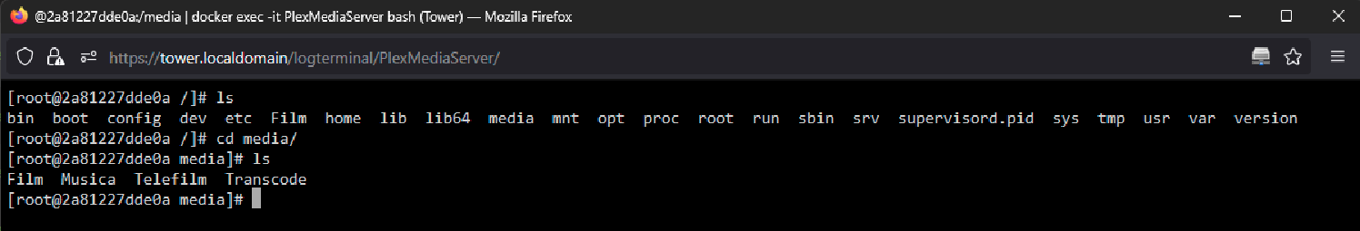

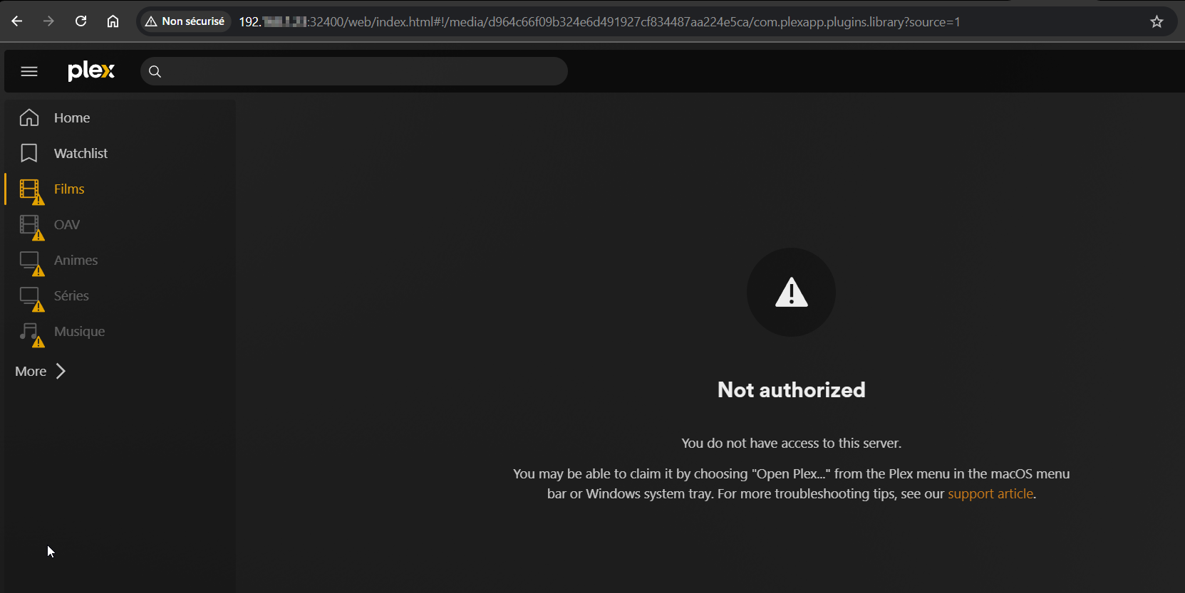

Hello I have followed all theses steps, i can connect correctly in local like you in step 7, but in step 8 spanner icon > settings > general i cant see the warning to reclaim so i cant do the step 9 and my librairies stay empty
I even try to add a token claim variable in the docker settings (seen that from reddit post) but didnt change anything.
If you can help me i will be glad to give all the needed information thank you !

I'm having issues with transcoding on an Ultra 7 265K for Plex. I have Unraid 7.1.4 .
/dev/dri/ is added
I am able to see the card0 and renderd128
I am not able to see the iGPU in the gpu plug
Is there something I am missing? Plex hw selection is turned on. I was able to get it working with a NVIDIA GPU but not my intel iGPU.
