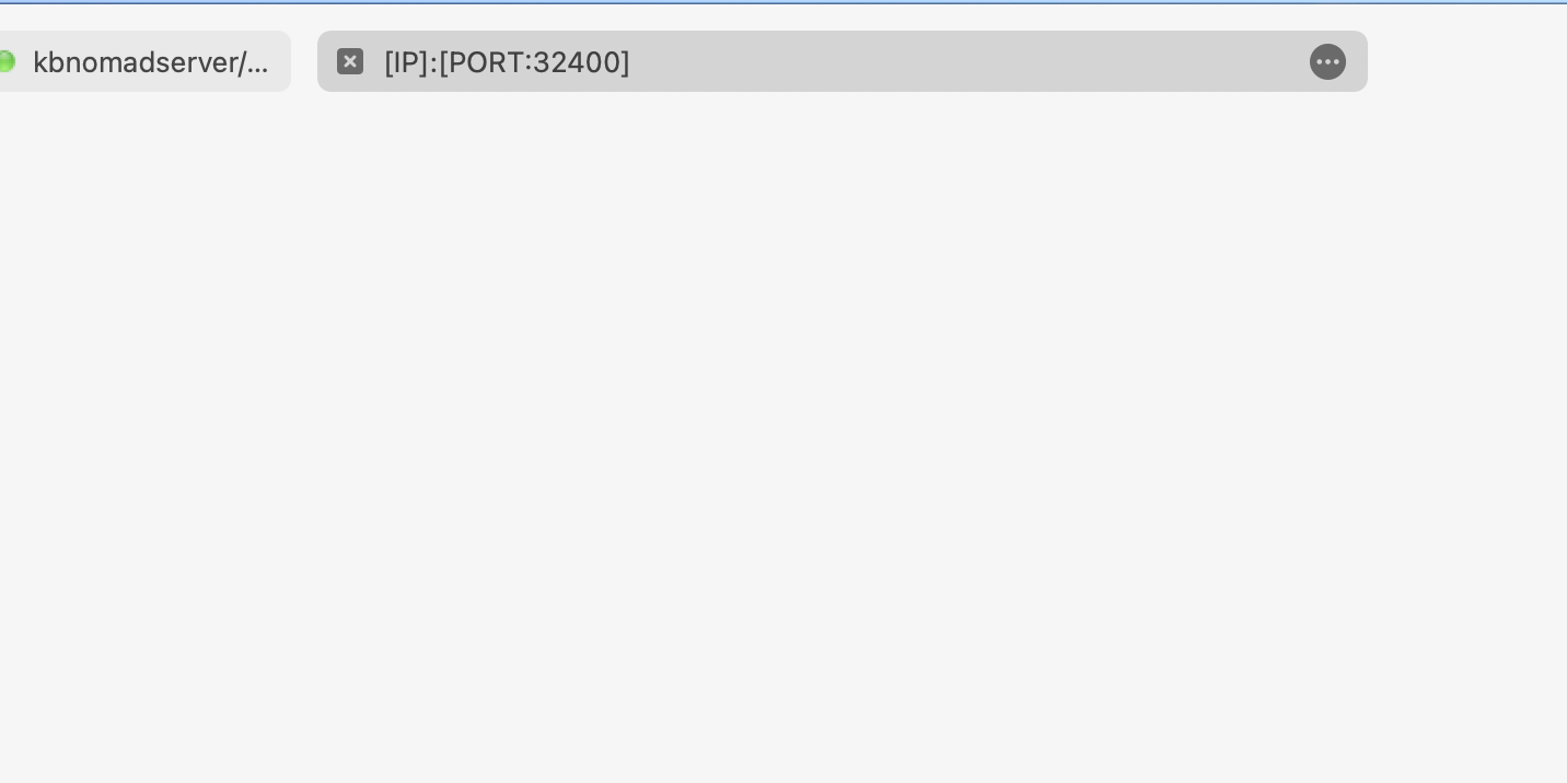

I noticed a bug on binhex-plex docker.
When I use the Network Type: Custom : Bond0;
Accessing the WebUI just outputs [IP]:[PORT:32400] instead of the actual variable value (Fixed IP Address).
Any workaround or fix on this?

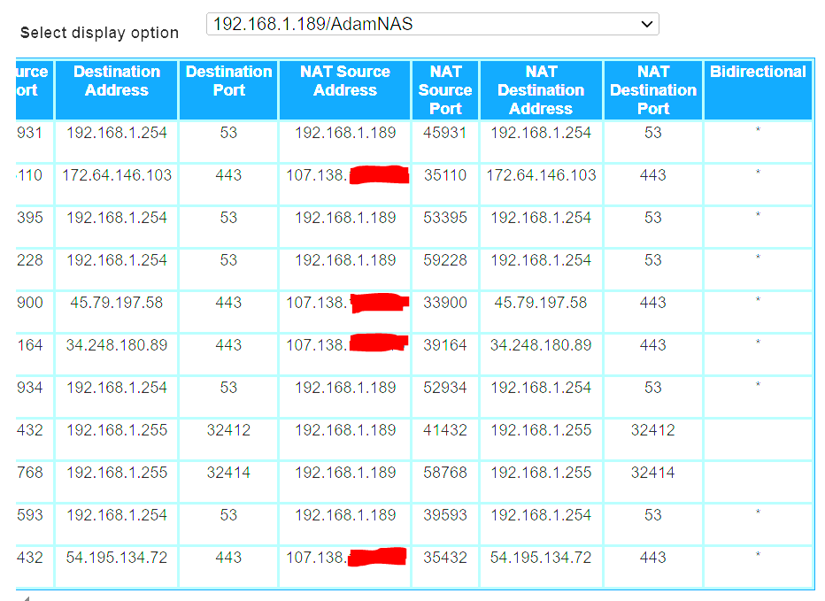

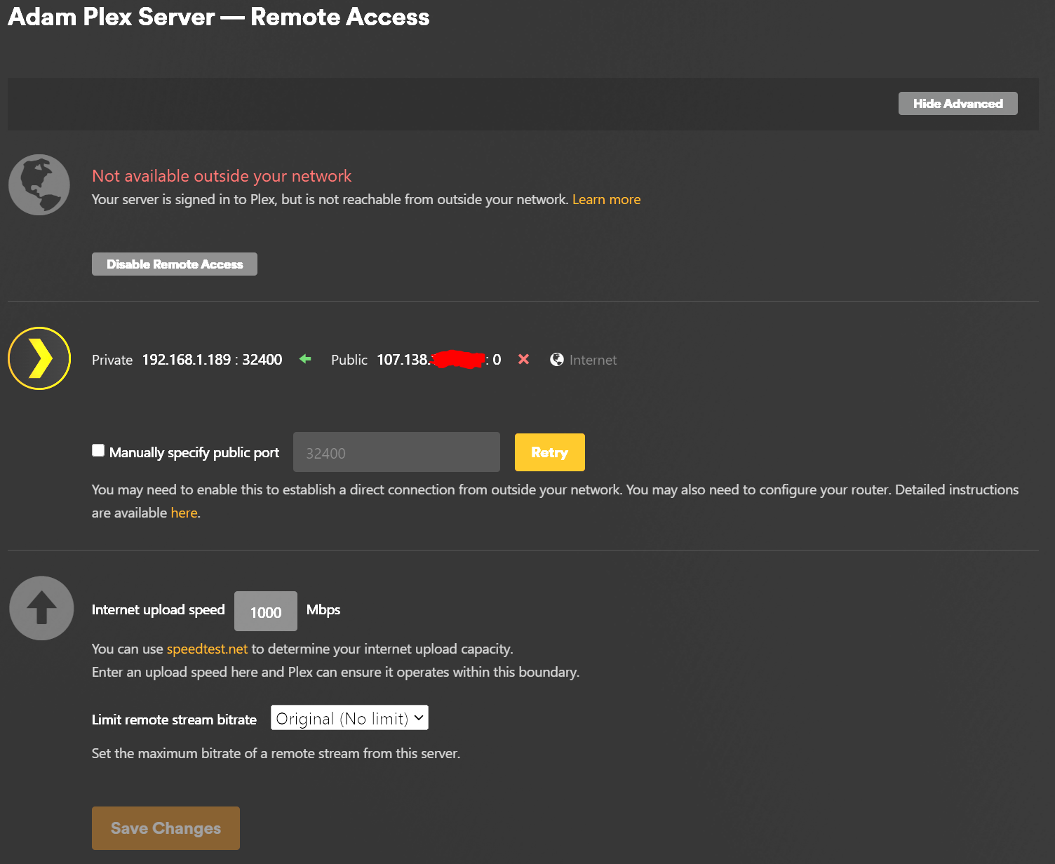

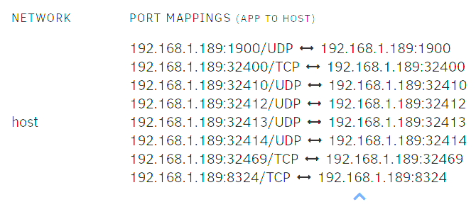

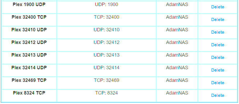

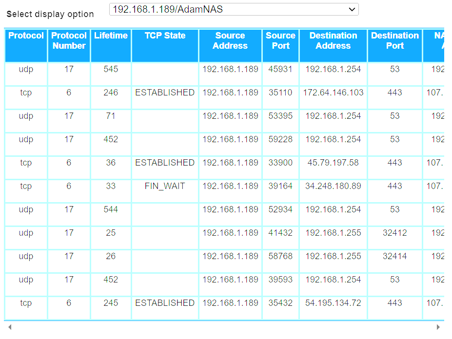

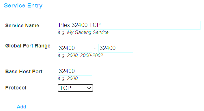

Is this where I come for support with Plex in unRaid? I don't think I installed the binhex version but I didn't see a support thread for the official Plex docker. I don't know the difference in the binhex version and the official version.
I'm having trouble getting Remote Access to work correctly and I know that I've forwarded each port that Plex uses correctly in my modem settings. I had Plex working on a Windows server prior to moving it to unRaid and I had the same port forward rules setup for my Windows machine. I have the Plex docker setup as "Host" network type so it should be using my server's IP address. Can someone help me get the remote access working correctly? I think its causing all my clients to connect indirectly.
Plex Docker Port Mapings:
Modem Port Forwarding Rules (AdamNas = 192.168.1.189)
This just show how the rules above are defined in the modem/router.
Plex test for remote accessibility.
Modem NAT for Plex Server IP (192.168.1.189). I post this because it looks like other ports about being used. (1 of 2...had to scroll to the right to see the rest)
Modem NAT for Plex Server IP (192.168.1.189). (2 of 2...had to scroll to the right to see the rest)
The official Plex docker is supported in Plex forums, not here.  Binhex and Linuxserver versions of Plex docker are supported in these forums.  They are all just different packaging of the same code with the same functionality; not a lot of differences really.
You may still find some help here if someone is able to point you in the right direction or you may be referred to the Plex support forums.

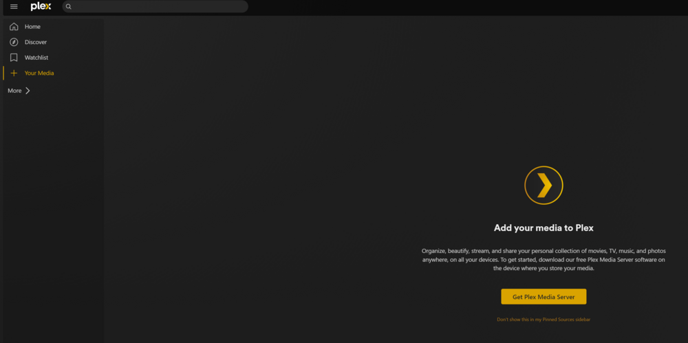

Hi....after last docker updates my Plex disappeared and at Previous Apps they showed Plex and PlexMediaServer(official) so reinstalled PlexMediaServer and it worked again but seems glitchy.
So I want to try your Plex version - how can I properly migrate or redirect library to this docker?
Otherwise I started PlexPass and it shows empty.
Thanks Norm
That's your problem, this image is designed to work using the default 'bridge' if you want to use custom networks then you are on your own, sorry.

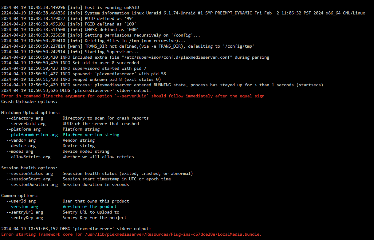

Hi im getting this in my logs for Binhex Plex, Radarr, Sonarr, prowlarr and crusader. Weirdly enough Binhex-Deluge only starts, been using Bin-Hex for years and havent changed anything
2024-04-12 13:02:09.129783 [info] Host is running unRAID
2024-04-12 13:02:09.152002 [info] System information Linux af1ee9e95dd7 6.1.79-Unraid #1 SMP PREEMPT_DYNAMIC Fri Mar 29 13:34:03 PDT 2024 x86_64 GNU/Linux
2024-04-12 13:02:09.176885 [info] PUID defined as '99'
2024-04-12 13:02:09.204597 [info] PGID defined as '100'
Anyone point me in the right direction of a fix?

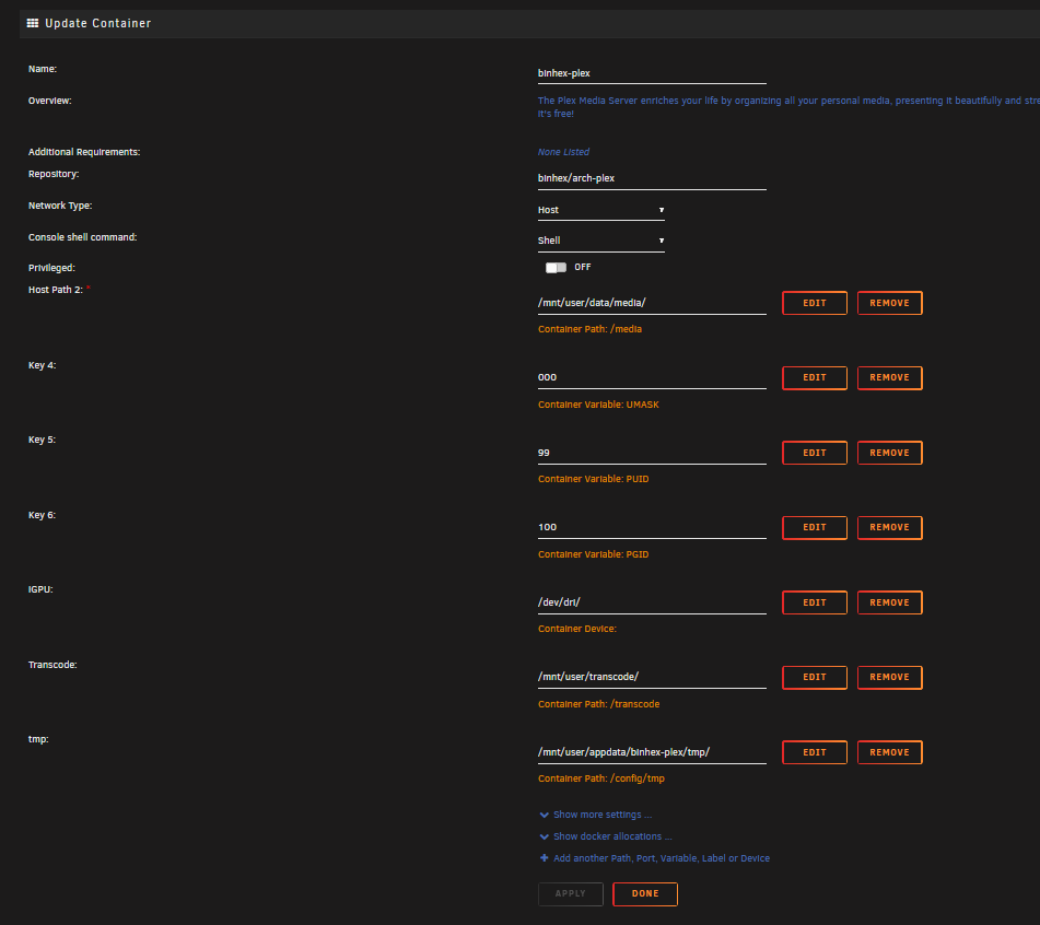

I am having some issues with Plex. Music analysis is filling up the temp folder and it never empties, after a while plex will crash and not start. I created the "tmp" directory because in the plex log it was hung on sonic analysis with an error that it couldn't create the /tmp folder, after I added it sonic analysis got moving, but the container takes a while to start now and throws some complaints in the log. Any got any ideas how to do this correct?
I wanted to get transcoding moved to ram to stop the transcode folder from filling, but when I did that sonic analysis was hanging and having issues.
Edited by lightsout
I got rid of the extra tmp path. Plex is back up and running, but seems like sonic analysis has started over with my 10,000 albums. And is stuck at 0%, as much as I love this feature it has been a real pain.

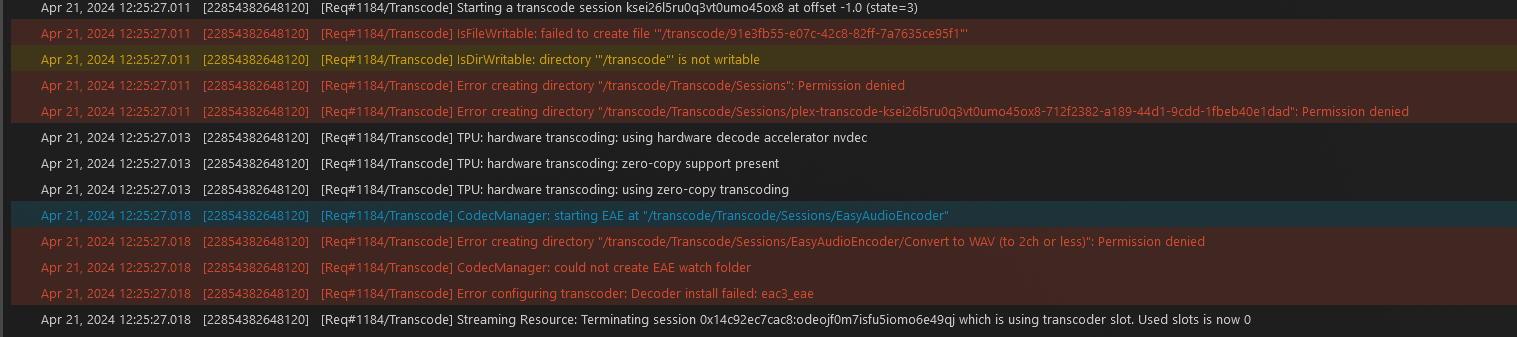

Hello, I need some help.
I am having an issue when I try to play a movie and convert to a lower quality.  I get the "a required codec cannot be found".  There is an error in the logs about the /transcode folder not being writable.
I am not sure what changed to make this not work.  While doing some googling to figure out what folder I need to change permissions I have not found a clear answer.
The bottom variables have me confused as to where the folder is.  Any help would be appreciated.

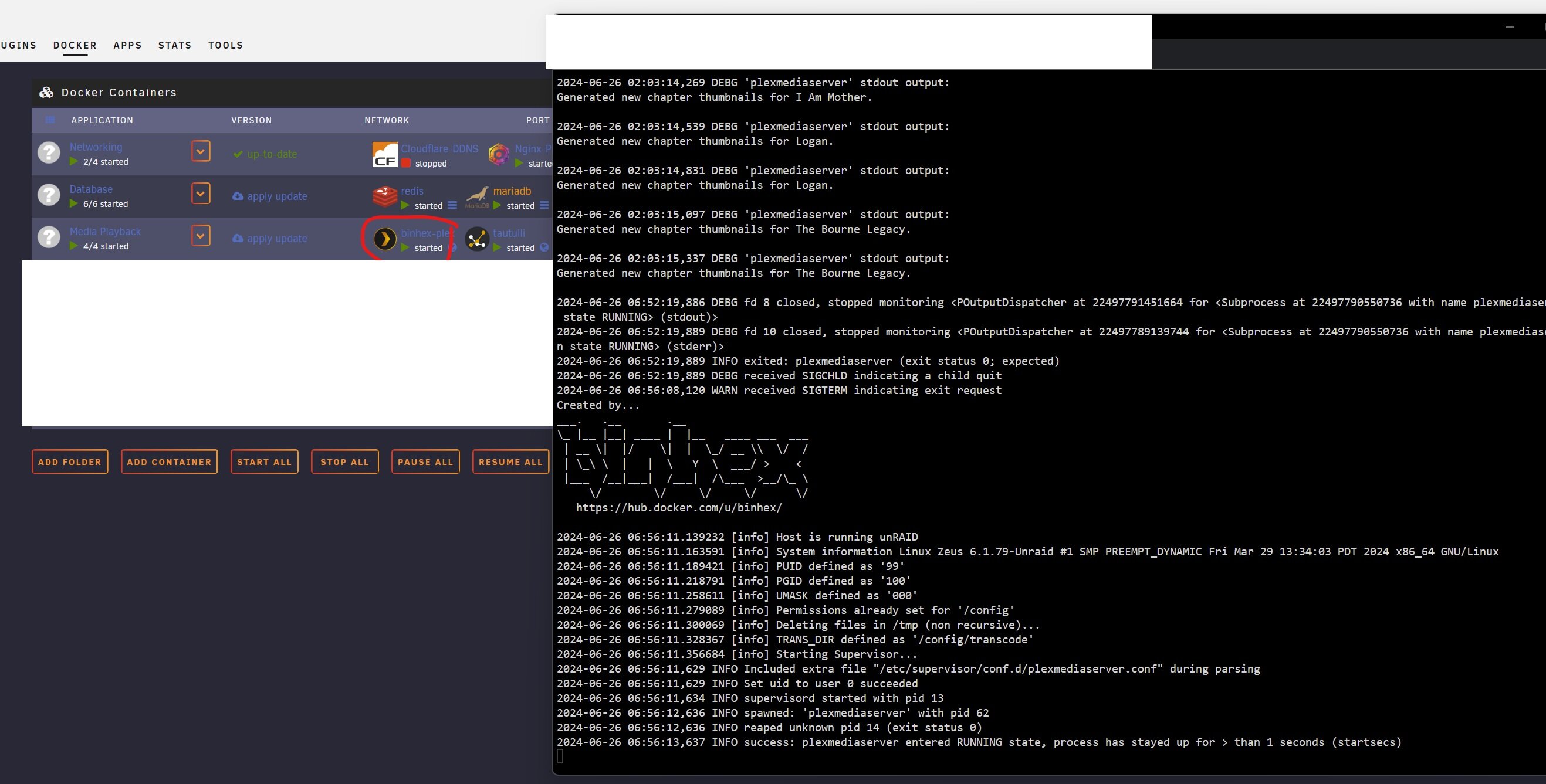

I cannot update my docker container. no matter how many times I try, it does not actually update the plex app..... the update function appears to be working and gives no errors....... please help!
And just like that the container updated but now I can't get to the plex server anymore even though it says it's running........
Edit - welp I guess I had to start over...... i guess it'll take all night to reindex everything......

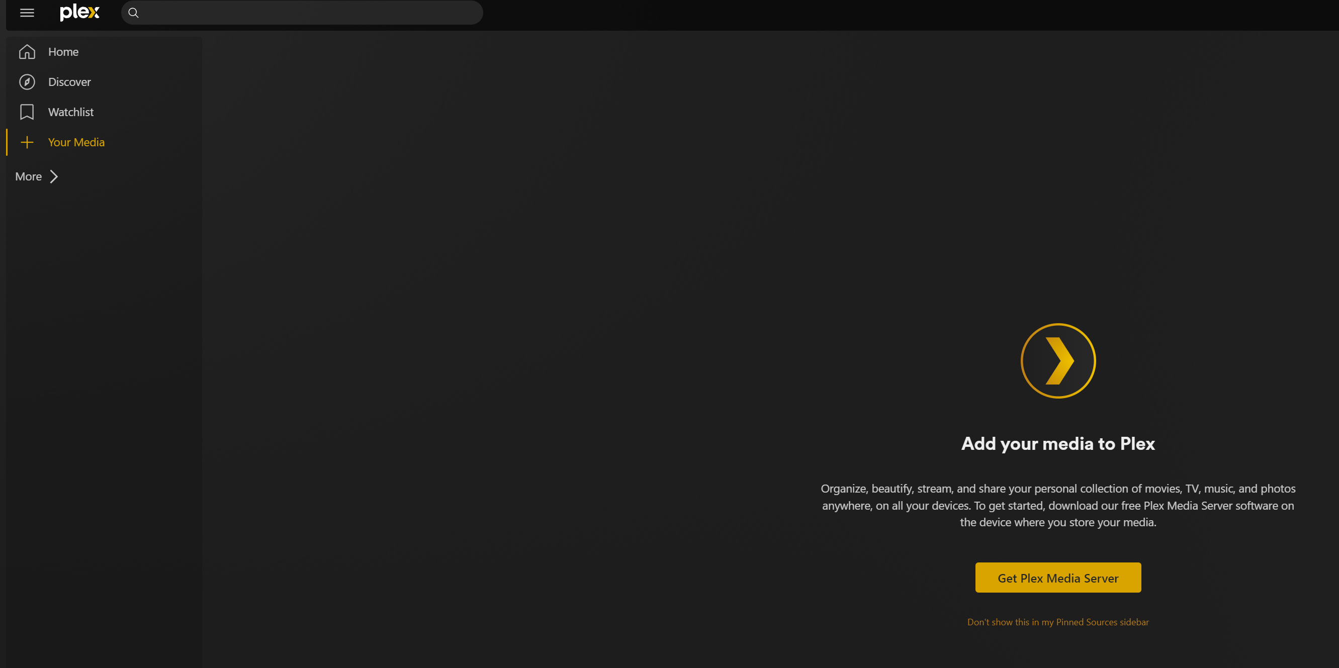

image.png.240cd492ac86b6d5b66840f94fc25bd3.pngLocal GUI is broken again..... wtf is going on? It was rescanning my media library now it's failing again.....
Edited by enkrypt3d

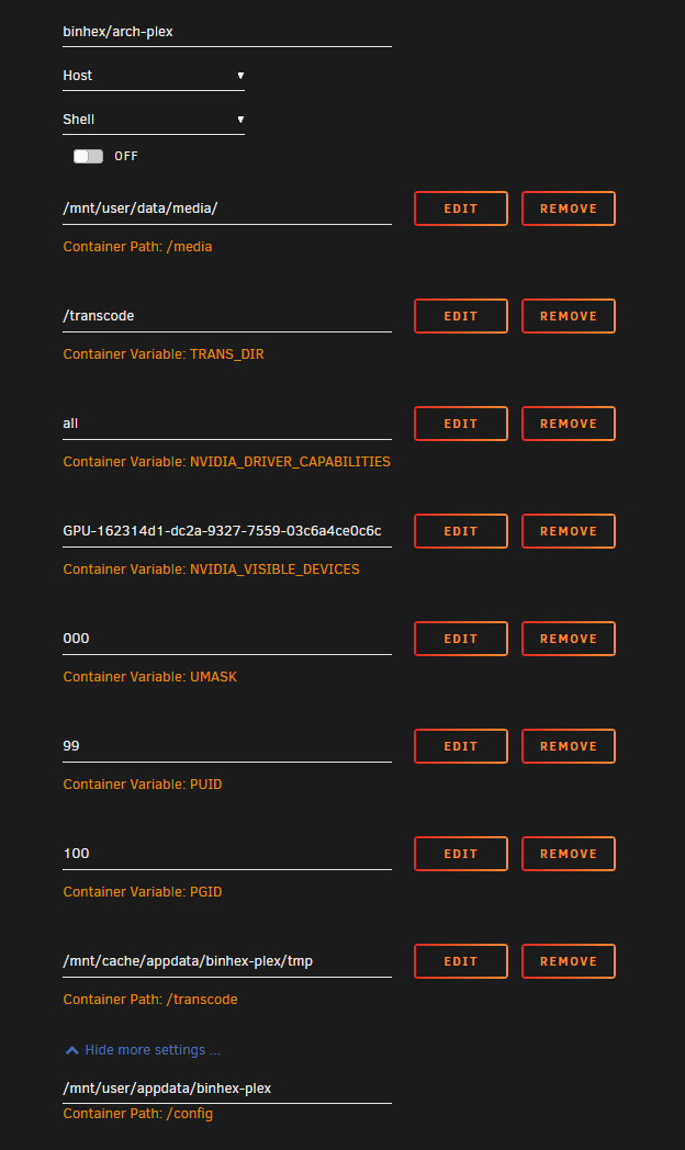

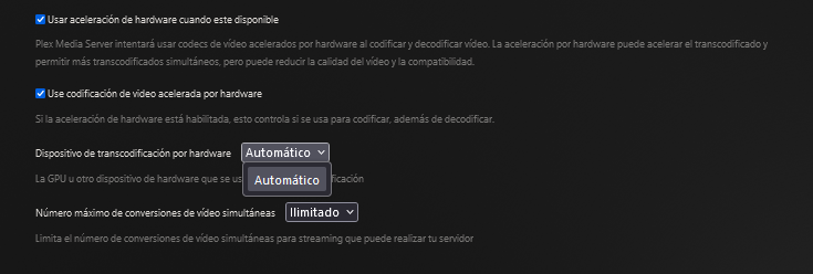

hi, im using plex and nvidia driver, and cant make work nvidia thing to transcode/decode
i tried to add that, not worked
i have plex pass
no option to select any gpu(and on charts of usage gpu is never used)

My plex docker has suddenly stopped working - unable to see media folders.
I've ran a DB repair and it successfully repaired it, but after rebooting it's the same issue.
It's like it seems to think PMS isn't installed/running, but the logs show it is.
