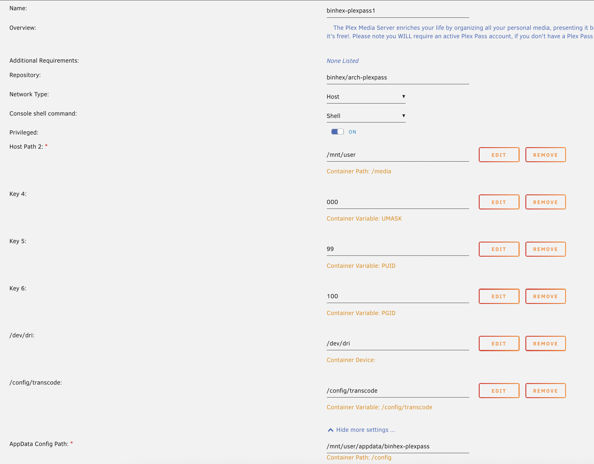

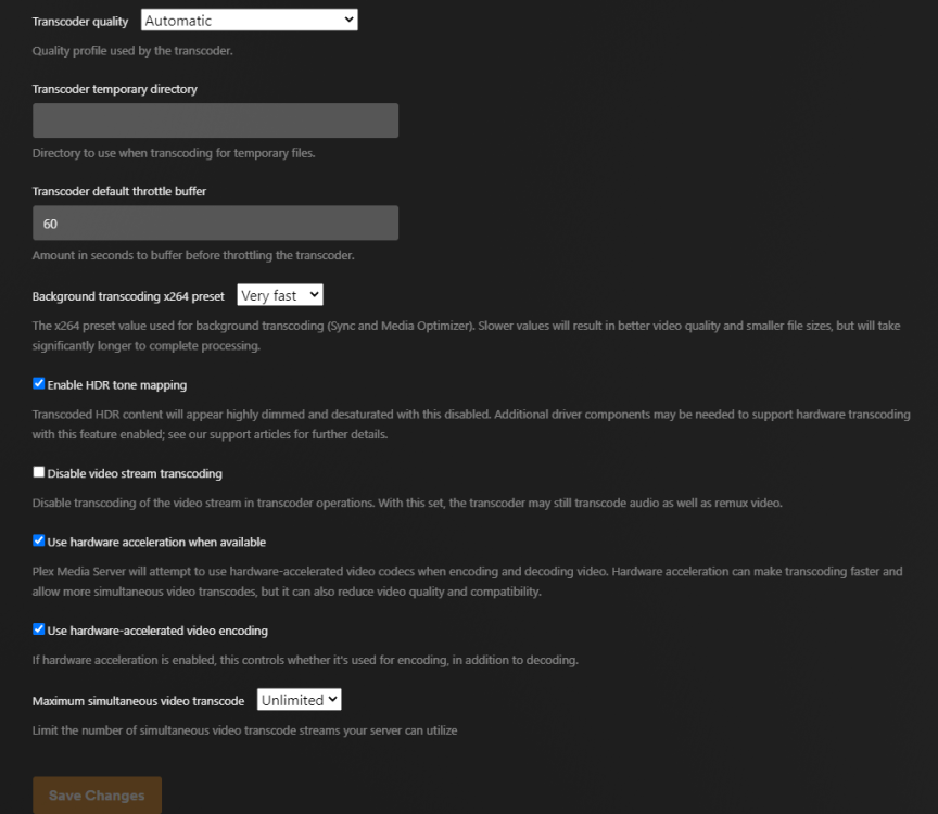

I have had hardware transcoding working for over a year and a few weeks ago it stopped working, I just did a restart and it started working again. Yesterday it stopped working again and I have tried everything to get it up and running. My unraid server has a Nvidia GPU and Intel Quick Sync and I think for some reason Plex is trying to use the NVIDIA GPU even through I have it sert up for quick sync
I do have the extra parameters and new device path set to Quick Sync but my Plex logs have this error in it when I try to transcode
[Req#560d/Transcode] [FFMPEG] - Cannot load libcuda.so.1
[Req#560d/Transcode] [FFMPEG] - Could not dynamically load CUDA
[Req#560d/Transcode] Codecs: hardware transcoding: opening hw device failed - probably not supported by this system, error: Operation not permitted
[Req#560d/Transcode] Could not create hardware context for h264_nvenc
[Req#560d/Transcode] MDE: Cannot direct stream video stream due to profile or setting limitations
[Req#560d/Transcode] Codecs: testing hevc (decoder) with hwdevice vaapi
[Req#560d/Transcode] Codecs: hardware transcoding: testing API vaapi
[Req#560d/Transcode] [FFMPEG] - Failed to initialise VAAPI connection: -1 (unknown libva error).
[Req#560d/Transcode] Codecs: hardware transcoding: opening hw device failed - probably not supported by this system, error: I/O error
[Req#560d/Transcode] Could not create hardware context for hevc
[Req#560d/Transcode] Codecs: testing hevc (decoder) with hwdevice nvdec
[Req#560d/Transcode] Codecs: hardware transcoding: testing API nvdec
any ideas? I am at a loss

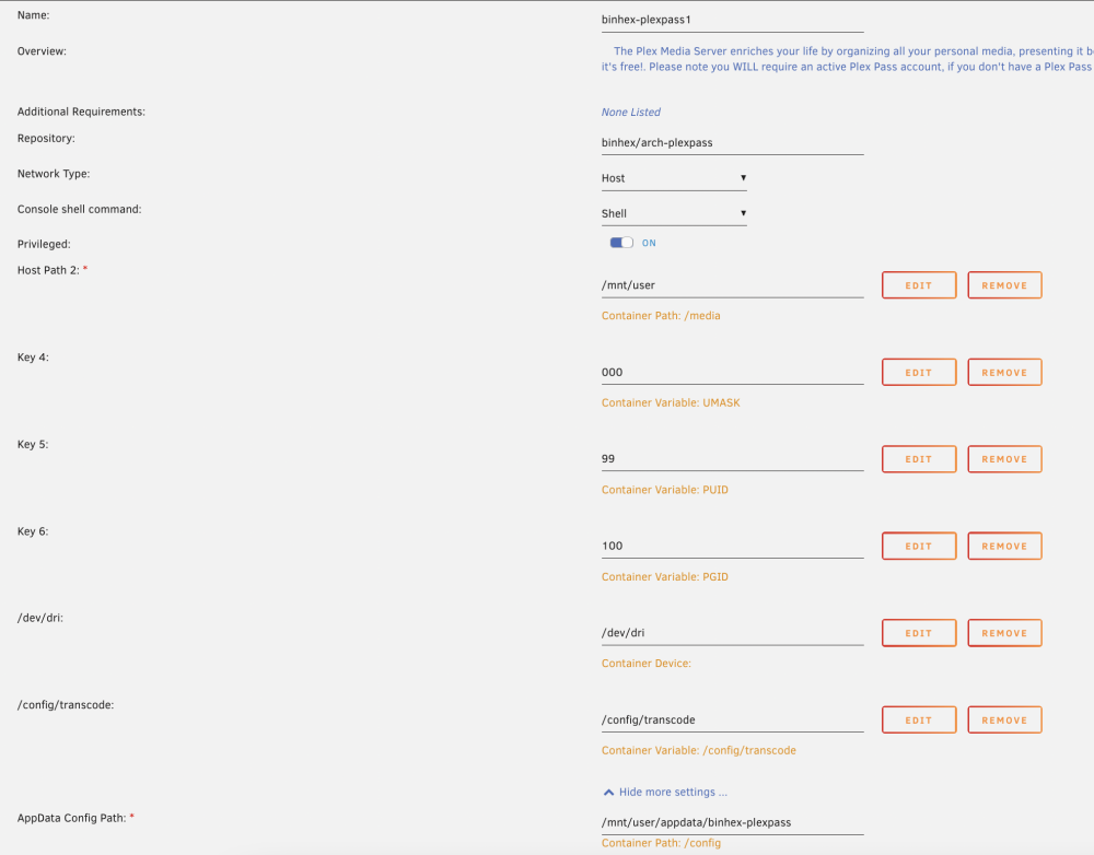

i don't really know what is happening here, my usb drive was corrupted and i took a backup and replace it with new one
then restored all my containers as "reinstall with previous template" , all containers worked well except binhex_plexpass
which gives this log
2023-02-05 22:16:32.171034 [info] Host is running unRAID
2023-02-05 22:16:32.188511 [info] System information Linux Tower 5.19.9-Unraid #1 SMP PREEMPT_DYNAMIC Fri Sep 23 07:24:37 PDT 2022 x86_64 GNU/Linux
2023-02-05 22:16:32.220319 [info] OS_ARCH defined as 'x86-64'
2023-02-05 22:16:32.256263 [info] PUID defined as '99'
2023-02-05 22:16:32.317224 [info] PGID defined as '100'
2023-02-05 22:16:33.064625 [info] UMASK defined as '000'
2023-02-05 22:16:33.094696 [info] Permissions already set for '/config'
2023-02-05 22:16:33.193803 [info] Deleting files in /tmp (non recursive)...
2023-02-05 22:16:33.231642 [warn] TRANS_DIR not defined,(via -e TRANS_DIR), defaulting to '/config/tmp'
tried using
/config/transcod
/config/tmp
but with no avail, attached my current template with i thing is same as before
tried using
/config/transcod
/config/tmp
Solved!
just followed this binhex note:
"This also helps people easily sort out any permissions issues by simply deleting the /config/perms.txt file to force a re-apply of the correct permissions for the container."
i will leave it for others having the same problem

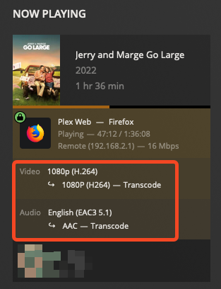

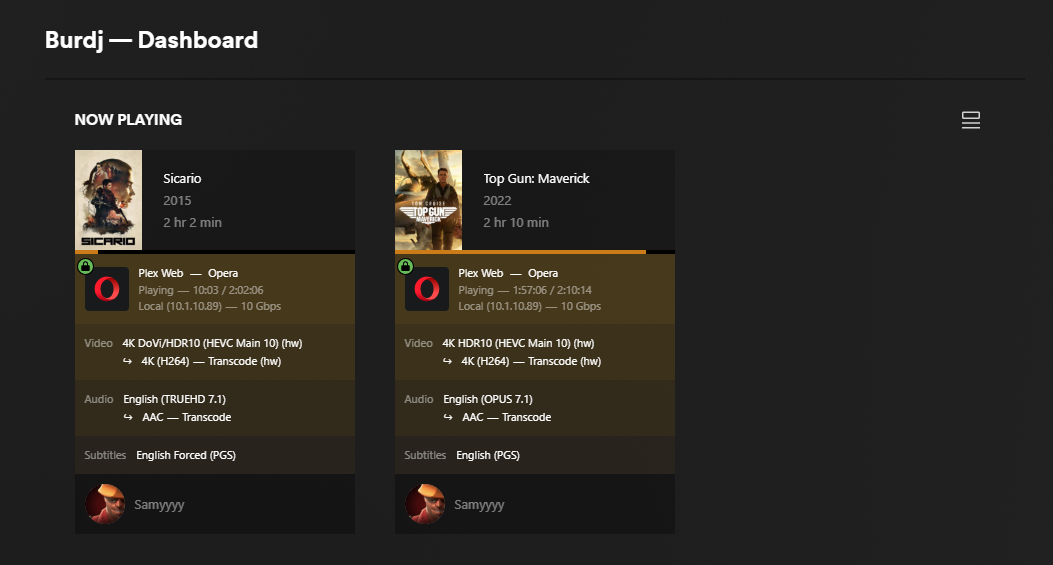

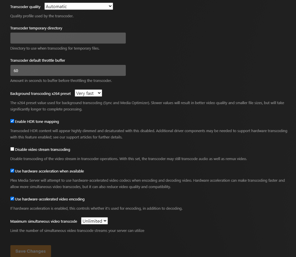

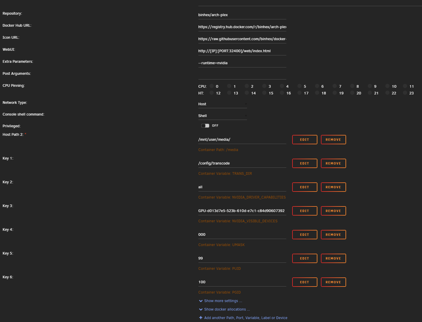

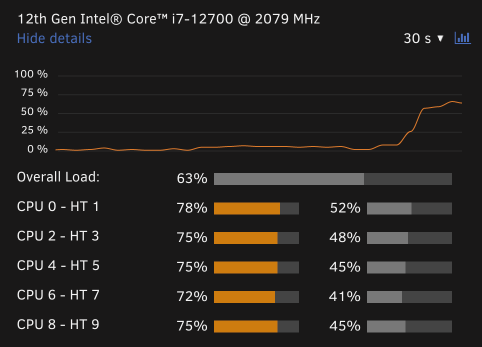

edit: Upon further investigation it seems like if i'm transcoding a 1080P movie, Plex leans on the CPU, but when I transcode a 4K movie, Plex uses the GPU. This is reproducible with any movie i try. Is this expected behaviour in Plex?

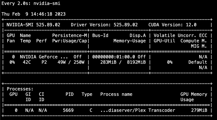

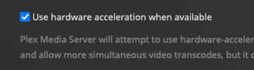

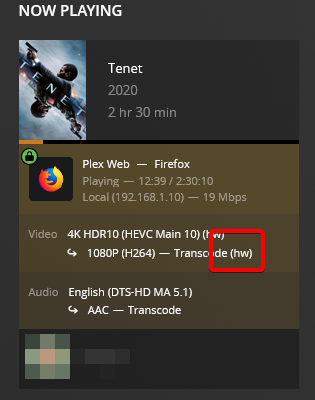

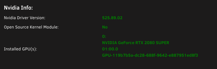

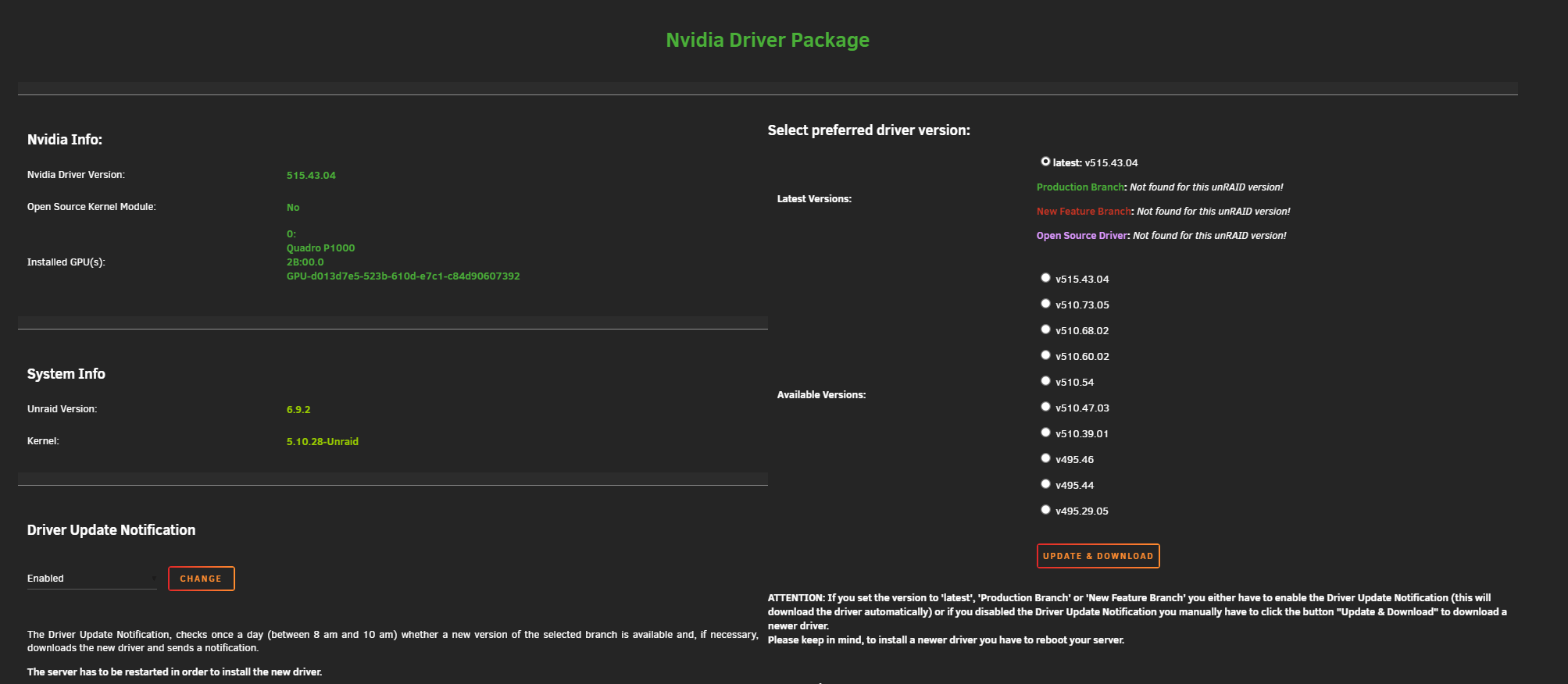

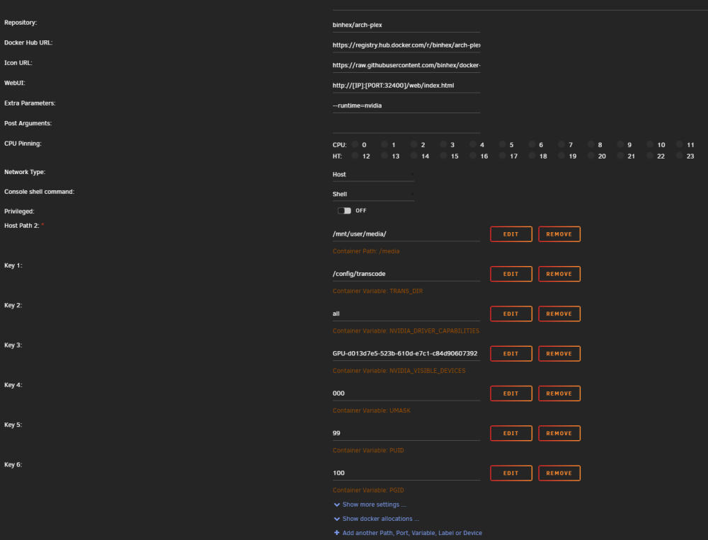

I'm having difficulty getting Plex hardware transcoding to work despite the GPU being detected and used by Plex.
I migrated my Plex %appdata% folder from a Windows VM to Binhex Plexpass and everything worked fine after pointing it to the new media locations and syncing.
- I've installed the 'nvidia driver' plugin and downloaded the latest driver.
- The driver has a HWID.
- I have copied the ID from 'nvidia driver' and pasted it into Binhex Plexpass container settings.
- I have set --runtime=nvidia in 'extra parameters'
- I have set 'nvidia_visible_devices' to 'all'
- I have enabled hardware acceleration under Transcoder settings.

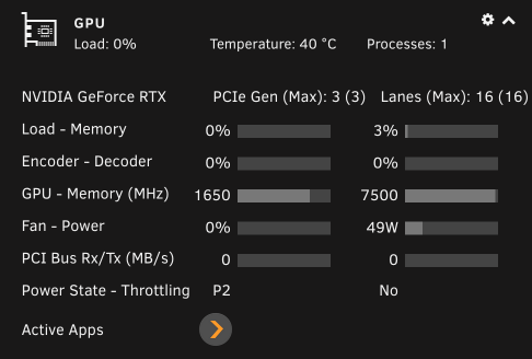

- I have confirmed transcoder temporary directory is working (i can see transcoding files in the directory i have mapped on my cache)
- When i launch Plex the the GPU Statistics plugin shows that my GPU is being utilised by Plex.
- When i launch terminal and type "watch nvidia-smi" i can see the GPU is being used by Plex.
However with all that working properly and looking good, when I watch a movie and set Plex to transcode (rather than direct file stream), my CPU gets slammed and Plex does not show "transcode (hw)" in the now playing section. Instead it just shows "transcode", which means that it's not HW transcoding.
Anyone have an idea? Has this been caused by transferring my Windows based %appdata% folder into Docker? To be clear i took the 'Plex Media Server' folder from Windows in %appdata%, deleted all of the folders in Binhex Plex in /appdata/, and copied it in.
Thanks.

I'm having issues with Plex that I haven't been able to figure out. I have tried to delete the docker image and restore via CA Backup, but the same error occurs. The log says:
2023-03-09 12:08:01.163222 [info] Host is running unRAID
2023-03-09 12:08:01.182556 [info] System information Linux HAL 5.10.28-Unraid #1 SMP Wed Apr 7 08:23:18 PDT 2021 x86_64 GNU/Linux
2023-03-09 12:08:01.205559 [info] OS_ARCH defined as 'x86-64'
2023-03-09 12:08:01.227308 [info] PUID defined as '99'
2023-03-09 12:08:01.253773 [info] PGID defined as '100'
2023-03-09 12:08:01.290781 [info] UMASK defined as '000'
2023-03-09 12:08:01.311204 [info] Permissions already set for '/config'
2023-03-09 12:08:01.336987 [info] Deleting files in /tmp (non recursive)...
2023-03-09 12:08:01.361230 [info] TRANS_DIR defined as '/config/transcode'
2023-03-09 12:08:01.385715 [info] Starting Supervisor...
2023-03-09 12:08:01,726 INFO Included extra file "/etc/supervisor/conf.d/plexmediaserver.conf" during parsing
2023-03-09 12:08:01,726 INFO Set uid to user 0 succeeded
2023-03-09 12:08:01,728 INFO supervisord started with pid 8
2023-03-09 12:08:02,730 INFO spawned: 'plexmediaserver' with pid 65
2023-03-09 12:08:02,731 INFO reaped unknown pid 9 (exit status 0)
2023-03-09 12:08:03,732 INFO success: plexmediaserver entered RUNNING state, process has stayed up for > than 1 seconds (startsecs)
2023-03-09 12:08:18,157 DEBG 'plexmediaserver' stdout output:
Critical: libusb_init failed
I tried googling the critical error, but it just said something about USB tuners which I'm not quite sure what is. Plex is showing everything, but all the thumbnails are black and when I'm trying to play anything it just says playback error. Any ideas?
Hello,
After using Binhex plex for many years now, I've upgraded the setup to offload transcoding to a GPU (NVIDIA P1000), I've followed space invader tutorial on it but even though my GPU seems to be doing the transcoding, my CPU still works at the same rate as before and I'm still not able to transcode to 4k smoothly as my GPU should. Do you guys know why my CPU is still working this hard even though it should be the GPU doing it ?
Here's some pictures for more info (Was playing two movies transcoded in the time so you can have a better idea)
Can you please help ? Thank you very much !
EDIT: I have the exact same issue as LumpyCustard above apparently, I've seen the same behavior between binhex-plex and binhex-plexpass, and it's not a migration issue as I have this setup since day 1 and there was no transfer no anything. I even tried with a brand new docker install and I had the same behavior ... Please help if you have an idea
Edited by Samy

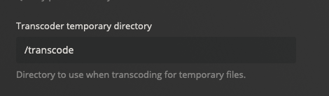

Thanks.
You have the same issue as me above, I've found out that disabling subtitles solves the issue, now we need to understand how to get how to watch with subtitles and have everything go through the GPU as well......
EDIT: Putting SRT subtitles also work... Don't ask me why, I don't know. Hopefully someone will help us diagnose the issue, probably a docker issue ?
Edited by Samy
