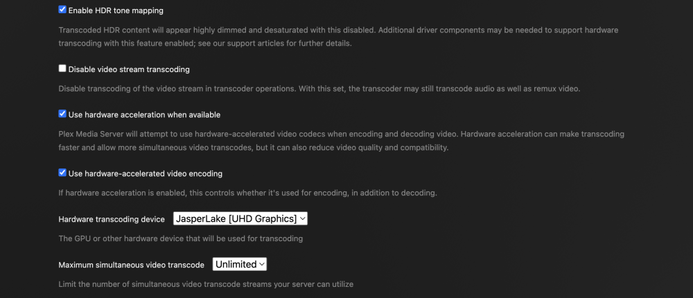

I am having trouble hardware transcoding, I just bought a plex pass and am not sure what I am doing wrong.
Edited by CopesaCola
clarity
Dual-Core N4505 Processor

22 minutes ago, CopesaCola said:
I'm pretty sure it's Intel, I'm running a TerraMaster F2-223 if that helps
not gone through this as i have a discrete nvidia card, but this looks like it should guide you through it:-
This was it for the most part, however there's a known issue with some GPUs that won't allow you to hw transcode if HDR tonemapping is on. After I unchecked that, it was smooth sailing.
Thanks again!

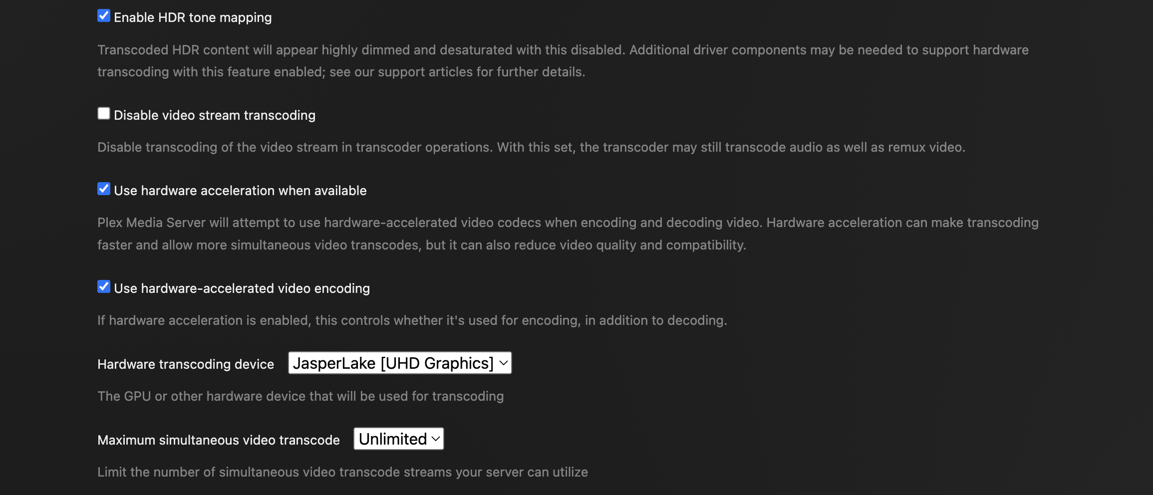

I can help here, I have a F4-223. I found this tidbit of information on Reddit:
To enable Intel Quicksync on Terramaster, open terminal and paste the following command:
echo "options i915 enable_guc=3" > /boot/config/modprobe.d/i915.conf
Exit terminal and then reboot the server.
Do this, then add the usual config line into Plex docker and it should work. It did for me.

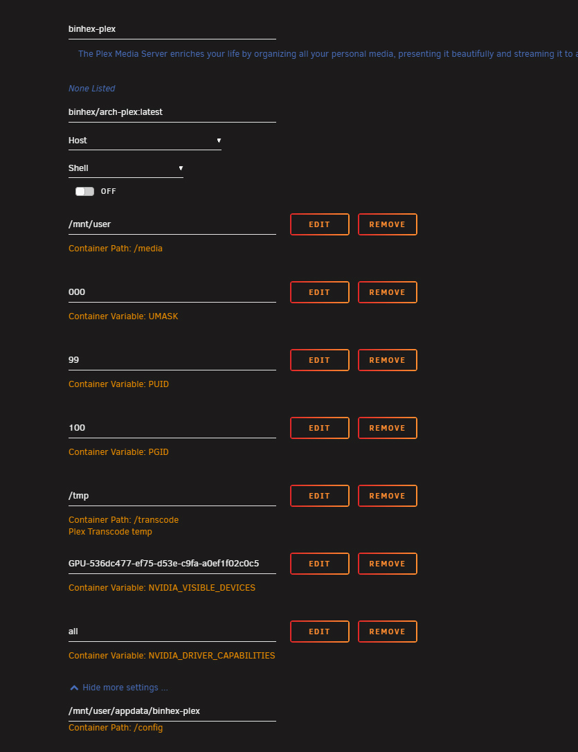

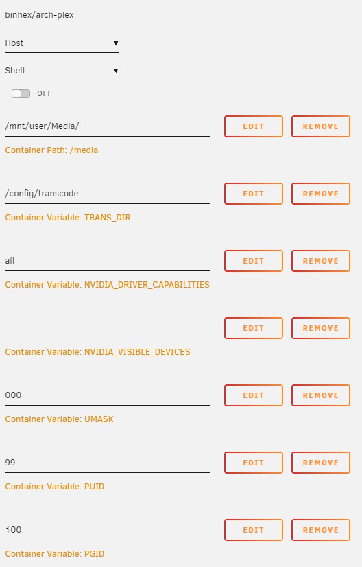

Hi all,
I'm having a really strange problem with plex transcoding using an NVIDIA GPU on my unraid server. I've setup all the required variables for plex to see the nvidia GPU and it works 100% of the time using the mobile app and asking plex to convert. Using nvidia-smi I can see the transcode running on the GPU. This problem only seems to affect media transcoding in a web browser or the plex windows app. Windows app shows: An unknown error occurred (4294967279) when trying to force a lower quality transcode.
Unraid server: 6.12.8
Latest Binhex-plex app
i5-3570K CPU
16Gb ram
NVIDIA 1050Ti 4Gb
So I'm running lower end hardware which I will likely upgrade in the future, shifting the transcoding to my GPU to save my CPU for other tasks. Do you think I'm having problems due to the 1050ti capabilities? Is there any logs I can check to see why the transcode is not working? When this happens I see the process in nvidia-smi then it quickly disappears and the media is not transcoded but watching in the mobile app the transcode keeps running.
I tested the same thing in Jellyfin and everything works 100% there. Only difference I see between the two is nvidia-smi for plex shows:
