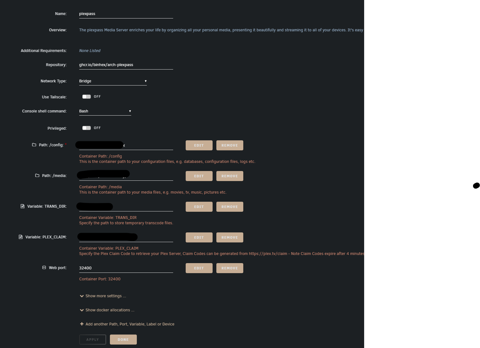

Hello all, I've moved my plex library to unraid and am trying to claim my server. I'm unable to access the web UI
I've attached the docker logs and the "Plex Media Server.log"
It's showing some 401 errors accessing plex.tv. Please let me know if I should upload anything else, thank you.
docker-logs.txt plex-media-server.log
Never mind, a new claim token worked, solved.

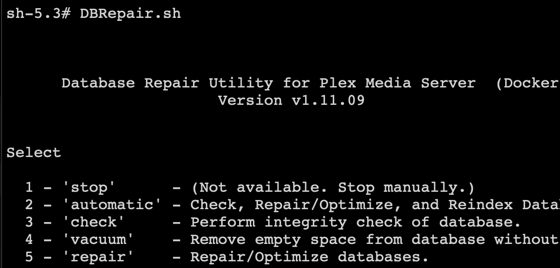

Well, no clue what I've done to fix it. But after twenty attempts or so it finally just worked. Solved.
I'm unable to run DBRepair.sh without forcing the PMS media server to stop manually. The script doesn't seem able to do it for me. Any ideas?

so i started it looks likes this
DBRepair.sh
Database Repair Utility for Plex Media Server (BINHEX)
Version v1.11.09
Select
1 - 'stop' - Stop PMS.
2 - 'automatic' - Check, Repair/Optimize, and Reindex Database in one step.
3 - 'check' - Perform integrity check of database.
4 - 'vacuum' - Remove empty space from database without optimizing.
5 - 'repair' - Repair/Optimize databases.
6 - 'reindex' - Rebuild database indexes.
7 - 'start' - Start PMS
8 - 'import' - Import watch history from another database independent of Plex. (risky).
9 - 'replace' - Replace current databases with newest usable backup copy (interactive).
10 - 'show' - Show logfile.
11 - 'status' - Report status of PMS (run-state and databases).
12 - 'undo' - Undo last successful command.
21 - 'prune' - Remove old image files (jpeg,jpg,png) from PhotoTranscoder cache & all temp files left by PMS.
42 - 'ignore' - Ignore duplicate/constraint errors.
88 - 'update' - Check for updates.
98 - 'quit' - Quit immediately. Keep all temporary files.
99 - 'exit' - Exit with cleanup options.
Enter command # -or- command name (4 char min) : 1
Stopping PMS.
Stopped PMS.
Select
Enter command # -or- command name (4 char min) : 2
Automatic Check,Repair,Index started.
Checking the PMS databases
you said it will take for ever my db is about 128gb. do i have to keep the window open the whole time. Are we talking over night days lol just curious.
