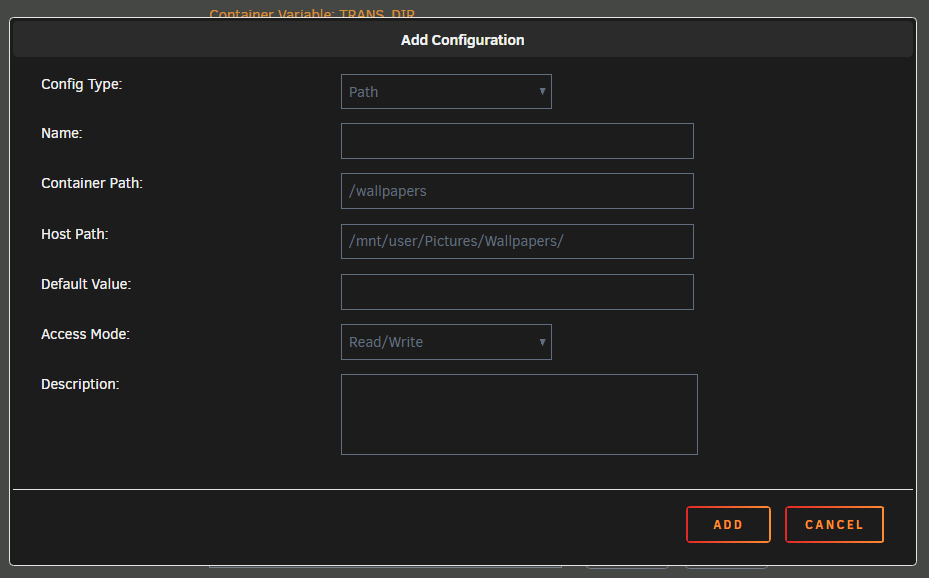

Is it possible to add an additional "/media" path to include another pool? I'd like to point my DVR/LiveTV to an NVMe drive vs my RAIDZ3 pool which causes stuttering until I rewind after 10 seconds and it's replaying what's already recorded to the pool.
4 hours ago, impenetrable-aviator2287 said:
Hello,
 sure, you can add as many paths as you want, just click edit and go to the botton click on add and add a new path then set the host path to point at the pool and give the container path a unique name and lastly point plex at the uniqe container path and add your media.
I did exactly this, entered a new path the way you described. When hitting APPLY the docker image disappeared completely. It is not visible over the DOCKER view in unraid, nor over the DASHBOARD view. Calling the /manage adress leads to errors.
The docker image was working perfectly fine. How do i recover it? Using the ADD option and entering a new media path is all i changed. I don't have any idea how to undo the change and make the docker work again. Any help would be kindly appreciated.
Thank you.

On 4/12/2025 at 3:11 PM, Gekko said:
This way plex is working again, but there seems to be no way to add an additional media path to plex with the information provided. There should be at least a working example provided to prevent misinterpretations.
Documenting every possible eventuality that a user may do is not possible, sorry about that.
Here is what it should look like, in this example i have added a new root folder for the container called 'wallpapers' which points at a sub folder of pictures on the array:-
Feel free to 'Name' it if you wish and put a 'Description' too if you like (both optional), click ADD then click APPLY at the bottom of the screen to recreate the container. Once done go to Plex Web UI and add the folder, remembering to reference the container path not the host path, so add /wallpapers (in my example).
