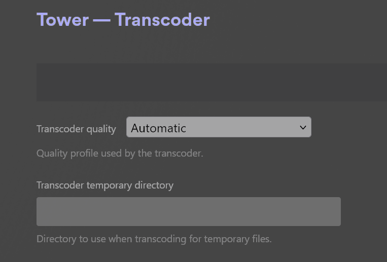

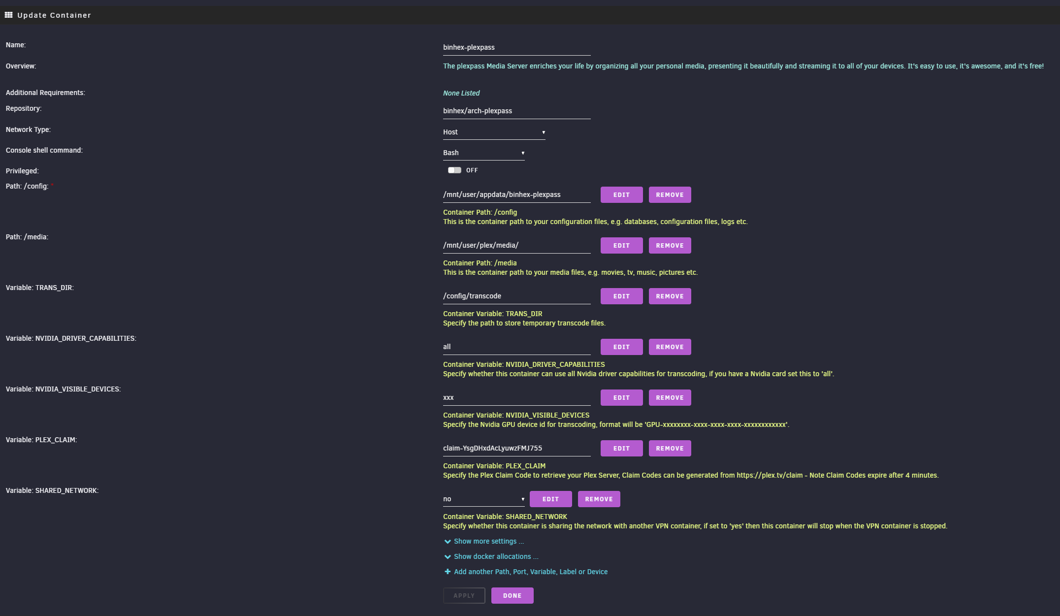

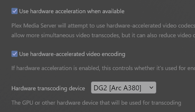

13 hours ago, dustinyo said:
Edit: I think I found the info I needed actually https://github.com/binhex/documentation/blob/master/docker/faq/plex.md
Edit 2: Ok, well I'm still having issues here, so specifically, I cannot get Plex to use my Arc A380 to transcode. I've passed /dev/dri as a device, I'm on the beta UnRaid 7.0 release, and I have the latest Intel GPU TOP installed (from 6/27). Plex settings show the 380 as an option to transcode, but it just will not use it when I actually transcode. Does this work with Intel Arc?
This is possibly a very dumb question, and it may have already been answered before so I apologize in advance.
For the transcode folder, the Docker config has it as a variable rather than a path. So would this mean I do not need to specify a temporary transcode folder in the Plex transcoder settings? Should I leave this blank or should I fill it in with /config/transcode to match the Docker config?
 Inserted dev/dri/RenderD129 instead of dev/dri/   . This enabled the 380. However many files crashed Plex. I could see 380 rendering on the dashboard. Im a bit lost why it crashes

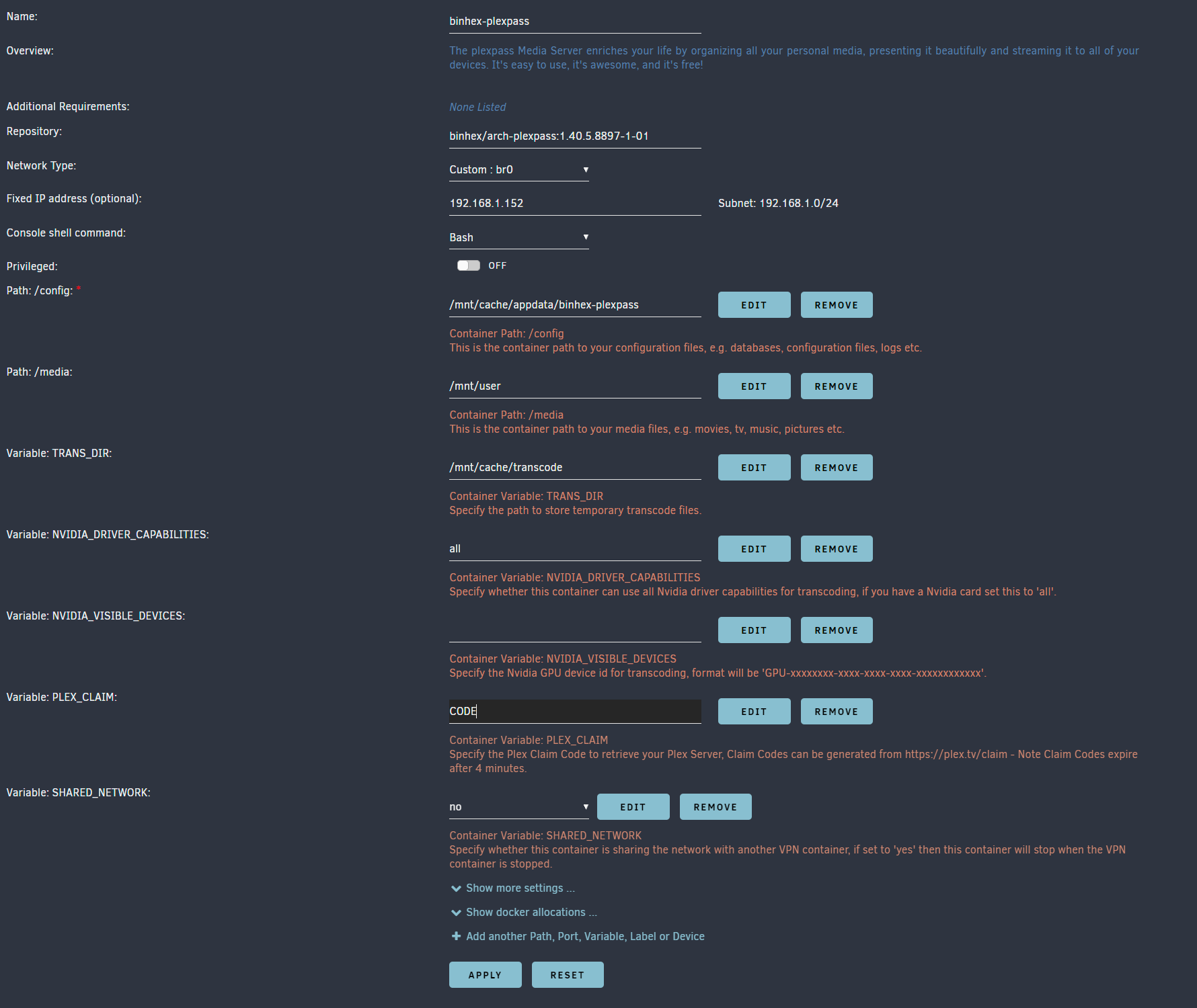

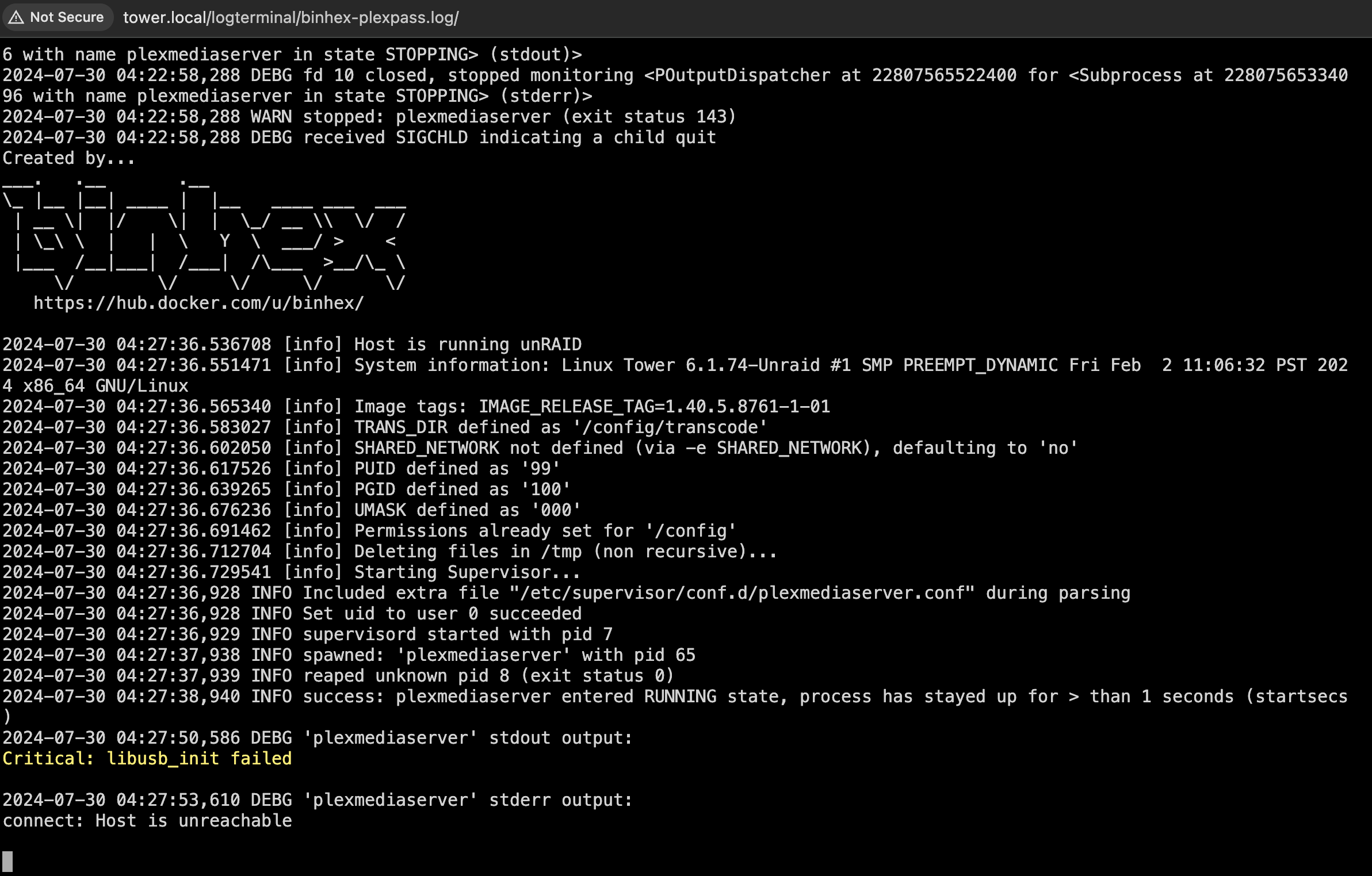

Hey Friends,
I hope this is the correct place to post this.  I've been using the binhex-plexpass docker container for about 9 months with zero problems.  Everything was working great Monday afternoon and then Monday evening, I was unable to access my libraries on my client.  I logged into unraid and saw I had a warning that my cache was almost full, followed by a notification that my cache had returned to a normal state after files were moved to the array.
When I opened the binhex-plexpass WebUI, it said my server could not be found.  I tried restarting the container.  Nothing.  I tried rebooting the server, Nothing.  At some point during this I read that if the cache got too full, there's a chance that my database was corrupted.  I didn't think this was a big deal, it wouldn't take me very long to rebuild my Plex Metadata.  I deleted the binhex-plexpass docker container and image as well as the appdata folder.  I reinstalled and set up the libraries in the WebUI again; however, now I'm getting a strange message that it won't let me "Claim" the server and keeps insisting that an update is available and to "please install manually."  Clicking the "Claim Server" button just sends it spinning.
I've been troubleshooting this for the last 8hours.  I read at one point that I could manually add the Claim token to the docker container by adding a variable with PLEX_CLAIM and then entering the claim-******.  Strangely, I am unable to connect to plex.tv/claim from my home network.  If I turn my VPN on, it let's me connect to plex.tv/claim and similarly if I turn the wifi off on my phone, I'm able to connect to the website.  Unfortunately the claim token that both of those places are creating don't seem to do anything when I add them in the new variable in the docker container.
I logged into my router gateway and ensured that port 32400 is still open for TCP/UDP.  I've tried uninstalling the binhex-plexpass container and tried the binhex-plex container, as well as the Official Plex container as well as the apps offered by the linuxserver repository and the horito repository.  They all present the same issue.
I just rebooted the server and have attached the logs here as well as a screenshot of the log from binhex-plexpass.
I'm also going to attach the link to the reddit thread I started Monday evening with everything that's been suggested and that I've tried.

I happened to get this too, and the only solution to me was to remove the old config and start over. This means setting up Plex again. Shouldn't really be a problem, just a bit annoying.
As a side note: I happened to experience this because I decided to dedicate my GPU to a VM instead of giving Plex access to it. Once I removed my GPU from the Container settings I guess it broke something.
Here's what I did to fix it:
1. Stop the container if it is running.
2. Check the container settings to see where your config files are located. The default should be:
/mnt/user/appdata/binhex-plexpass
And make sure you take note of other fields you have changed, such as the media location. You might want to keep this identical when creating a new container.
3. use the console and execute:
mv /mnt/user/appdata/binhex-plexpass /mnt/user/appdata/binhex-plexpass-bkup
to "remove" the config folder. We keep a backup just in case.
4. Removed the docker container (no need to delete the image).
5. Add the container again and update your config-fields. I do not use a GPU, so my config looks like this:
6. Once the container is ready, go to the webui and append /manage to the url:
http://192.168.10.168:32400/manage
7. You can now add your media and Plex should be good to go.
