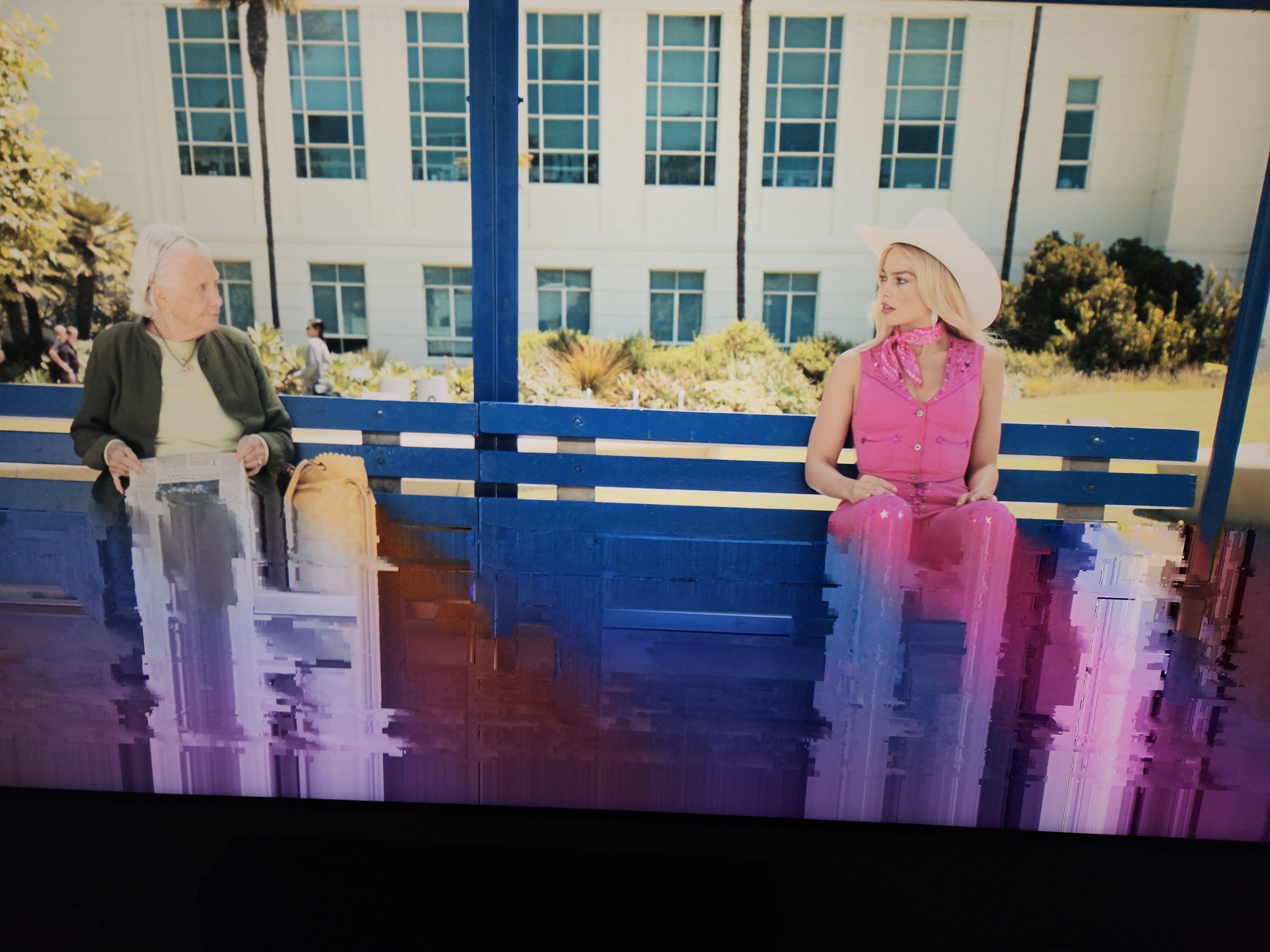

Whenever I use hardware transcoding in Plex, I get horrible artifacting that appears about every 5 seconds that looks like this: 20231228_172731.thumb.jpg.337979791af7ae4e46584f8edbdd6e1c.jpg
I do not get this issue when using software transcoding, but only when hw transcoding using Intel QuickSync on my i7-8700K.
I have tested this on both h.264 and h.265 files with and without hdr and I get the same issue on both. I have also tested this on multiple devices and still get the same issue. For reference, I'm using the latest versions of Unraid and binhex-plexpass. Any help would be appreciated.

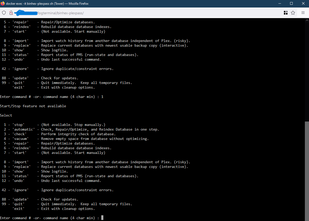

confused with regards to plex DBRepair.sh
no media library is working after an update, hoping this script will correct it
i clicked into the container's console and navigated to running the script, but it needs the container to be manually stopped before it can do anything, which then just closes the console window
i tried navigating through unraid's console to the same place, but the script won't run outside of the container
not entirely sure what it's asking for...
grateful for advice

1 hour ago, binhex said:
no it doesn't, the script will shutdown plex.
yeah that's what it should do, but when i tell it to, it says it needs to be done manually. so i'm not sure how it can be done
can you paste the exact message you are seeing, this should not be the case.

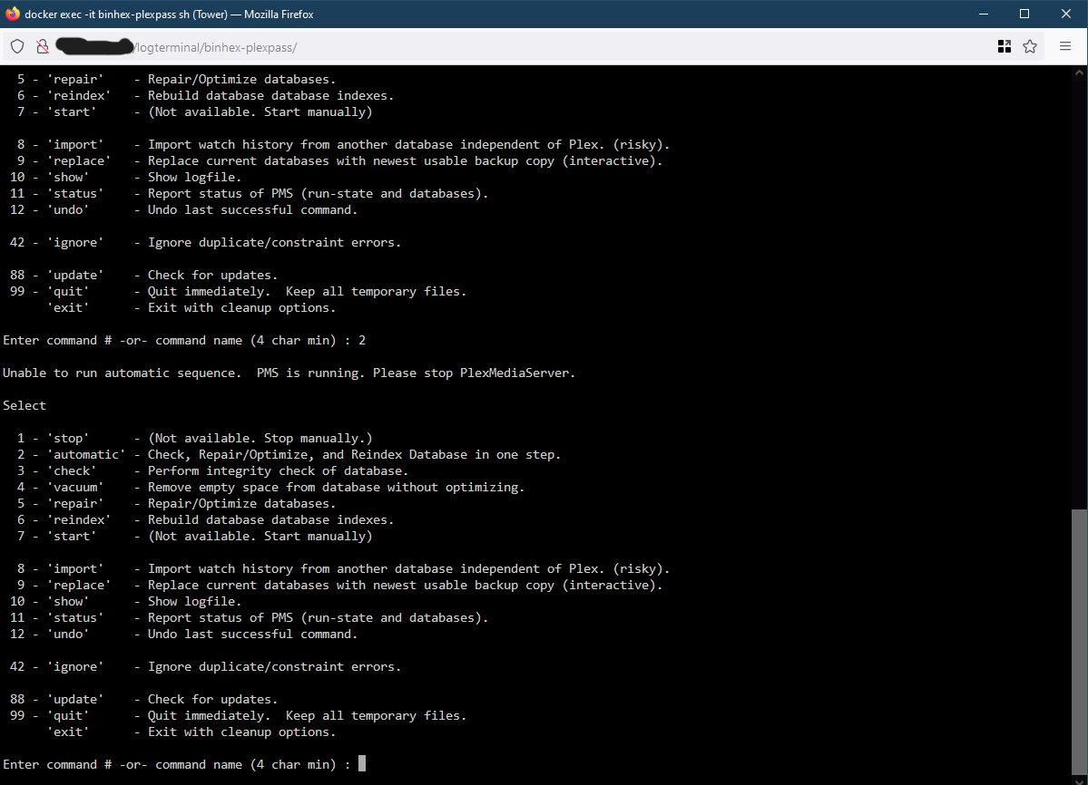

just an attempt to either run the Stop command and then the Auto command which confirmed the need for PMS to be stopped
as you can see it says (Not available. Stop manually)1610522522_Screenshot2024-01-0119_35_34.thumb.png.49d84f61288d23fcae74067b2918d294.png
25 minutes ago, binhex said:
ah that isn't my script :-), if you want to try my script then follow the instructions here, this will stop plex for you:- https://forums.unraid.net/topic/44142-support-binhex-plex-pass/?do=findComment&comment=1286021

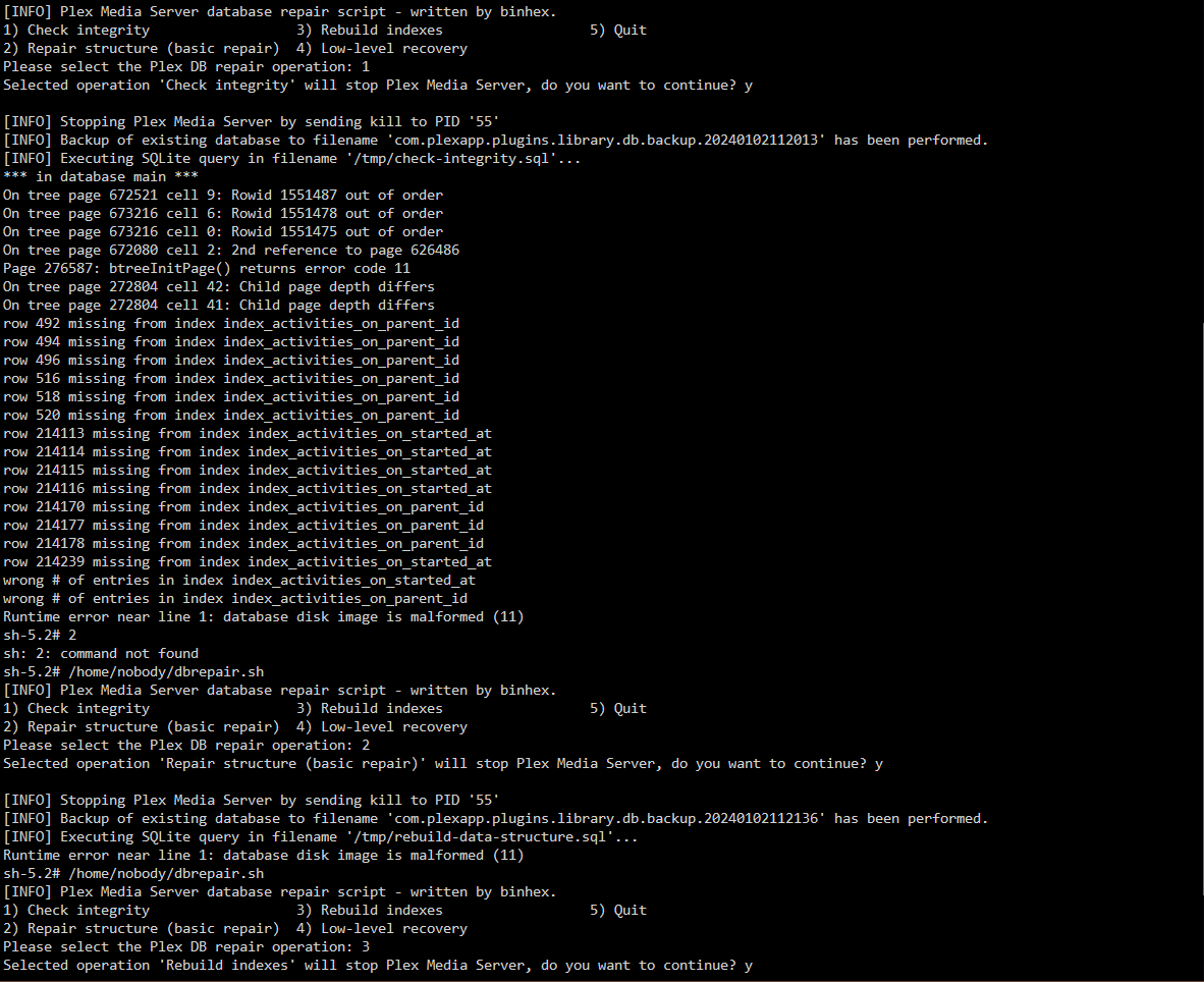

thanks for that, i didn't realise that was the script itself. i ran options 1, then 2, then 3 as i thought the error message was suggesting it was necessary but even after 3 to rebuild indexes, it still says runtime error near line 1: database disk image is malformed. i have already deleted the docker container with image and reinstalled, how else do i proceed?
that depends on what you want to achieve, keep in mind both options below will result in some/all loss of metadata (not media):-
  • if you want a completely clean install then stop the container and rename the /config host folder to something else then start the container, this will then create a brand new installation from scratch.
  • if you want to try to remove just the corrupt database and possibly then allow you to retain certain configuration then stop the container and then rename the file /config/Plex Media Server/Plug-in Support/Databases/com.plexapp.plugins.library.db to something like com.plexapp.plugins.library.db.old then start the container, some reconfiguration will be required.
just to follow up, i did the latter and am currently rebuilding my libraries. thanks to PMM it speeds it up, but still. gives an opportunity for restructure too, i guess.
a shame that the statistics on tautulli have been decimated too, but oh well.
i guess it's related, but the issue i was having with Plex not being able to add items to the play queue, and therefore unable to play, seems to have stopped, so that must have been an issue with that library, which then potentially corrupted the whole database
