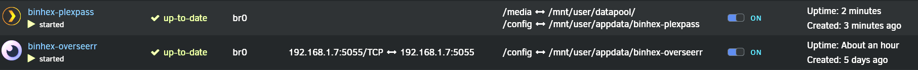

Not a huge deal but br0 ip/port is not showing up on the docker list for some reason. Other containres seem fine.

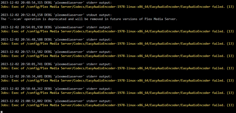

Hi - checking my logs for the first time in a long time and I see the below repeating failure many times a second (17) while the client is streaming (locally). The weird thing is I have absolutely no problem streaming from this client and plex behaves normally from it.
Is this normal behavior?
Thanks
Using the plexpass docker.
Sep 28, 2023 21:53:54.839 [22448818817848] DEBUG - Failed to stream media, client probably disconnected after 7471104 bytes: 104 - Connection reset by peer
Sep 28, 2023 21:53:54.839 [22448818817848] DEBUG - Completed after connection close: [192.168.2.133:33220] 206 GET /library/parts/266219/1695938485/file.mp4?autoAdjustQuality=0&hasMDE=1&location=lan&mediaBufferSize=74944 (6 live) #30769 TLS 127ms 7471104 bytes (pipelined: 1) (range: bytes=186750843-)
Sep 28, 2023 21:53:54.890 [22448670272312] DEBUG - Request: [192.168.2.133:33222 (Allowed Network (Subnet))] GET /library/parts/266219/1695938485/file.mp4?autoAdjustQuality=0&hasMDE=1&location=lan&mediaBufferSize=74944 (6 live) #3076b TLS Signed-in Token (xxx) (FireTV 4K Max) (range: bytes=542961712-)
Sep 28, 2023 21:53:54.891 [22448670272312] DEBUG - Content-Length of /media/tv/xxx - S08E08 - Episode 8 SDTV.mp4 is 138505255 (of total: 681466967).
Sep 28, 2023 21:53:55.023 [22448820927288] DEBUG - Failed to stream media, client probably disconnected after 8110080 bytes: 104 - Connection reset by peer

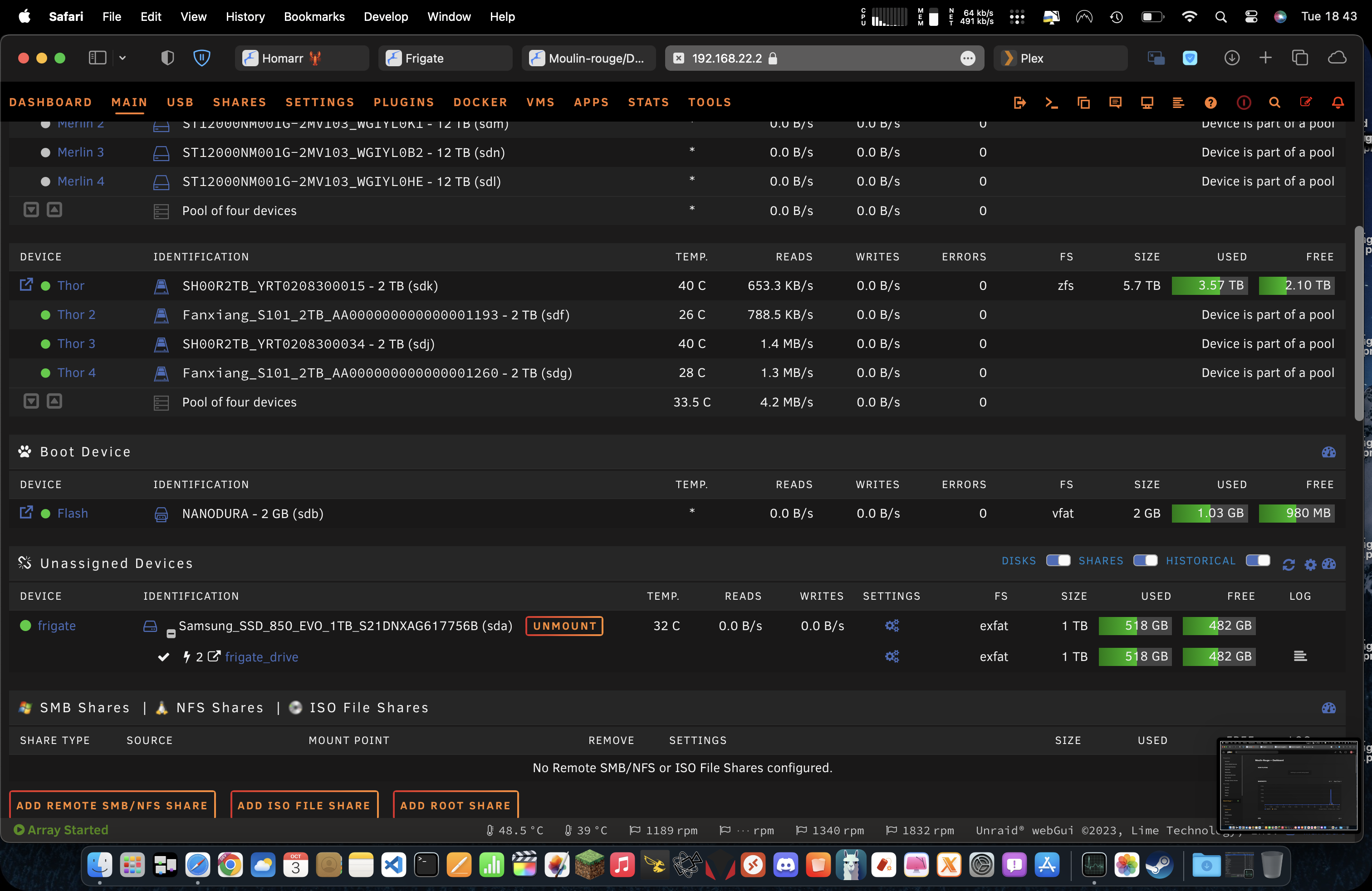

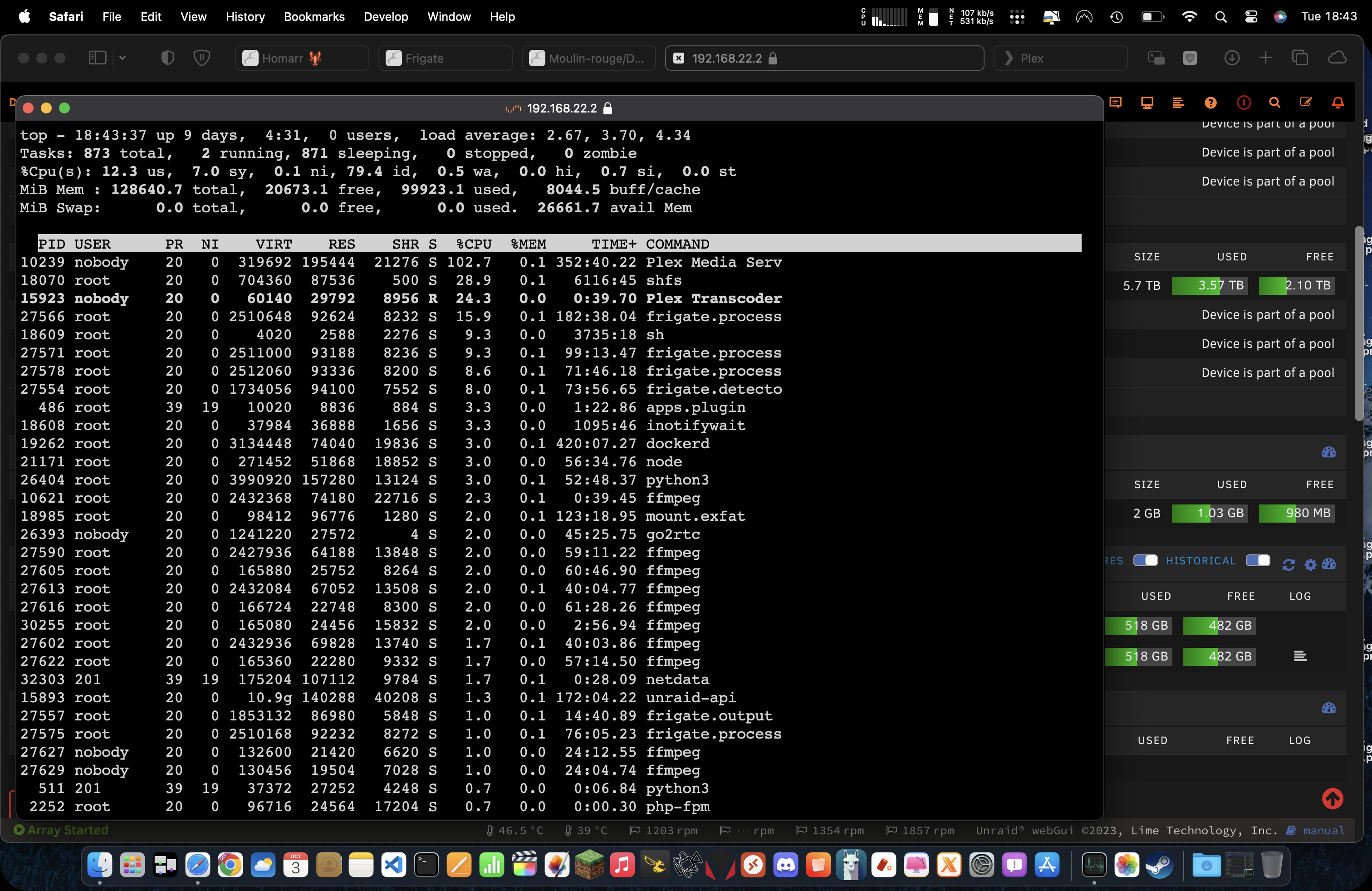

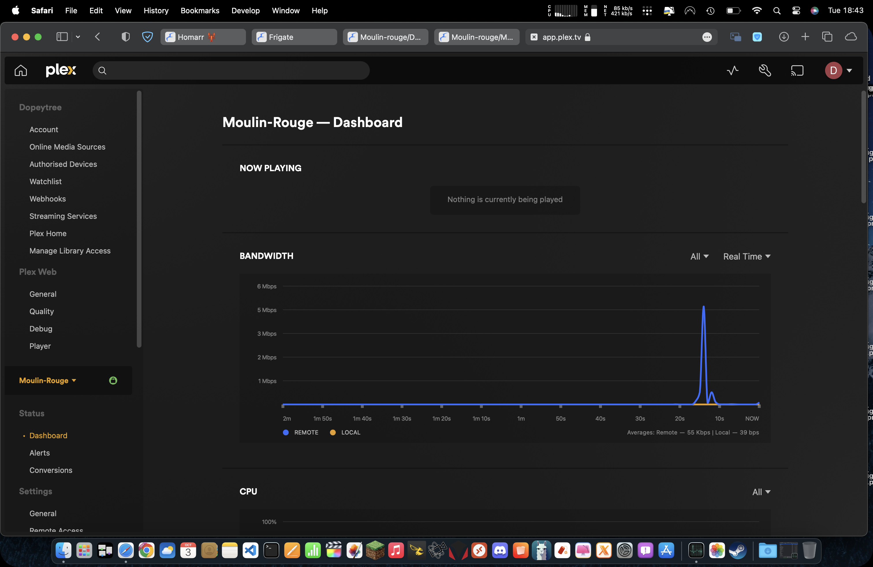

Had something slightly odd just happening.. plex was accessing the disk but not showing as doing anything yet 'TOP' showed it as transcoding. It's been happening for a few days anyone else getting this? Also the console is just empty...
Disks being accessed (Thor)

Top showing plex using high CPU
586550152_Screenshot2023-10-03at18_43_37.thumb.png.ebb966317a46a93c8397571474f1f914.png
Plex saying it's not doing anything..
435591002_Screenshot2023-10-03at18_43_25.thumb.png.4c8ca52fe9fb288bf10e1c46b5404683.png

I am still having issues running PLEX on my server. When I run PLEX the server goes unresponsive after about an hour. The only way to recover is to do a hard reboot. There is nothing shown in the unraid error log and BIOS is current. I have ran memtest with no errors and the intel diagnostic utility with no errors. I am out of ideas.
Heya,
I'm getting some weird slow reads on single disks. Not sure exactly what the cause is.
Open files shows some kind of slow scan happing (5.5MB/s) on open recent-ish tv shows.
It's not plex doing content creation like thumbnails as that hammers the cpu.
It's not someone watching the shows as I mostly watch new stuff which is on the SSD. Plus I can see what everyone is watching.
I think its related to binhex-plex or bind-sonarr
Is anyone else getting this?
moulin-rouge-diagnostics-20231021-2043.zip
Edited by dopeytree

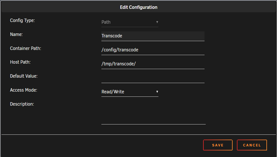

My docker is filling up with what I have a feeling is with plex transcoding.
This normally sits at around 8GB. How do I have transcodes go elsewhere and where is the best place to put them? I am using a nvidia 3060 Ti for transcoding.
Here are my map configurations. Am i mapping straight back to the docker container? Can someone please tell me what I should map to?
image.png.d74a4bd2ad89c47aa208ef0d339729b4.pngimage.png.432f89d9facac246151ea53c518fc834.png

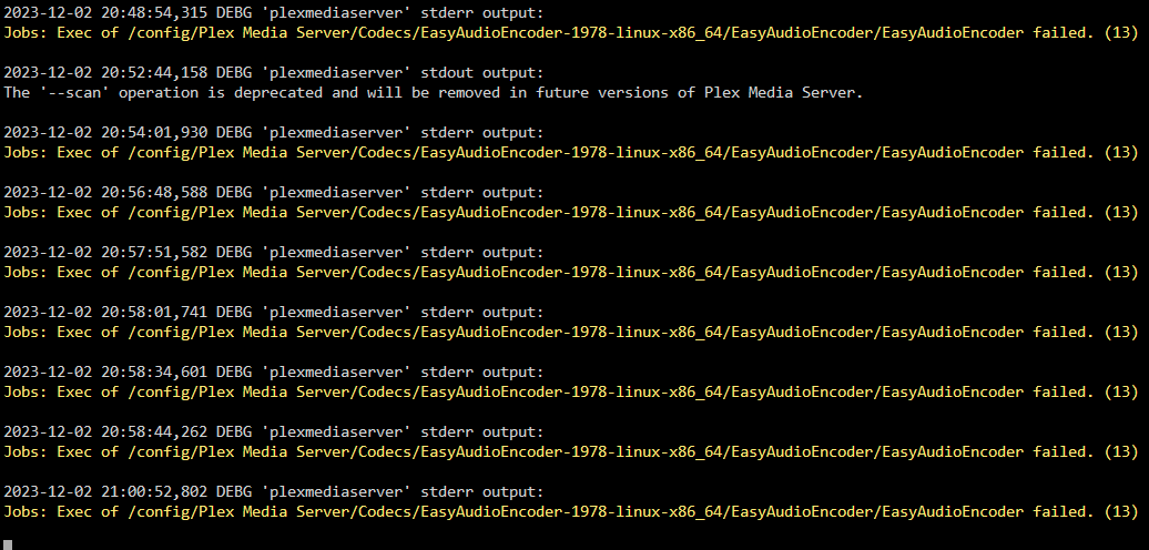

Hey folks, I may not be the only person suffering this issue, but, I haven't been able to find anyone having it the way that I am.
Someone is trying to playback Barbie, on both their Xbox One, and their Macbook connected to their TV. Dolby Atmos / TrueHD 7.1 won't transcode, it just causes the video to stop and constantly buffer. Switching to the EAC 5.1 is fine though, it'll transcode that. I keep getting these errors in the attached screenshot of the log.
I was also having problems with the Windows Player when I tried to install it last month where this specific thing 'EasyAudioEncoder' got called out by Windows Defender (its fixed now, but figured it was a strange coincidence worth mentioning)
Addendum: Looks like it might be a permissions thing? I effed this ALL up... trying to remove some drives I had added... was following a tutorial, and it looks like I didn't run the docker safe  permissions tool.... the one I was supposed to run... wow. I'm pretty sure ALL of my Docker containers are effed. And I really do not know enough about how to un-eff them... like plex isn't allowing me to select my GPU, either, in the transcoding section. It just shows auto, whereas it was there before.... this is brutal.... I'm in quite the pickle... I don't even know where I could go to ask for some help, or even what to search to find out how to un-eff this. Any guidance would be GREATLY appreciated!!!!
Edited by stry8993
it could be a transcode issue i have seen the transcode binaries become corrupt sometimes, or more likely is that the audio transcode is maxing out your CPU causing the playback issue, bear in mind audio transcode is done using the CPU NOT the GPU.
For the permissions issue, post an issue here and tell them what you did exactly (point at the guide or detail commands).
I am honored to see you replying! Love your work, really grateful for it, thank you, and appreciate your response!!! I did make a help request post, and... basically redid the container after deleting the folder, and letting the docker redo the permissions. It wasn't TOO much trouble.
I do have another question though... if you don't mind, in the logs, it was saying that the TRANS_DIR wasn't configured, so it was defaulting to something else (I don't have it running right now so can't check) but, if I set the /transcode to dev/shm in the docker configuration, and then set /transcode inside plex's settings, that should still use the RAM (like up to half your RAM type of deal)?
Also, totally found out the hardway that the audio is transcoded by the CPU. My poor Synology DS218+ was not a fan. So much so I built an Unraid box for it with a Xeon CPU E5-2699 v3, and its generally been okay. The videos on TrueHD 7.1 just wouldn't even load, or infinitely buffer. But English AC-3 5.1 was no problem at all.
*SOLVED*
So yep, deleting the folder, and rebuilding it using the docker container worked! 7.1 is doing its thing, even in transcoding. AND the /transcode + /dev/shm does indeed use the RAM just fine :D. Its all back to normal! Whewf!
