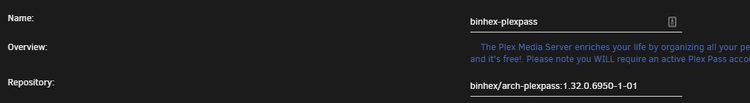

No need to roll back, you simply specify the tagged version you want. In any case I see a new version came out shortly after the previous one, I assume it has the fix included, so pull latest and see if that fixes it.

I have change the version of the docker to an older one and it's working. I have "rollback" to 1.32.0.6950-1-01 version to do that you just need to edit your docker, in the repository you add ":versionnumber"
Wow, thank you so much for posting this. Been tearing my hair yesterday and today. Restoring various databases, running database repairs, etc. This is what finally fixed it for me.

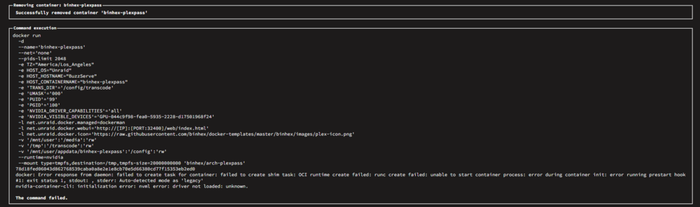

Hello, I'm having trouble with my nvidia transcoder only sometimes working. My GPU will transcode under the automatic setting with no issues, but will not work with a manual setting.
I'm running an nvidia 3090.
