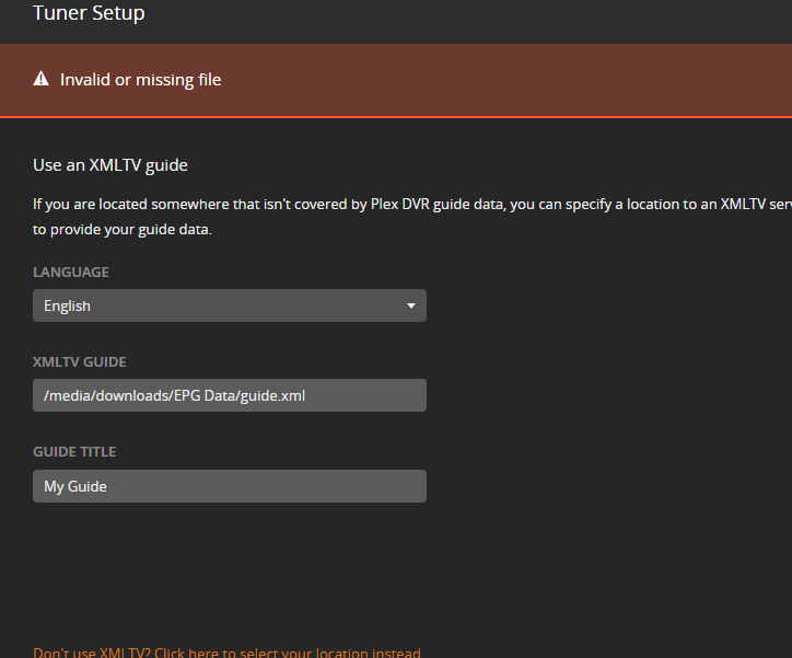

I am trying to setup my DVR and am having trouble pointing to my XMLTV Guide date from within the PlexPass docker, could anyone please help me on this.
I don't use this particular Plex docker container or the XMLTV guide; however, I think your problem is you are possibly trying to use an unRAID file system path inside a docker container.  The container has no concept of unRAID paths.  You probably need to do a volume mapping in the container setup and map something like /guide to /media/downloads/EPG Data and then specify /guide in the XMLTV Guide location.
I am not sure if that setup wants a path including the xml file name or just a path to the folder that contains the xml file.  That would alter your volume mapping depending on which is needed.

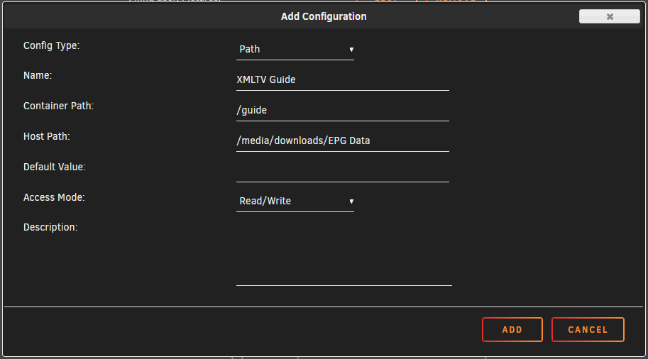

Something like this is needed:
Another potential issue is spaces in the folder path (EPG Data).  I don't know how the container will handle that.  I eliminate spaces in unRAID folder names just because I know they can cause problems at the command line and maybe in docker containers/plugins.
Edited by Hoopster
Thanks for that, that helped to get that part working.
However it did not solve my problem.
TVHeadEnd has found 100's of channels, I am using Antennas to create a virtual HDHomeRun to all PLEX to access them but when add the HDHOMERUN it scans the channels finds 900+ on the tuner, 400+ on the EPG (Freesat UK) but then only lists 13 channels with 3 matches.
Any idea where I need to look to see what is going wrong?

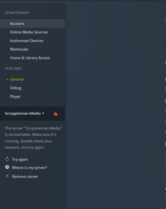

Hey guys, I'm getting this error and I tried a couple of things to no avail, does anyone have an idea? Thanks
2022-05-16 05:25:16,378 DEBG 'plexmediaserver' stderr output:
Jobs: Exec of /config/Plex Media Server/Codecs/EasyAudioEncoder-1785-linux-x86_64/EasyAudioEncoder/EasyAudioEncoder failed. (13)
Hey guys, I've been getting an error that I have been banging my head against that never seen before and can't figure out what is causing it.
Here's the error text:
2022-05-21 13:43:19,028 DEBG fd 8 closed, stopped monitoring <POutputDispatcher at 23247462181536 for <Subprocess at 23247462176064 with name plexmediaserver in state STARTING> (stdout)>
2022-05-21 13:43:19,029 DEBG fd 12 closed, stopped monitoring <POutputDispatcher at 23247462181584 for <Subprocess at 23247462176064 with name plexmediaserver in state STARTING> (stderr)>
2022-05-21 13:43:19,029 INFO exited: plexmediaserver (exit status 255; not expected)
2022-05-21 13:43:19,029 DEBG received SIGCHLD indicating a child quit
2022-05-21 13:43:21,032 INFO spawned: 'plexmediaserver' with pid 82
2022-05-21 13:43:21,128 DEBG 'plexmediaserver' stdout output:
Error: Unable to set up server: listen: Address in use (N5boost10wrapexceptINS_6system12system_errorEEE)
this repeats forever on the official plex docker, and linuxserver repositories, binhex-plexpass cuts it off after like 10 tries.
When I click webUI it just lets me open my plex like normal but there is no server so only the plex served media is there. (kinda obvious since the server wont set up)
Here's what I have tried:
Stopping all proxies / tunnels ( I have been messing around with Nginx Proxy manager and Cloudflared tunnels recently, although plex was still working through my messing around so I don't think this is what broke it, but maybe)
Factory resetting Router (thought I may have messed up some firewall rule or something that was messing with it, although it should be local so I also am not sure how that could be)
uninstalling / reinstalling docker (both with and without deleting appdata)
switching to a different plex repository (they all give the same error)
Checked that there were no other dockers using that port (there isn't as far as I can tell)
I have some kind of hunch that maybe an old process is running and occupying the port, but I have nothing to back that feeling up, nor would I know what to do about a rogue docker process.
Any help would be much appreciated, I am a bit of a networking noob so I need a little push sometimes.

7 hours ago, binhex said:
Thanks. I reviewed the logs and found no corruption or fatal entries. I did find a few error relating to parsing xml. Please see below. The last lines for parsing device schema are referencing an NVidia ShieldTV device. I changed the IP to read x.x.x.x.
This series of errors repeats several times.
Line 20475: May 24, 2022 05:45:41.053 [0x14684350db38] ERROR - XML: Entity: line 1:
	Line 20476: May 24, 2022 05:45:41.053 [0x14684350db38] ERROR - XML: parser
	Line 20477: May 24, 2022 05:45:41.053 [0x14684350db38] ERROR - XML: error :
	Line 20478: May 24, 2022 05:45:41.053 [0x14684350db38] ERROR - XML: Start tag expected, '<' not found
	Line 20479: May 24, 2022 05:45:41.053 [0x14684350db38] ERROR - XML: status=ok
	Line 20480: May 24, 2022 05:45:41.053 [0x14684350db38] ERROR - XML: ^
	Line 20481: May 24, 2022 05:45:41.053 [0x14684350db38] ERROR - Error parsing content.
	Line 20482: May 24, 2022 05:45:41.053 [0x14684350db38] ERROR - Error parsing XML: Error parsing file.
	Line 20483: May 24, 2022 05:45:41.053 [0x14684350db38] ERROR - SSDP: Error parsing device schema for http://x.x.x.x:9080
