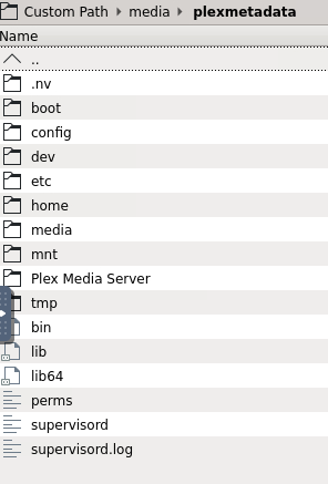

So I had a fat finger typo in the plexpass docker console. Are these the correct files/folders that should appear? I have the config in a separate pool.

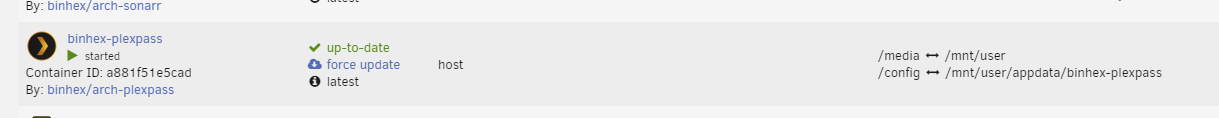

Hello I'm trying to add my shares to this. but my shares are split into tv shows and movies and not under one blanket folder called media.
I tried add 2 separate paths that lead to media in the container but I get an error and the docker crashers. The way I added the second path was to copy the container path and then edit the host path to my other share.
It tells me I can't have a duplicate of the media path
Am I missing something or?
Edited by stylus
Yes, you need to have a unique container path for each host path.
Just a suggestion, but maybe remove the default /media path, and create 2 new paths, /TV and /Movies. Then in plex point to those paths instead of /media.
Thanks for the help, I removed the original path and I added 2 new ones each with separate labels. It works no problem now, just had to find them within plex.

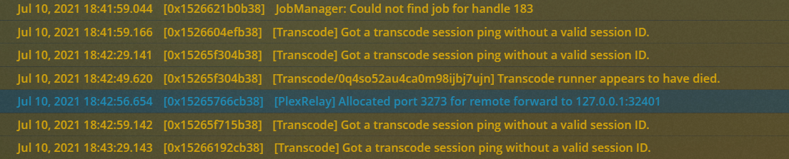

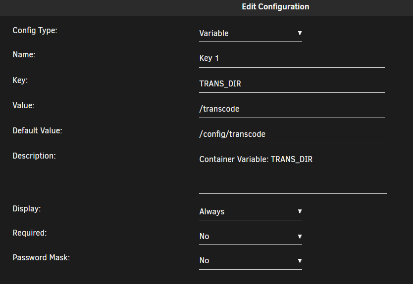

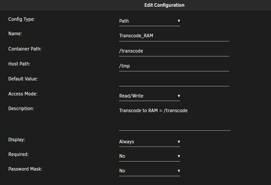

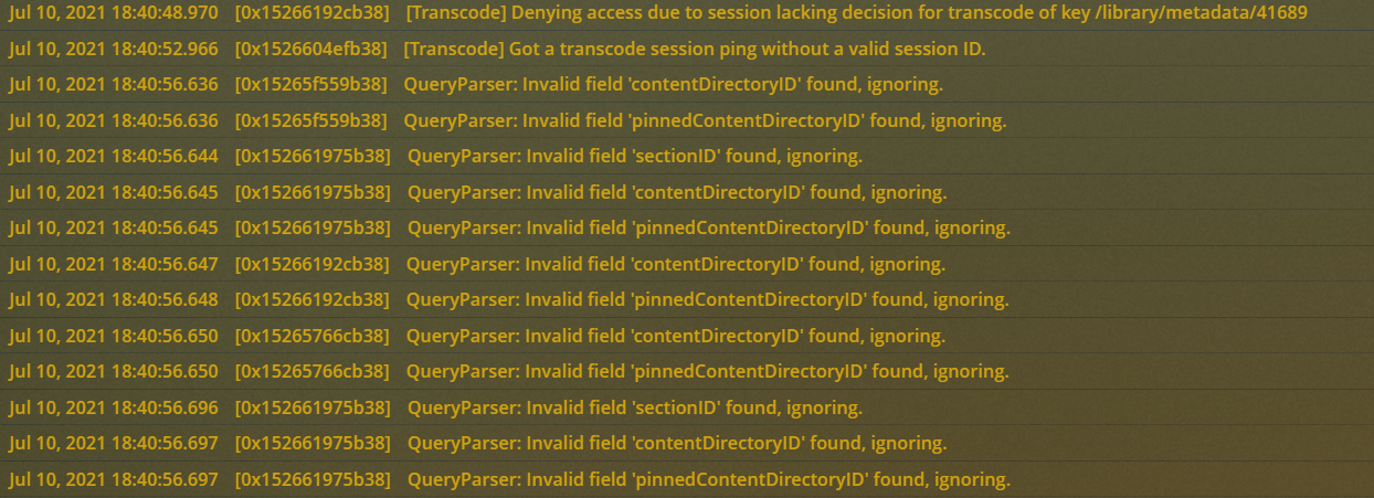

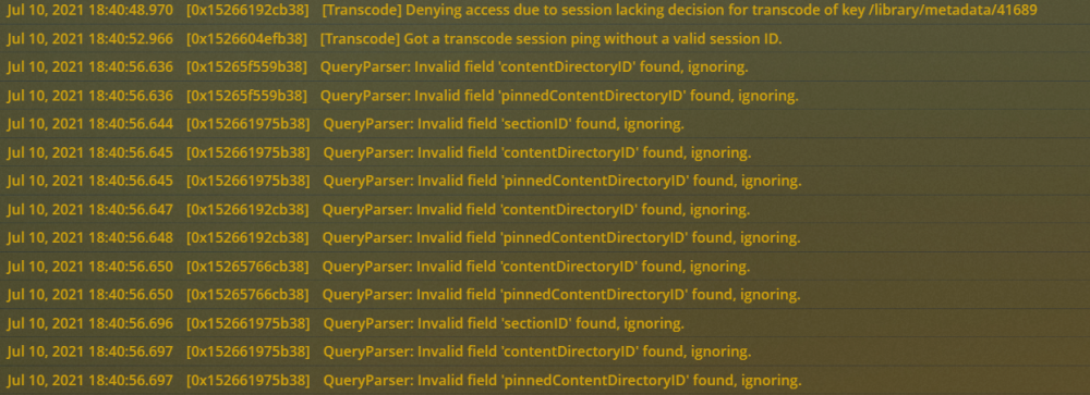

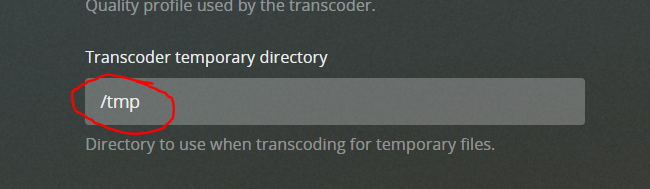

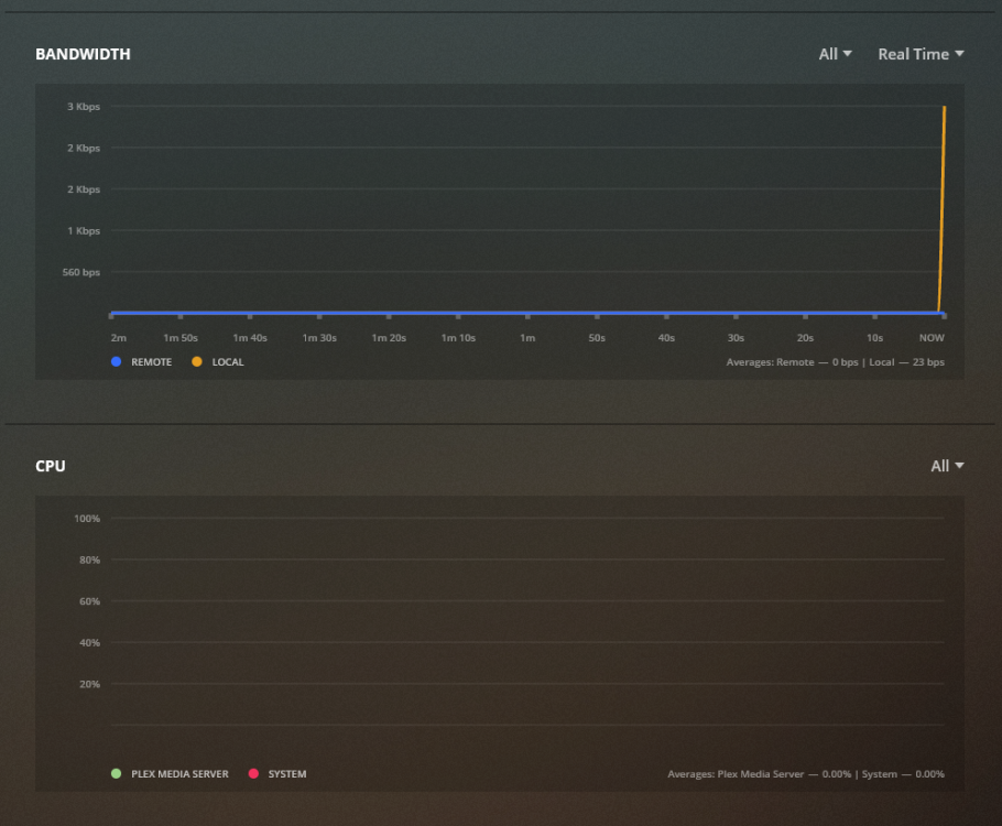

Hi All,
I know that this has been answered, but I'm still a bit confused.
It looks like I'm still having transcoding problems when I'm trying to transcode to RAM.  I did follow @binhex FAQ on transcoding to RAM:
I'm just a bit loss in Plex...
Do I need to set the transcoder temporary directory to a path?  I currently have /transcode as the path.
I'm also using a P2000 and have hardware transcode enabled and that seems to be working fine when the transcode start for the beginning.  If I were to change the quality manually it just spins and never changes the transcode.
Also I'm getting these warnings in my logs:
This is the messages when I change quality on a stream from chrome.
I think I might be over thinking this too.
Thanks in advance...

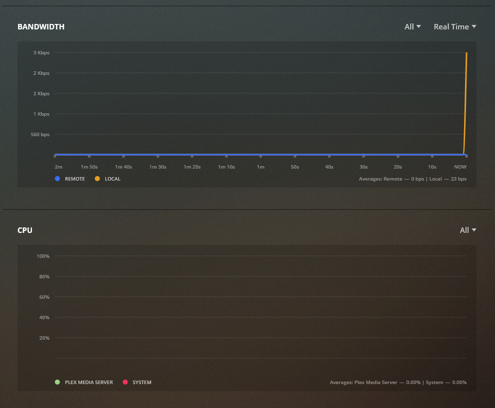

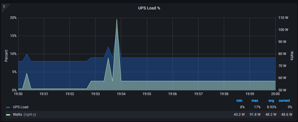

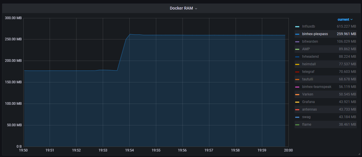

Hi everybody,
the following "issue" is more of a question than it is a real concern for me.
As you all know in the last day there were a few updates available, so I downloaded them and everything worked fine.
Since then I recognized an higher idle power usage reported bei my ups and I got a bit suspicious after a little bit of digging I found out that my binhex-plexpass docker is utilizing more system resources after the update than before. Which would be fine with me if it got any new features or something so I looked up the official change notes but there almost only bug fixes done in this release (1.23.4.4805).
Now that another update (1.23.5.4801) came out just hours later, I thought maybe something was causing problems in the older release but the docker still is utilizing the same "higher" amount of system resources.
my system reported on the binhex docker:
RAM:  50% higher usage
CPU: 3-4% higher usage
which relates to about a 5W higher power draw.
Added screenshots of some system resources graphs.
I did not change any settings or added new content since the initial update, which could justify the higher usage.
I am not really looking for a way the "fix" this rather I'm interested why and what is causing it.
Did anyone experienced the same thing or has any explanation for this behavior?
Thanks in advance!
your screenshots look correct to me, what you are probably seeing is plex being a bit crap when it comes to switching from transcoded to not, also changing quality is also hit and miss and more often then not requires me to stop the video, go back and 'resume' then it plays fine, this is 'the way' for plex, its not great but there ya go, here is hoping it improves one day :-).
if you can see that plex is transcoding in the ui then check the hosts /tmp folder, if you see dynamically generated folders and files being created in there then its working as intended.
@binhex...Thanks for the info.  Just for clarification, within Plex, what should I have in the "Transcoder temporary directory"?
You will see Plex generate files and folders with what look like randomly generated names, Plex will then write to that location if it needs to transcode
Sent from my CLT-L09 using Tapatalk
Hey @binhex...I'm looking to see if this is the correct setting within Plex.
