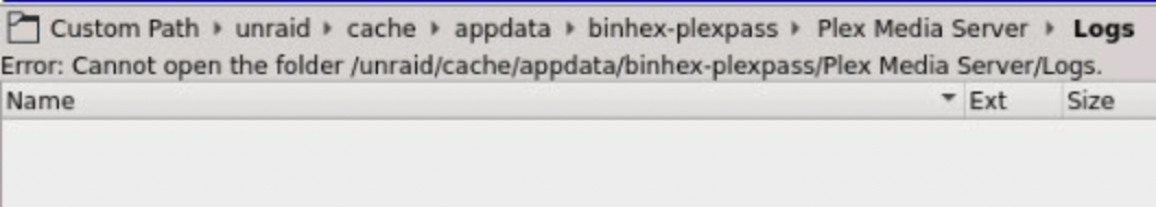

Hey guys,
I'm trying to collect plex logs, but when I navigate to the logs folder in krusader it says it cannot open the folder.  I also tried deleting the Logs folder to see if Plex would recreate it but it would not delete.
Searched this thread, but didn't find any issues like this yet.  Any idea why this is or how to fix it?
Thanks!
Edited by acosmichippo
