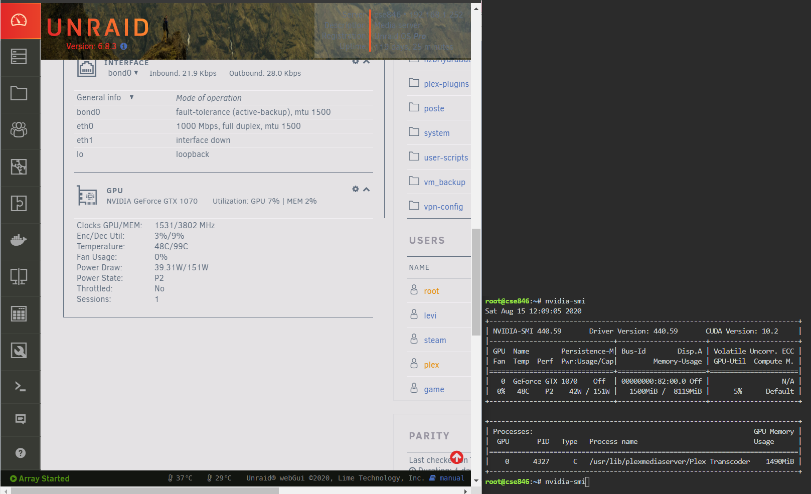

Ah, there we go:
I had to encode something really heavy though, a 4k file.
The above screenshot is using the GPU Statistics plugin: https://github.com/b3rs3rk/gpustat-unraid
and the right is just nvidia-smi.

I used the watch nvidia-smi in console. No activity with this container.
Linuxserver.io container shows the GPU doing the work

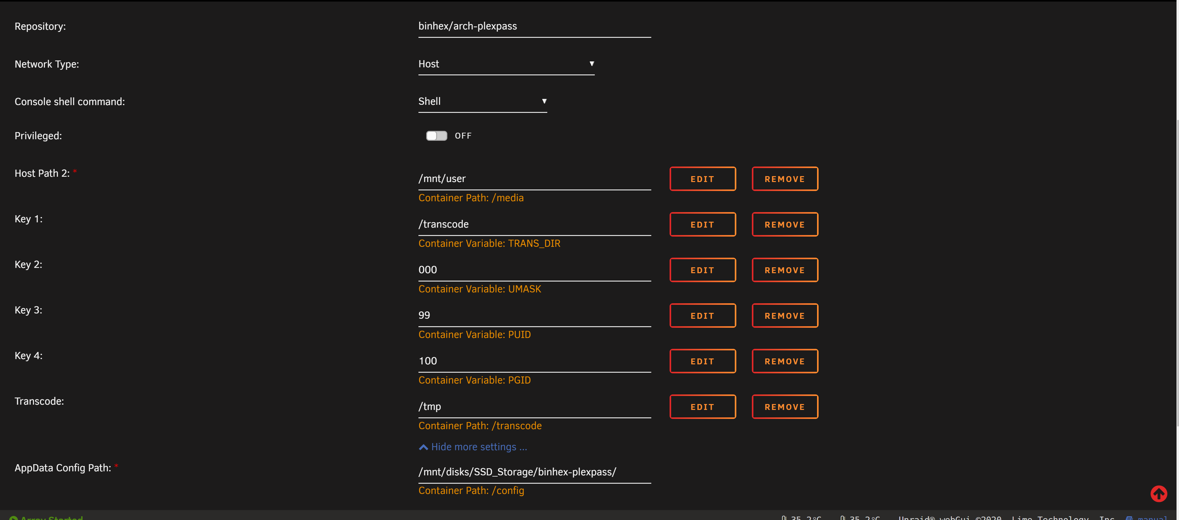

also can you screenshot your settings for the container, left click, edit, click on advaneced view, click on 'show more settings', screenshot.

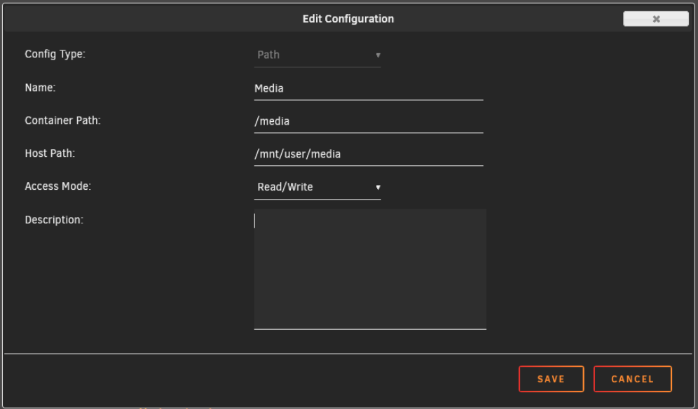

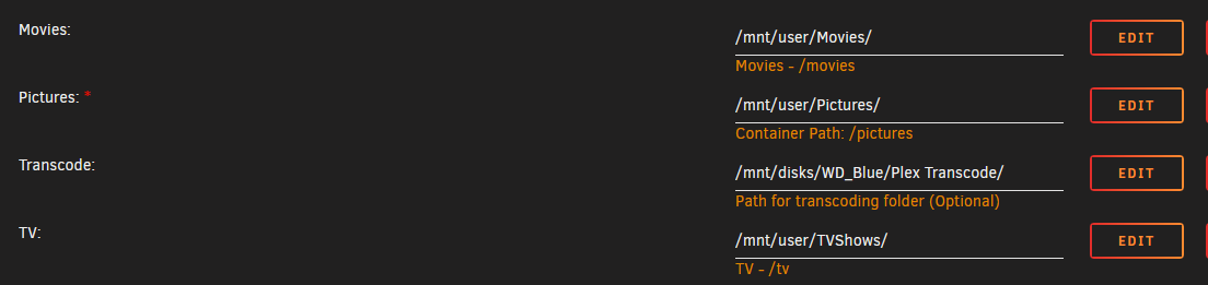

21 minutes ago, Nnyan said:
But when in the Plex app it can't find this media folder and I can't seem to manually point to it.
This probably has to do with your statement about not understanding how docker works.
The unRAID filesystem and the Plex docker container file system are NOT the same thing.  You cannot browse for media in Plex using the same folder paths you would use on the server itself.
You need to create volume mappings in the docker config that tell Plex that "this folder path in Plex" = "that folder path in unRAID"
Do you have just one parent media share in unRAID and subfolders for each media type, or do you have different shares for different media types (this is what I have)?
If you have one parent media folder, your volume mapping in the docker container config would look something like this:
When setting up a library in Plex, you would then browse to /media (the container path) and select the subfolder (movies, photos, etc.) for the desired media type.  Plex then knows that /media/{media type subfolder} really equals /mnt/user/media/{media type subfolder} for the content.
If you have a share for each media type, you need multiple volume mappings in the docker container config; one for each media type.  Something like this:
In this scenario, for setting up libraries in Plex, you then browse to /movies for movie content, /pictures for photos, /tv for TV shows, etc.
