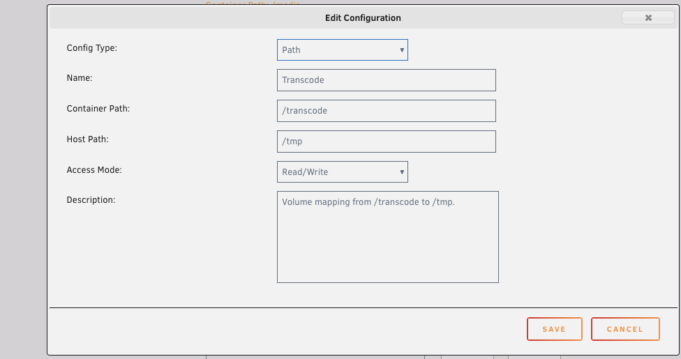

Yikes, so the typical plex instructions of just using /tmp are not adequate? image.png.48c664a8196c036a391b5790ea93d428.png
 create a new volume mapping, host path /tmp and container path /transcode
the typical plex instructions are probably for a full fat normal linux distro, this is docker so things are different.
So you're saying it should be:
yep you got it exactly right!, if you want to confirm then look in /tmp on the unraid host and you should see folders and files created there.

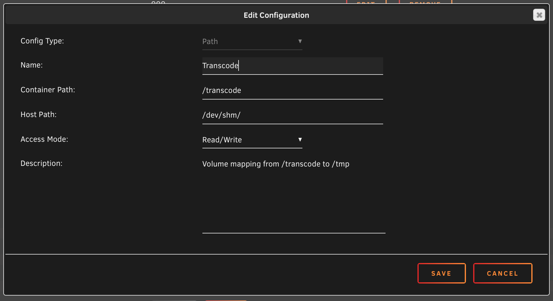

Edit: Also, followed that guide above to "fix" transcoding to ram.  didn't work though.  I ended up mapping /dev/shm to /transcode and pointing Plex to /transcode.  Still getting the above error though.  In the image is now what I have for ram transcoding, I think its working but its kinda hard to tell.

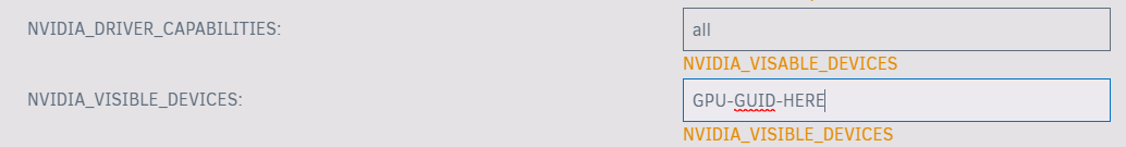

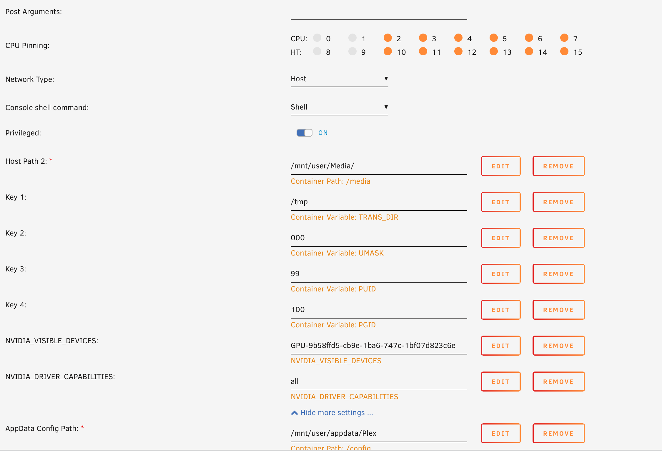

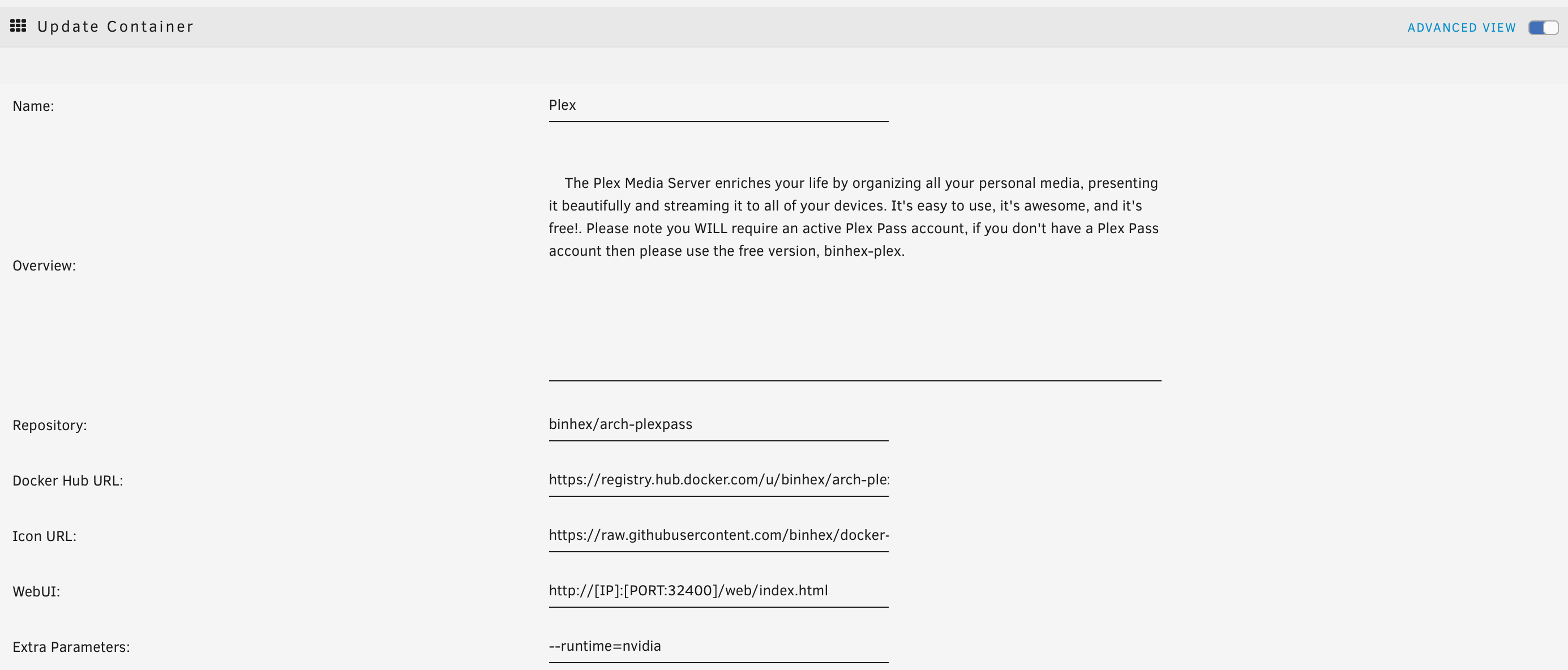

My container params look like so:
Do you have both of those set?
Yes, this is what my setup looks like
