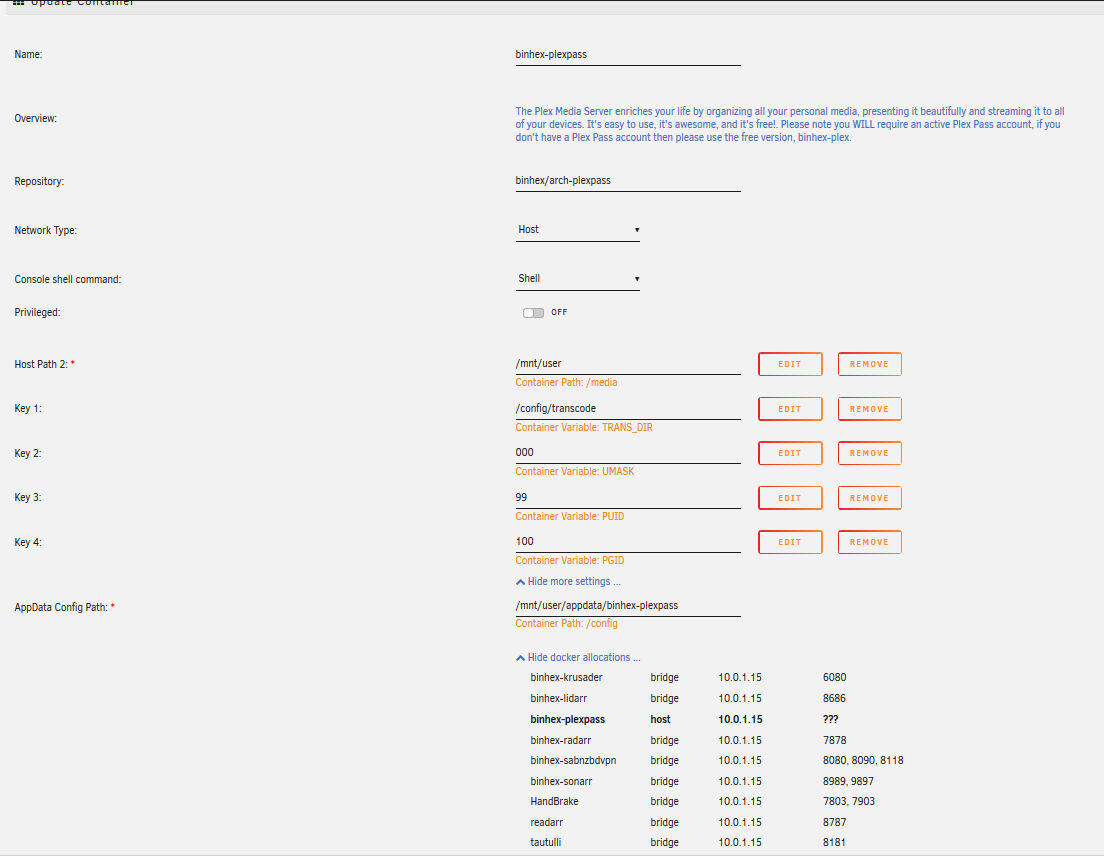

I have been using binhex-plexpass for over a year.  Lately I am getting a lot of errors saying I cant stream directly from the server fast enough (I am on a gigabit network) so I went to check the settings and I find that I no longer have a webui option for the docker!
I have a bookmark to the ip, but when it didn't work I logged into unraid and found no more option for webui....
Any advice?

i would suspect you have changed your network type from the default of 'host' to bridge, am i correct?.

Yes, it is gone from the dropdown.
Not sure how long that has been missing, since I normally just use a bookmark to the location:  http://192.168.1.xxx:32400/web/
I have not made any changes to my network type.
The strangest thing is that plex is still running, and remote access is working (which means my port forward is working) and if I log in at plex.tv I can even edit the settings there, just can't reach the webui on my local network.

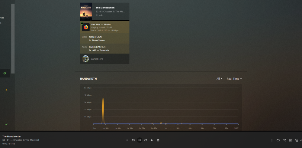

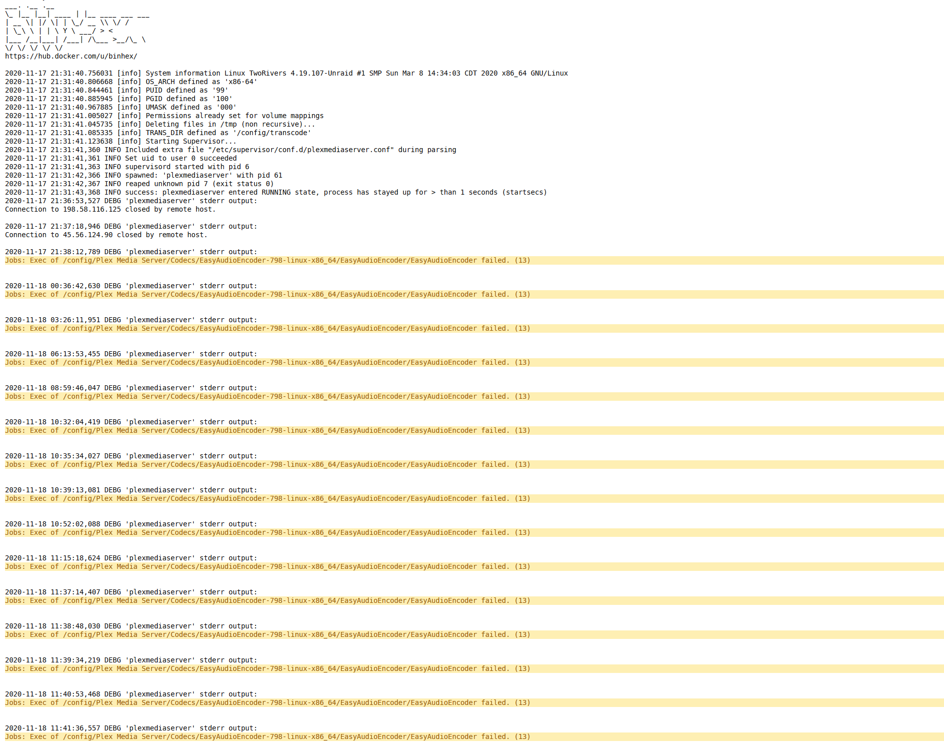

I just finished setup of my container, transferred my Plex library and metadata; but I am having some problems. I can play some of my media but not anything that seems to be in 4K. I first tried to play the Madalorian in 4K on my FireTV and it would only play for about 90 sec before stopping and then never startup again. If I restarted it would play for another 90 sec. I went to the browser (Firefox, Brave) and tried again but no luck at all with playback. Even the 1080p version was not playing as a test in the browser but it would play on the FireTV...
I have been looking at the logs for awhile but nothing stands out to me other than EAE errors but I cant find a fix…
Attached are the logs if you need to see them. Did I miss something during setup??
Please let me know if you need any more info.
EAE errors are usually fixed by deleting the contents of the codecs folder in Plex which forces a new download of each codec as needed.  Sometime they get messed up.
Codecs folder is under LIbrary>Application Support>Plex Media Server in your Plex appdata path.
Thanks! I deleted all the contents of the codecs folder and so far its good. I have three streams going 1x 4K and 2x 1080p with one transcoding audio.....

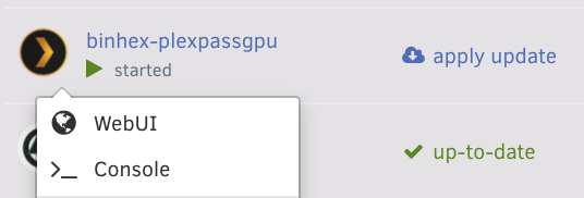

Any reason why my docker keeps telling me an update is available, appears to apply the update, and then goes back to update available?
Overview of what I see when applying the update, looks like everything seems to go ok
TOTAL DATA PULLED: 251 MB

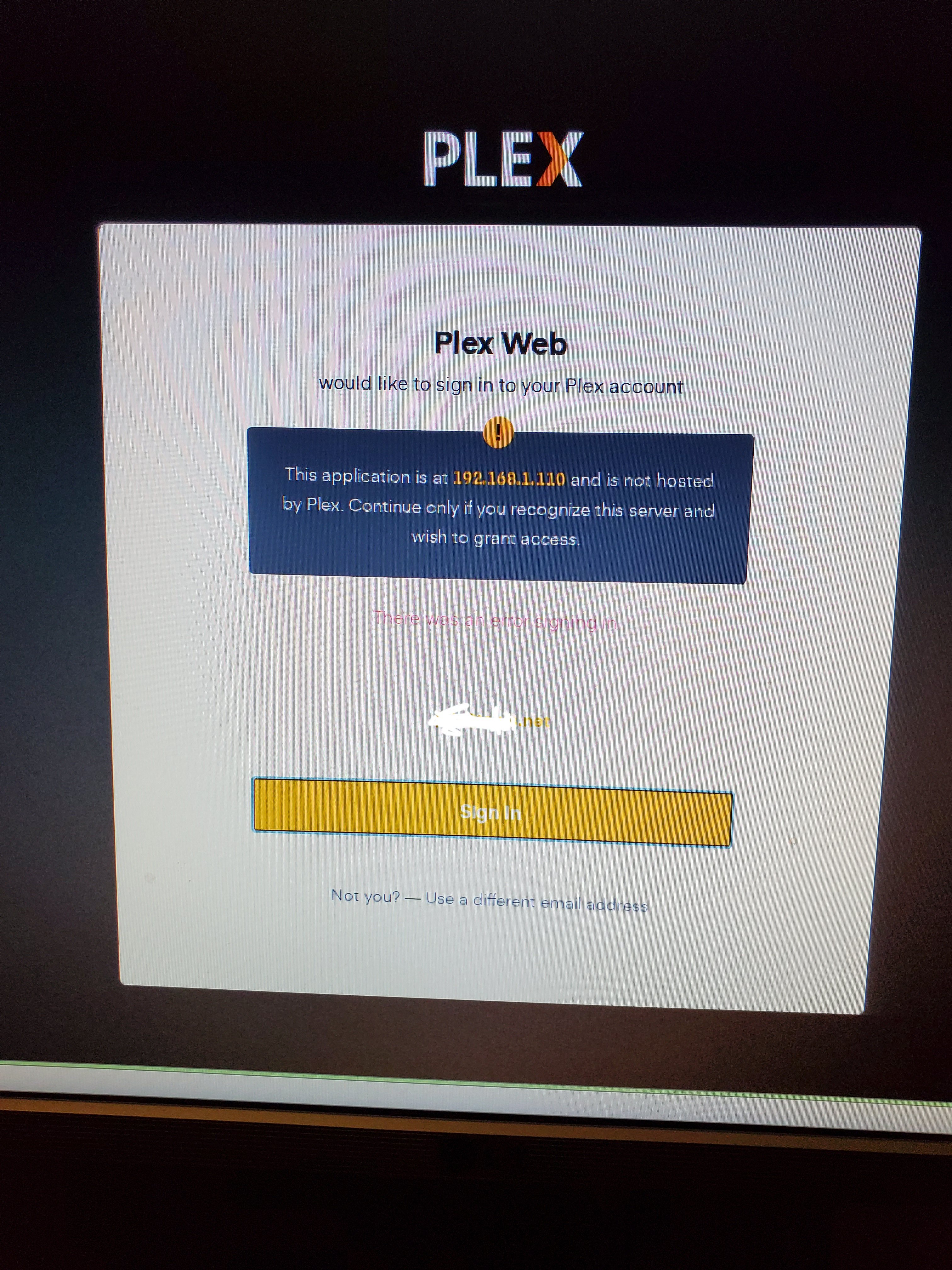

I have one odd login issue but only the WebUI on the unraid gui i get a login loop as shown in the photo.
Edit: had to edit the settings for WEBUI from http to https to get it to work on the Server UNRAID GUI browser.
Edit2: well I went and check again after restarting the machine, still loops on the login like above only on the actual Server Unraid's GUI firefox.  I usually don't use the PLEX web on the server so no hurry.  Some people say it is a Firefox issue but hard to try on the Server as the Browser is only Firefox.
Edited by Paul_Ber

Not sure if this is the correct place for this, but as this is happening in binhex-plexpass, I'll give it a shot.
Recently some of my videos have audio that will not play. If the audio is AC3 or EAC3, it plays. But if the audio is AC3 5.1, or HE-AAC STEREO, it does not play.
All of these formats played flawlessly just recently.
Any suggestions as to where to start troubleshooting?
Thank you-
Often issues such as these can be resolved by deleting the Codecs folder (or renaming it to something else if deleting it worries you) and letting Plex download the needed codecs again on demand.
This folder is located in {path to appdata}/{name of Plex docker container folder}/Library/Application Support/Plex Media Server/
Great! thanks.
I'll try that first thing, a similar approach helps when metadata doesn't load.
OK, that didn't work.
Is there a way to add codec packs to Plex?
thanks-
