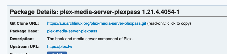

There's a new version on AUR. Any chance of an update?
9 hours ago, binhex said:
its automated, you dont need to request, its already been built:- https://github.com/binhex/arch-plexpass/releases/tag/1.21.4.4054-1-01

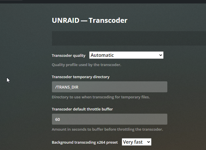

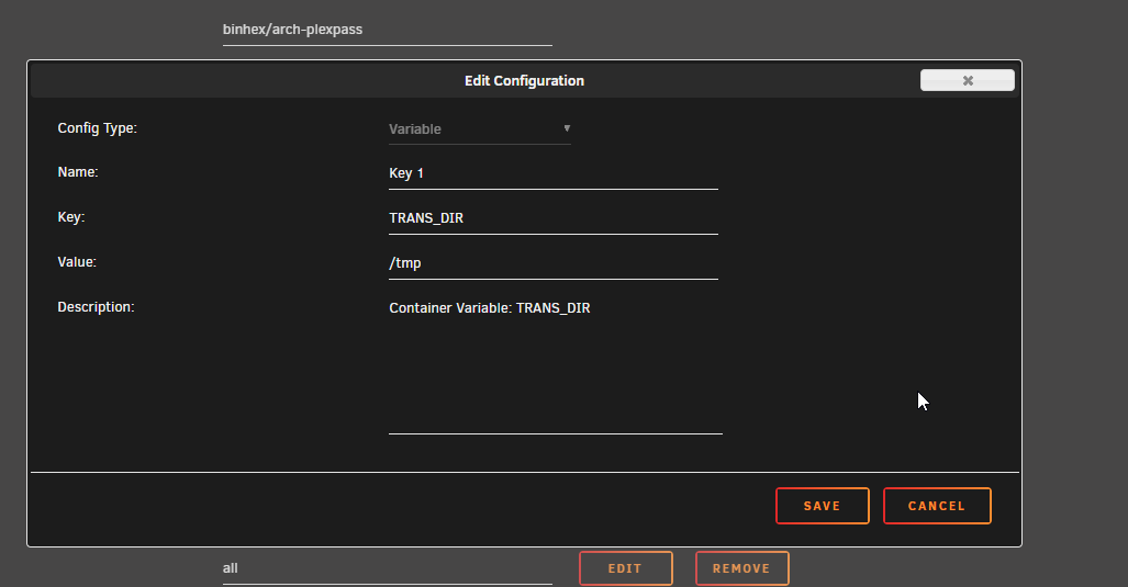

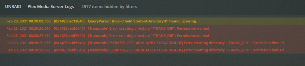

Not sure what I'm missing but I noticed this error today for TRANS_DIR. I thought I had it setup to transcode to ram.
Any idea what I'm doing wrong? Thanks
image.thumb.png.c6115cd72a862b6b8d2fefc9204e1cc2.pngimage.png.ee6d6a29e99ae9d37de936e16e73d52c.pngimage.thumb.png.e9dd32cdde1c279e128a4c8b75bd2795.png
You have not followed the instructions in the Binhex Plex documentation.  TRANS_DIR should not appear anywhere in Plex or the container volume mapping configuration.
Looks like I'm an idiot. I set it up a long time ago. Thanks
