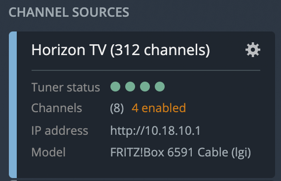

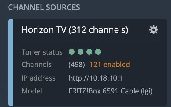

Hey @binhex,
I'm trying to set up Live TV & DVR. When I do that with the official Plex Pass server (standalone edition, either on windows or mac, version 1.25.0.5246, same as here) scanning channels on my tuner results in 498 channels being found, 312 epg channels are available:
When I do the same, meaning exactly the same channel scanning settings on binhex-plexpass (also running version 1.25.0.5246) it results in only 8 channels being found, also 312 epg channels available:
I'm a bit lost now, not knowing why that might be the case. I tested the official Plex server on both windows and macos, the official docker isn't available on 1.25.0.5246, the old 1.24 version that is available also just finds a couple of channels.
Can it be that there is something missing on the binhex-plexpass image in regards to the official Plex server version? It seems at least so, that whatever changed from 1.24 to 1.25 didn't get carried over into the 1.25 binhex-plexpass...
Best regards,
epp

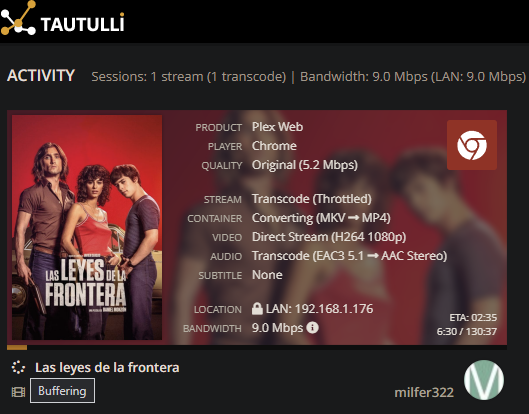

Sorry if this has been covered somewhere already. I've spent a few hours now doing different searches on Google trying to find something related to my issue, but have yet to find anything meaningful. My biggest issue with troubleshooting is I can't seem to get any of the crash report .dmp files as the folder for it is always empty. I'll start with the issue.
One of my users started reporting an issue with playback. He was just getting a playback error "an unexpected playback problem occured". On a different device, he got an Error code: s1002 (Network).
I was able to reproduce a crash with trying to play the same media file locally once I got home and on my network. So doesn't seem like it's network related, also other files play fine. It's just a handful of files that appear to be an issue.
Transcoding is taking place on my GPU without issue for other media files as you can see in the image above. Yet in my logs I did find this one error that seemed possibly of interest "ERROR - Error creating directory "/transcode": Permission denied". A screenshot of my container settings below:
Everything for the most part has been working fine for years. Only in the past week has anybody had any issues they've mentioned, and I know I use it almost daily to watch stuff. I don't do any TV recording. I just rip disks and put stuff on my server. I've not had issues with playback of the files/movies in question before.
I've attached one of the media server logs from around the timestamp when I had attempted to load the movie Harry Potter and had it crash. Again, the crash report would probably make this a lot easier, but I'm unclear on how to prevent PMS from purging the crash reports so I can grab one of them. Seems like it gets purged the instant it's created as I never see it in the folder the logs indicate it was dumped to.
2021-11-28 12:21:31,466 DEBG 'plexmediaserver' stderr output:
****** PLEX MEDIA SERVER CRASHED, CRASH REPORT WRITTEN: /config/Plex Media Server/Crash Reports/1.25.0.5246-cb2507e4d/PLEX MEDIA SERVER/f3166314-0682-4fa9-bcb06a82-580b4e9f.dmp
2021-11-28 12:21:31,844 DEBG fd 8 closed, stopped monitoring <POutputDispatcher at 22710437100560 for <Subprocess at 22710436647840 with name plexmediaserver in state RUNNING> (stdout)>
2021-11-28 12:21:31,844 DEBG fd 12 closed, stopped monitoring <POutputDispatcher at 22710436850752 for <Subprocess at 22710436647840 with name plexmediaserver in state RUNNING> (stderr)>
2021-11-28 12:21:31,844 INFO exited: plexmediaserver (terminated by SIGSEGV; not expected)
2021-11-28 12:21:31,844 DEBG received SIGCHLD indicating a child quit
2021-11-28 12:21:31,845 INFO spawned: 'plexmediaserver' with pid 7552
Thanks in advance for any insights into how to troubleshoot this issue.

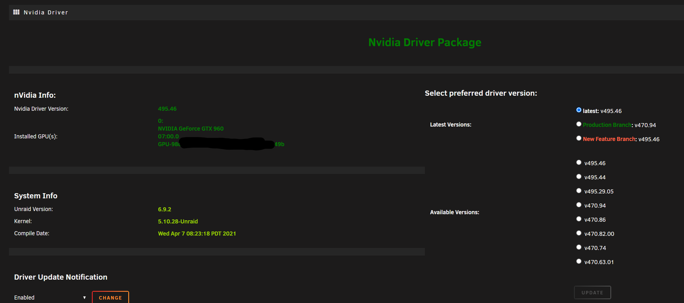

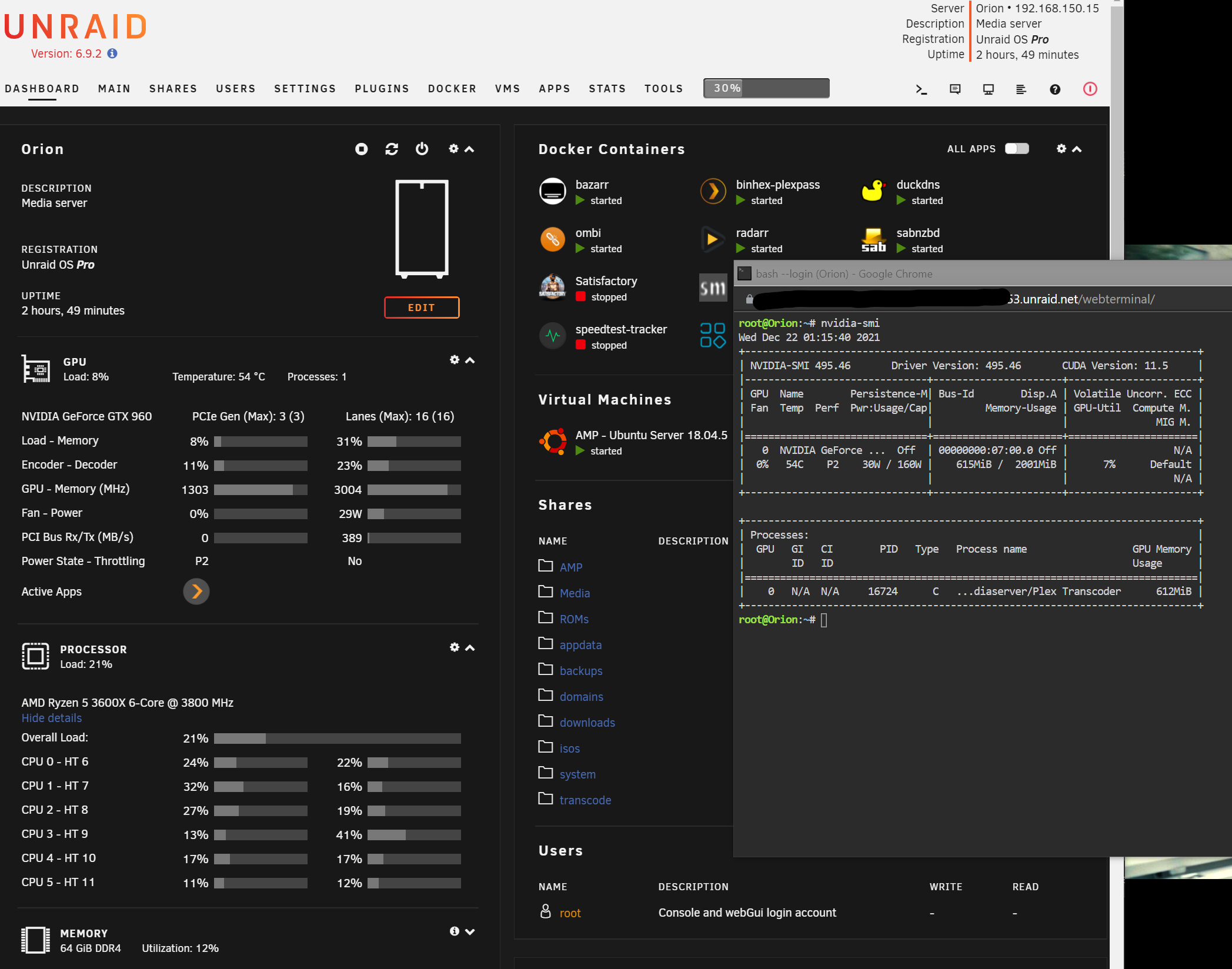

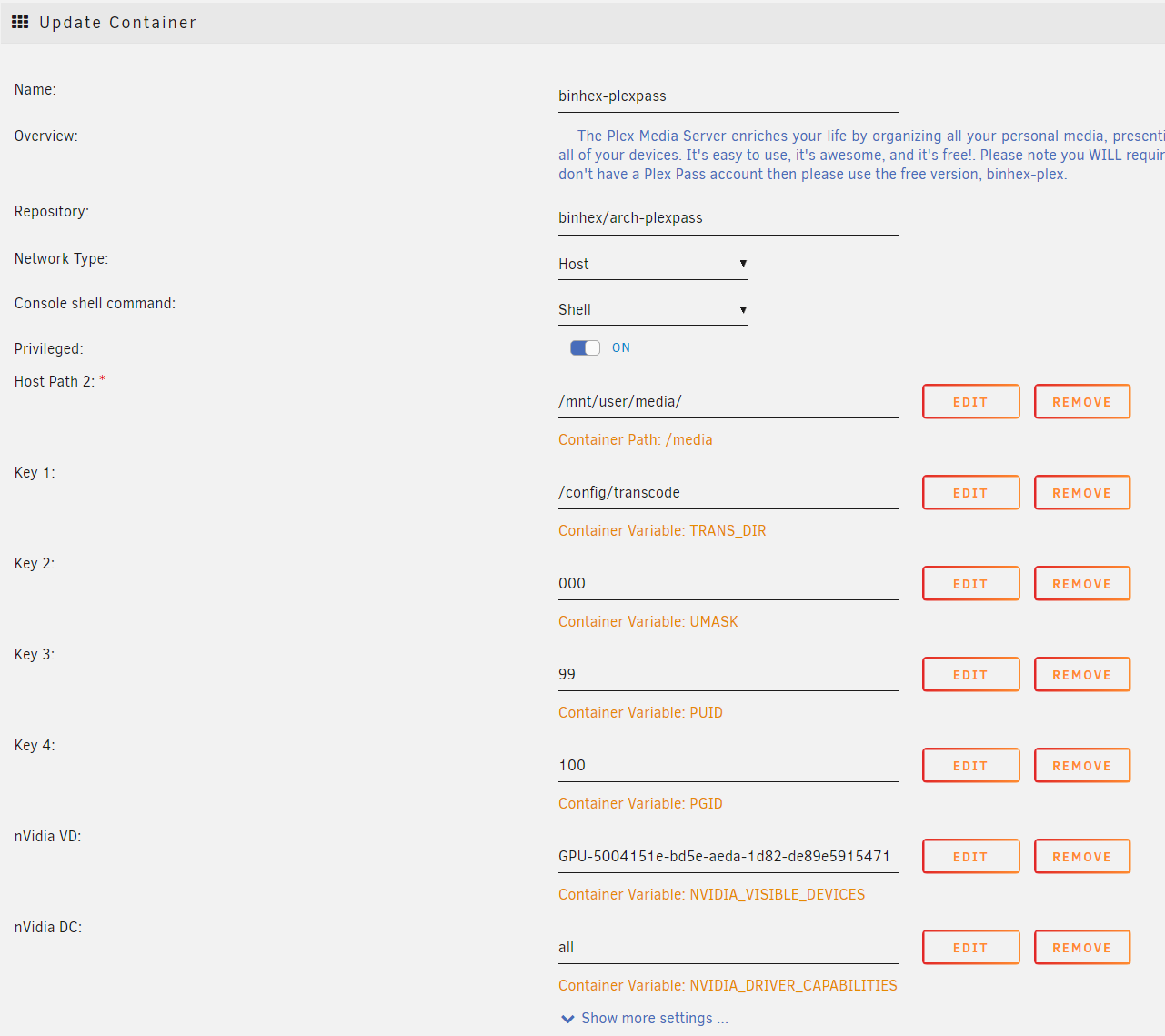

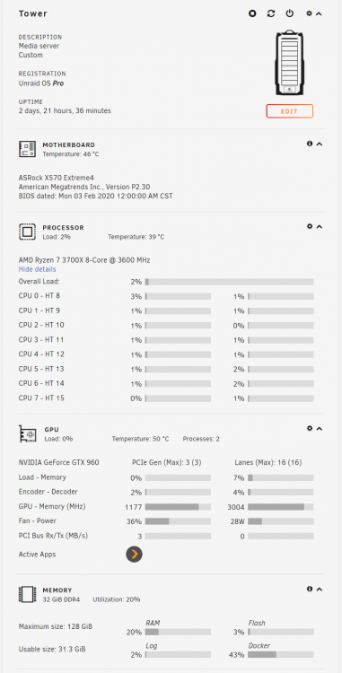

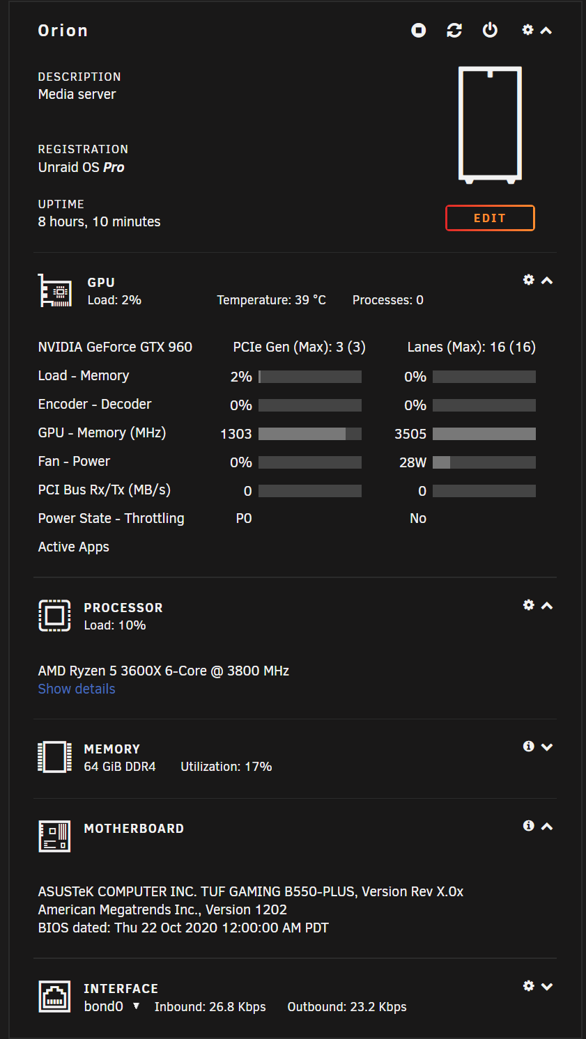

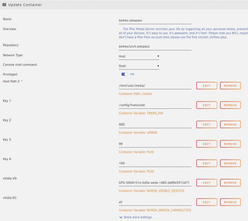

Hi all,
For the love of god, I cannot get Plex to use my nvidia GPU to transcode. Currently running a GTX 960
Currently I have unraid setup and running (v6.9.2), nvidia driver plugin installed (v495.96), plexpass subscription, GPU ID in the binhex-plexpass docker set, and I even tried adding ''--runtime=nvidia' into the extra parameters of the plex docker config. I have hw acceleration enabled in plex. I have tried enabling and disabling HDR tone mapping as well. Nothing I do seems to get the GPU to take over when I try viewing the content over my web browser.
Anything I should be looking at?
Details of my config below:
Unraid HW Specs
Plex Docker
nvidia plugin:
Edited by darkdrake
typo

On 12/19/2021 at 7:14 AM, darkdrake said:
GTX 960
What kind of 960 is this? Keep in mind not every version from the 960 is capable of transcoding HEVC (h.265).
Have you also added the variable with the Key "NVIDIA_DRIVER_CAPABILITIES" and value "all" as described here:

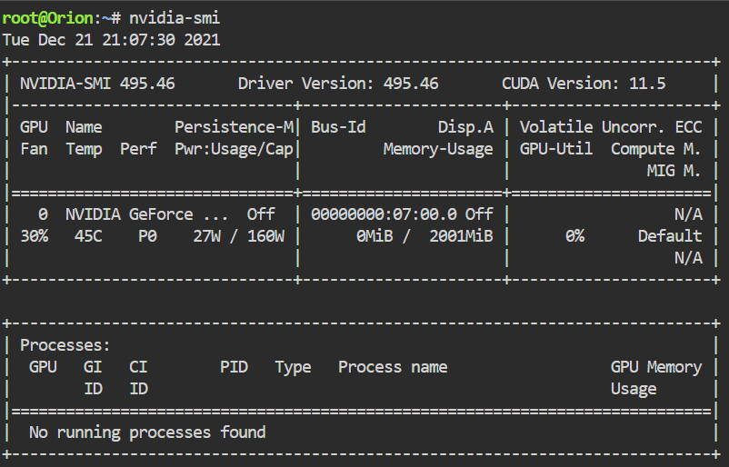

Can you open up a terminal from the container and type in 'nvidia-smi' and see if you get a output from this command?
What kind of GTX 960?
EVGA GTX960 FTW edition.
Yes I believe so... check the plex docker config in the original post.
Nvidia SMI output:
Update: Got it working. I deleted and reinstalled the docker image, and double checked everything including adding the --runtime=nvidia and it's working as expected.

Having an issue with binhex-Plexpass docker seeing DVB card as implemented by @ich777 DVB driver. Official plex docker DOES work.  I've tried passing the /dev/dvb value both ways and it doesn't appear when attempting to add in Plex.  Anything I can try?
For background and sorry if this is a cross-post. From the DVB thread:
Lately I have problems more than usual, some movies stop in buffering.
I have tried changing the trans_dir to an SSD, but the same thing keeps happening. The problem is that they are small 6GB movies or with series chapters.
They stop every 3-5 min.
Any ideas? Or how I can debug that? The CPU and RAM is OK.
