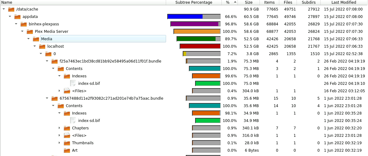

Updated to Unraid version 6.10.2 but now having a playback error.
Any ideas?
Nbe7HQN.png%C2%A0
Then updated plugin and getting this:
hmm must be something with the cache device huh
image.thumb.png.d2920263f7c77c22134f5a4817d7057f.pngimage.thumb.png.b50905e7d42c8c69113524a283ffeaf8.png
self.stream.flush()
OSError: [Errno 28] No space left on device

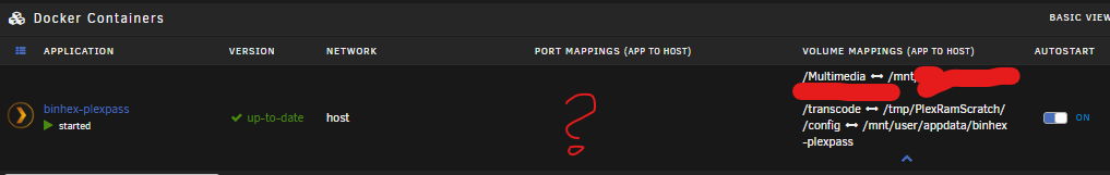

Is this normal with binhex's version?
Port mappings are empty.
Edited by CiscoCoreX
Host network type doesn't remap ports, it passes them all directly. Doesn't matter whose version.

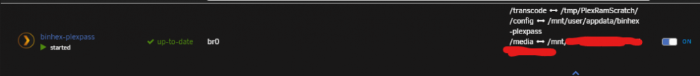

Same with br0 network type. And bridge and custom network type.
I was testing the version from linuxserver, then all mapping was available.
Hey All,
Quick Q - Im slowly loosing free space on my cache drive due to these index files
Any suggestions?
This reddit thread suggests it has to do with previews and thumbnails (index-sd.bif) - do we havbe a way to push these off the cache?
Update: This article covers the creation of the video preview files used for when fastforwarding... depending on your library size it may be worth removing them as per the instructions in the article for series.
Edited by Bluedevil678
Additional Data
