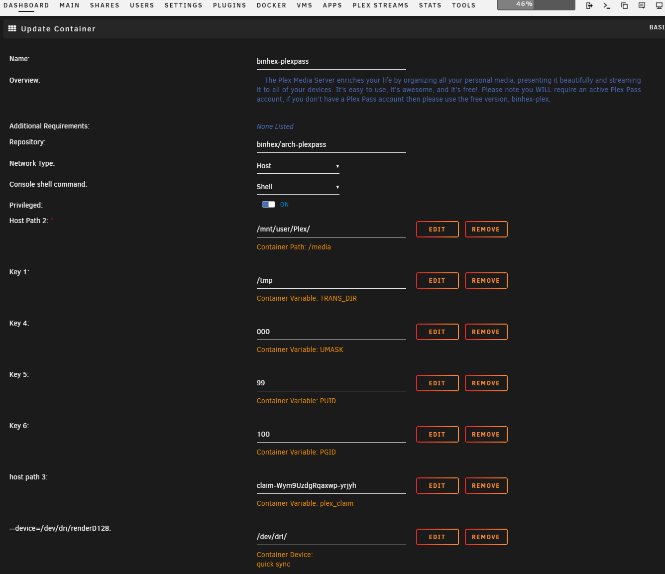

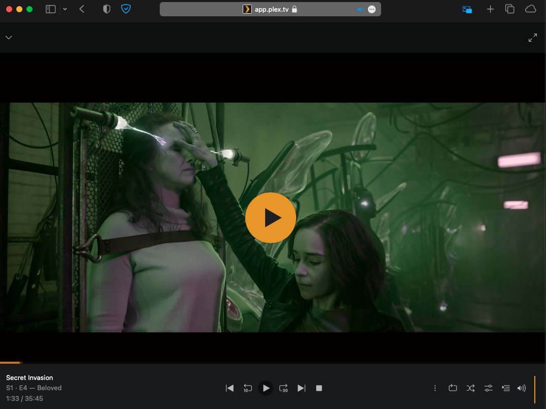

4K DoVi (HEVC Main 10) content shows like this when doing HDR to SDR.
Does anyone else get this?
Hardware should be capable of transcoding easily.
11th gen igpu 11-900t
I have the device added as device /dev/dri
How do I tell it to use all the intel driver capabilities i.e to match the default nvidia variables.
Thanks

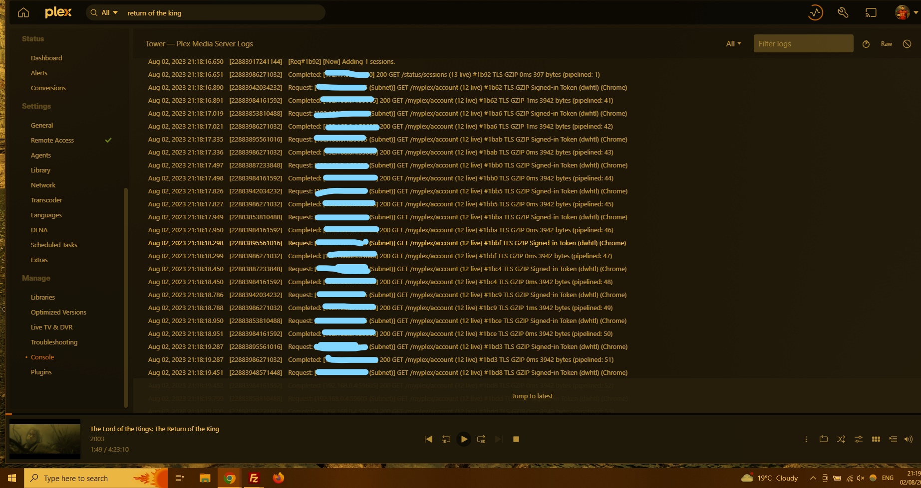

looking for some assistance, here. up-to-date with binhex-plexpass on unraid 6.11.5
recently seems unable to handle certain files, and i've been trying to narrow down the cause:
i thought DTS was the issue on my Samsung TV, as i believe they are unable to play it, though the transcoder should work.
my Roku is also having the same issues, however. i tried a non-DTS movie today and it did not work, though it was DD5.1
the movie that did work was the same size as the DD5.1, but FLAC audio. it did transcode the audio, and it worked fine.
so there's something in the transcoding...
I have an NVIDIA [GeForce GTX 950] GPU which should be more than capable.
i used TrashGuides recommended Plex settings for transcoding, but wanted to check with the binhex container settings
TG recommended to use /tmp/plex for the /transcode setting, i'm not sure if that will certainly use my SSD cache(?)
the other binhex settings ": NVIDIA_VISIBLE_DEVICES" i don't know what to set?
nothing is available to click and choose.
the Plex console logs are a mess, it is running things constantly and i have no idea what it's doing, it's not any library scan or anything i've asked it.
as a workaround, i can sometimes get the item to play on my laptop PMS, pause it, open TV/Roku, and Resume it from Continue Watching. no other way works, but always get the error message "unable to add to play queue"
i've attached the log of what is constantly happening when i'm not trying to play anything.
what information can i give that can help someone help me lock this down and get plex working as it should?
thanks for any assistance
Edited by gellux

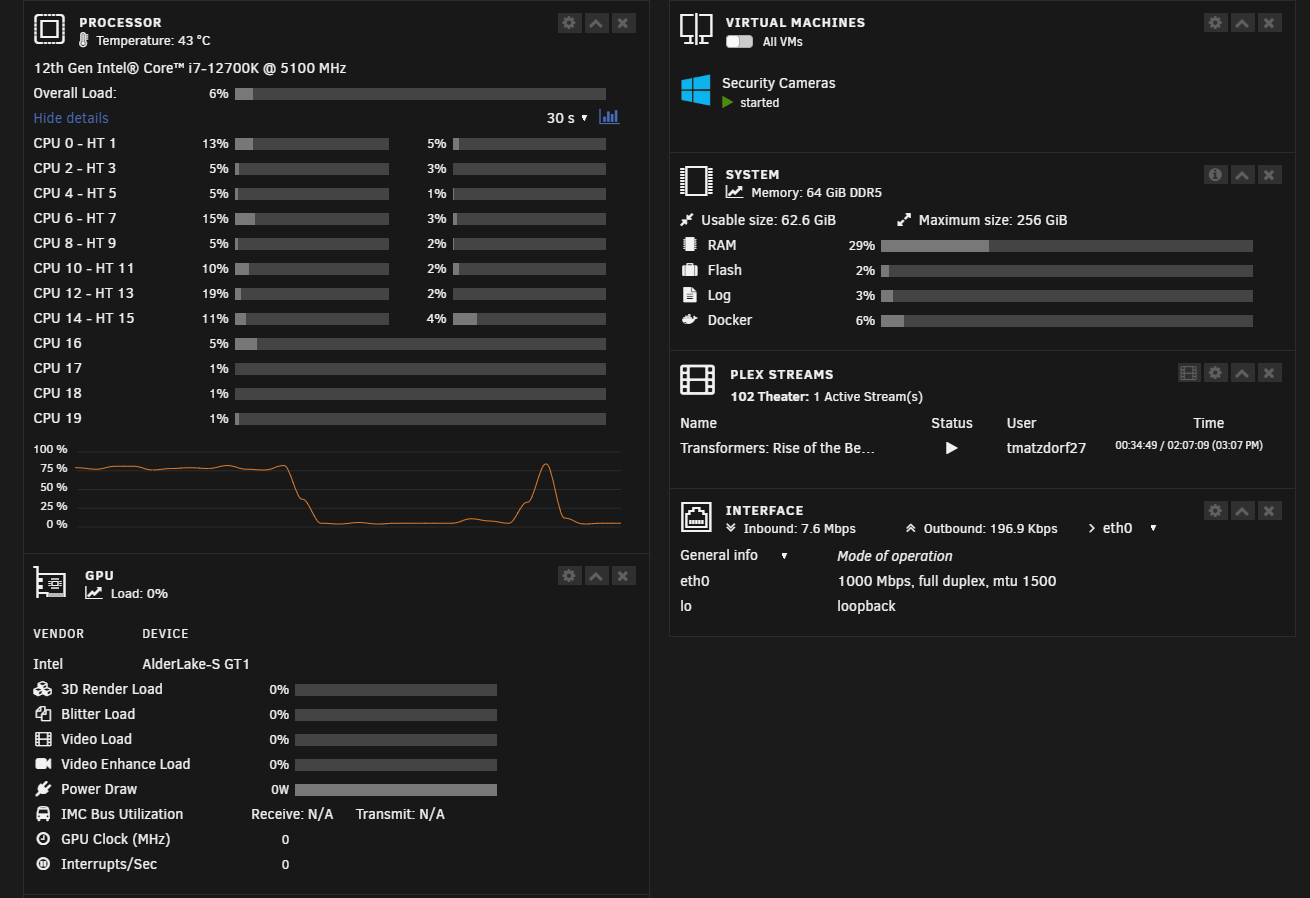

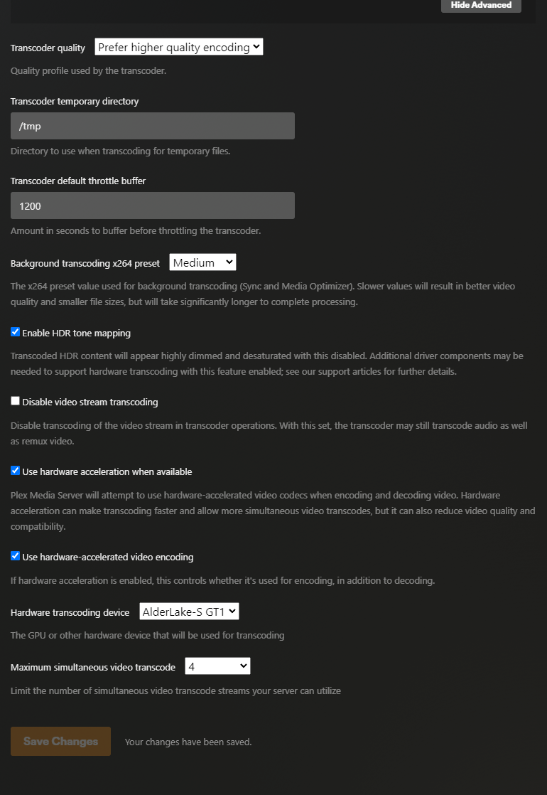

Having an issue with plex transcoding using an iGPU. I have a 12700K and i was utilizing the iGPU for transcoding. It was working a month ago with out issues. I was watching a movie today and noticed that the iGPU was not being used.  Pictures attached with current settings. Please let me know what i need to do to have this fixed.
looks like the linuxserver docker image is suffering the same issue, therefore i would suspect a plex bug, see here https://forums.unraid.net/topic/40463-support-linuxserverio-plex-media-server/?do=findComment&comment=1303054
your best bet is to raise this as a post on the plex forum and see what they have to say about it.
https://forums.plex.tv/c/plex-media-server/114
Did a little digging, this is an existing thread mentioning the broken HW transcoding for igpu:- https://forums.plex.tv/t/hdr-tone-mapping-with-hw-transcoding-not-working-for-12900k-cpu-on-pms-version-1-32-5-7210/845595/86
In short its a plex bug triggered by kernel version, but they dont know what they changed in their codebase :-), so the current options are:-
Disable HDR Tone-Mapping
Downgrade Plex to 1.31.3.6868
Downgrade Unraid to 6.11

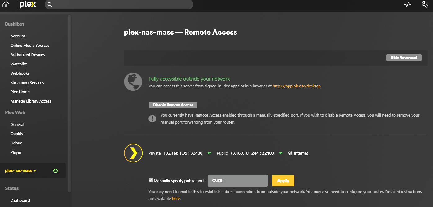

having some trouble getting remote access to work port for container was showing up as ???? so I added one. but I must have something wrong. Forwarded correctly on my router.
Plex is claiming it's happy now but actually moving any data
Command executiondocker run
  -d
  --name='binhex-plexpass'
  --net='host'
  -e TZ="America/Los_Angeles"
  -e HOST_OS="Unraid"
  -e HOST_HOSTNAME="nas-mass"
  -e HOST_CONTAINERNAME="binhex-plexpass"
  -e 'TRANS_DIR'='/config/transcode'
  -e 'NVIDIA_DRIVER_CAPABILITIES'='all'
  -e 'NVIDIA_VISIBLE_DEVICES'=''
  -e 'UMASK'='000'
  -e 'PUID'='99'
  -e 'PGID'='100'
  -e 'TCP_PORT_32400'='32400'
  -l net.unraid.docker.webui='http://[IP]:[PORT:32400]/web/index.html'
  -l net.unraid.docker.icon='https://raw.githubusercontent.com/binhex/docker-templates/master/binhex/images/plex-icon.png'
  -v '/mnt/user/datapool/':'/media':'rw'
  -v '/mnt/user/appdata/binhex-plexpass':'/config':'rw' 'binhex/arch-plexpass'
989a41b1eb395e113afb1f947f7d96db0317b90190e0d512bd3d69054d474fe8
Not seeing any errors though in plex log:
2023-09-09 13:58:03,390 INFO success: plexmediaserver entered RUNNING state, process has stayed up for > than 1 seconds (startsecs)

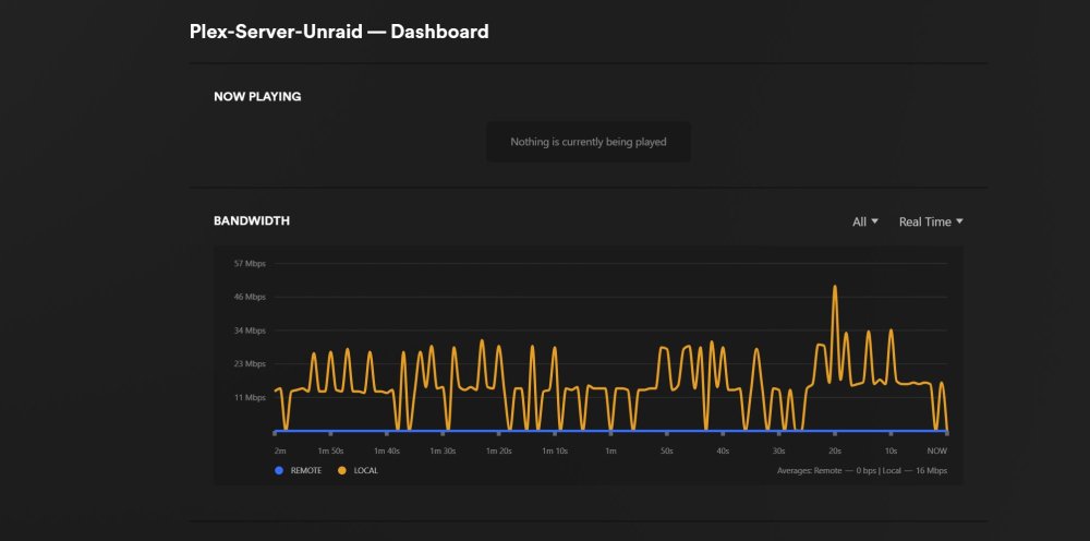

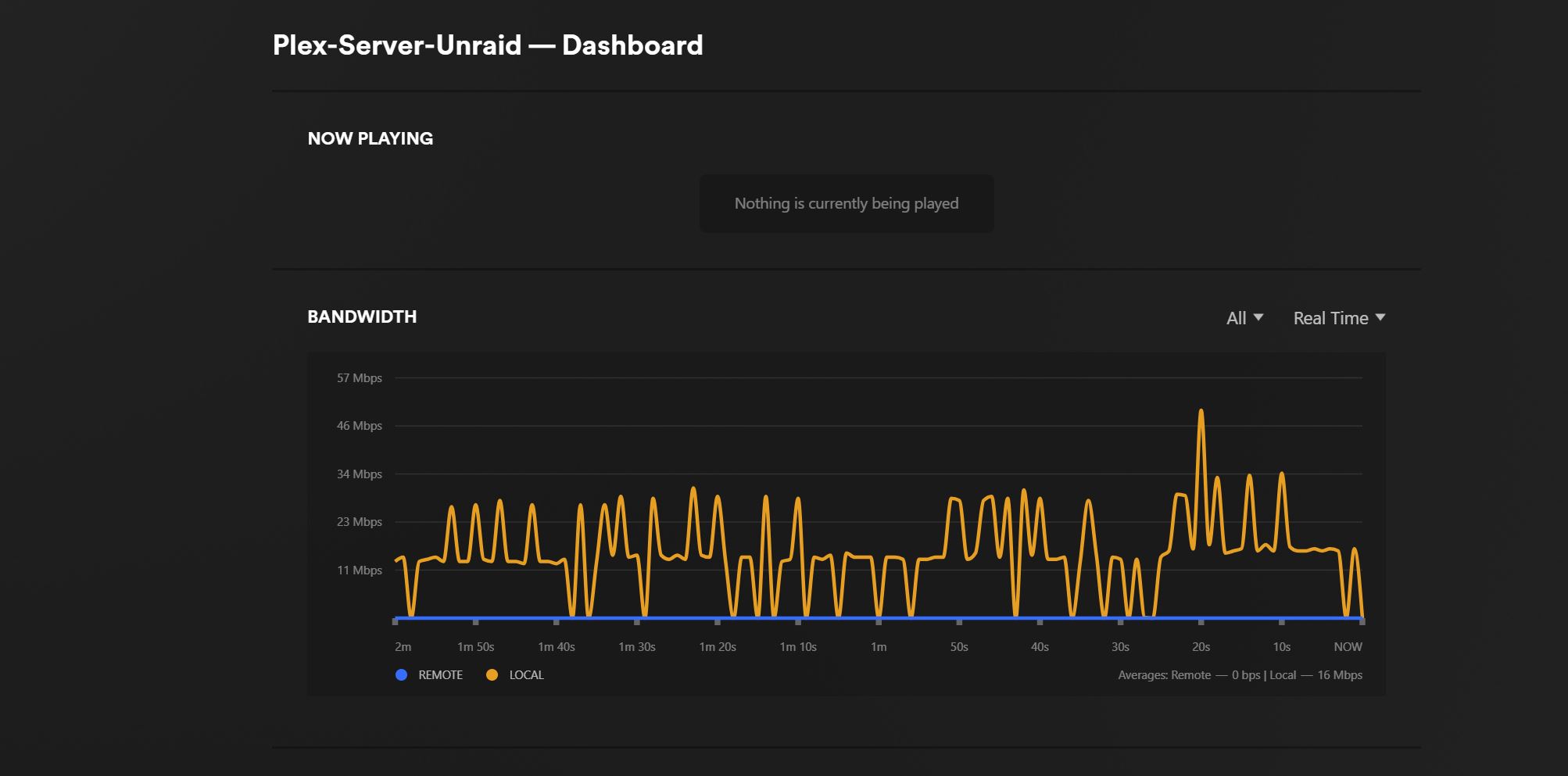

Do you know why if I direct play nothing shows up in the dashboard as playing. If I force transcode it shows up in the dashboard. This behavior did not exist when running under ubuntu. Clearly we can see the network is streaming something.
I can confirm if HDR tone mapping is enabled HW transcode is broken. If you disable HDR tone mapping HW transcode will work. I am using 13900 CPU with iGPU
Edited by xokia
So I reverted back to 6.11.5 and plex server just does not seem to work correctly. HW transcode does not work at all. You still have to disable tone mapping on 6.11.5 to get HW transcode to work.
If I direct play a 4k movie I see multiple issues.
    1. You are unable to skip forward. The display does not show the correct length of the movie
    2. The movie does not show up in the dashboard as being played as indicated in the above image where you can see network traffic is streaming but not status of movie.
