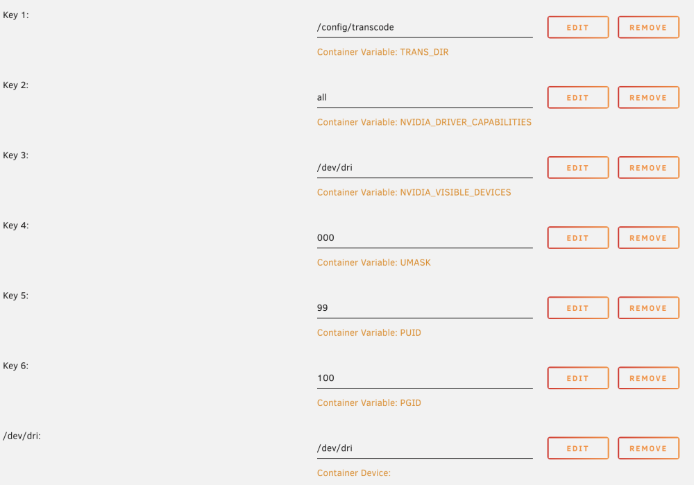

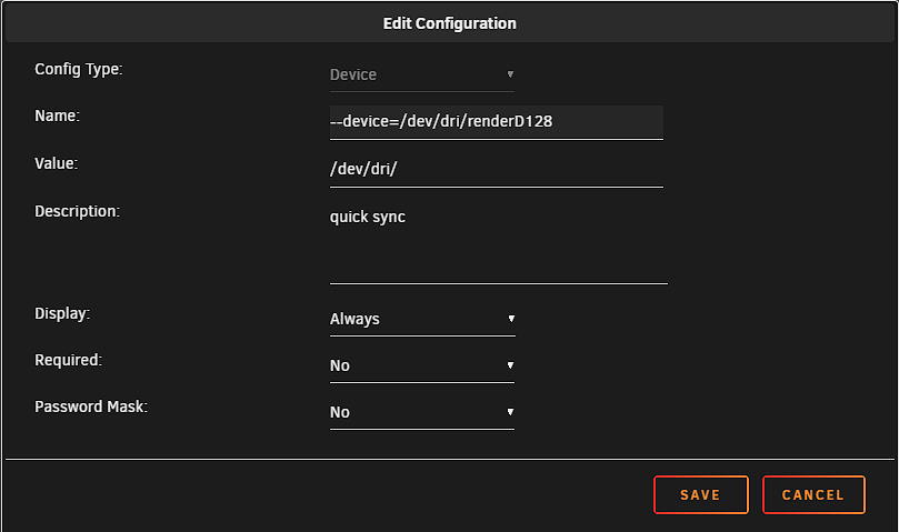

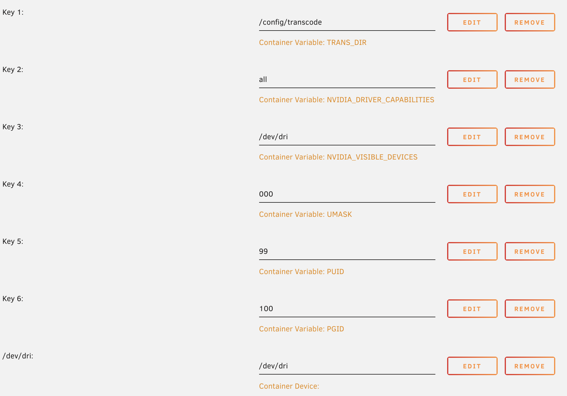

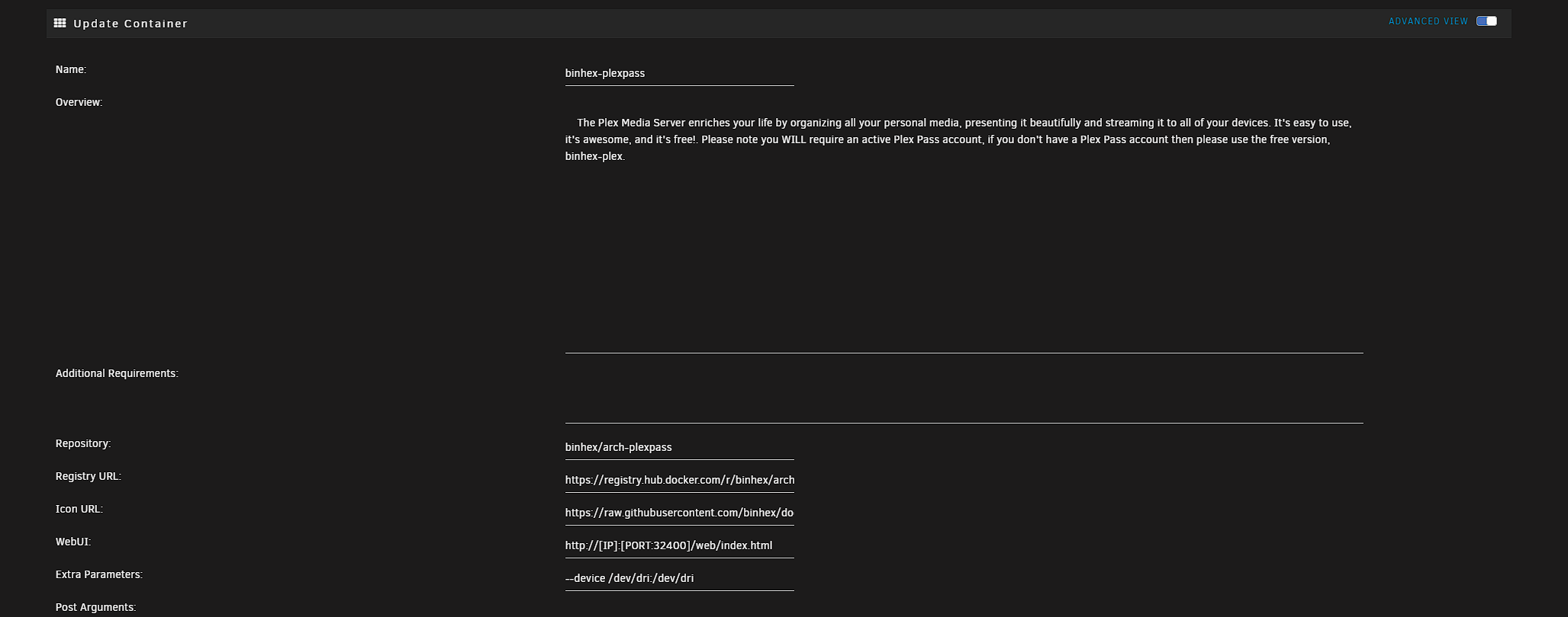

I use my intel iGPU for transcoding ill attach my setup to show you how mine is working. You have to select advance settings and include --device /dev/dri:/dev/dri in the extra parameters section.

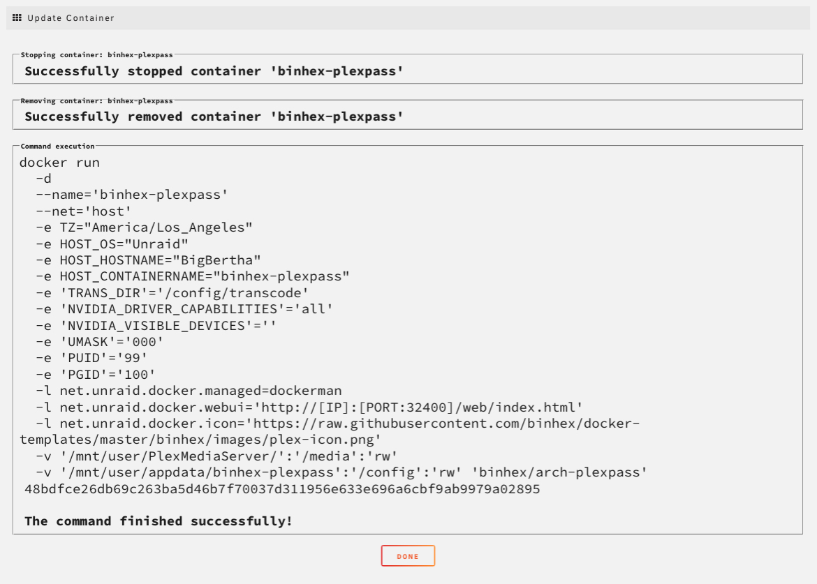

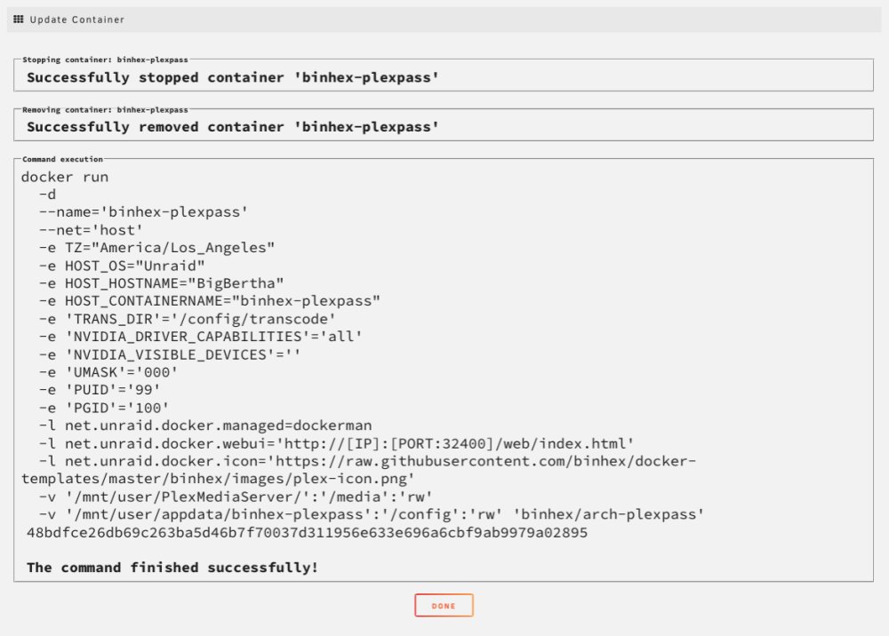

I was full of hope reading that...and sadly, it still didn't work.  To review:
- I've tried editing the Preferences.xml to have /dev/dri/renderD128 in it.  No love.
- I've installed the Intel TOP and GPU add in to see it on the dashboard
- I've mapped everything in the container as per your description above, exactly as you have it
When I run intel-gpu-top, this is what I get and it never moves, so it's not being used.  I'm baffled.
intel-gpu-top: Intel Alderlake_p (Gen12) @ /dev/dri/card0 -    0/   0 MHz; 100% RC6;  0.00/ 8.55 W;        2 irqs/s
         ENGINES     BUSY                                                                                          MI_SEMA MI_WAIT
       Render/3D    0.00% |                                                                                      |      0%      0%
         Blitter    0.00% |                                                                                      |      0%      0%
           Video    0.00% |                                                                                      |      0%      0%
    VideoEnhance    0.00% |                                                                                      |      0%      0%

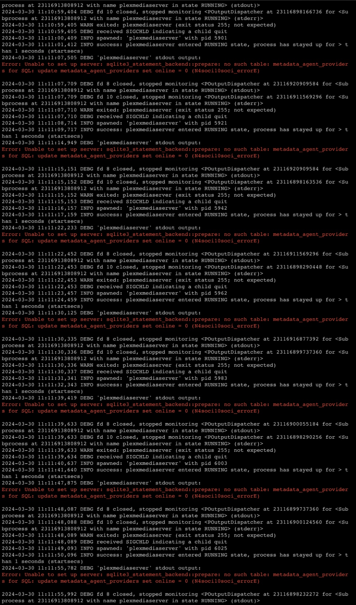

Upgraded unraid from 6.8.x to 6.12.x and went to update my binhex-Plexpass container and it failed, hitting done made it disappear, then when I went and downloaded from the app page it now doesn’t launch at all, I just get a blank white page when going to ip:32400, any ideas?
I think this had more to it with the old config before it disappeared on me

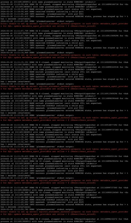

No, white screen when I go to it, here’s a screenshot of the logs, which might be the issue, I swear this wasn’t showing up before
I fixed the sql issues by rebuilding the database, then when starting plex I got this output "<Response code="503" title="Maintenance" status="Plex Media Server is currently running database migrations."/>" After waiting 10-15 minutes it is now fixed.
