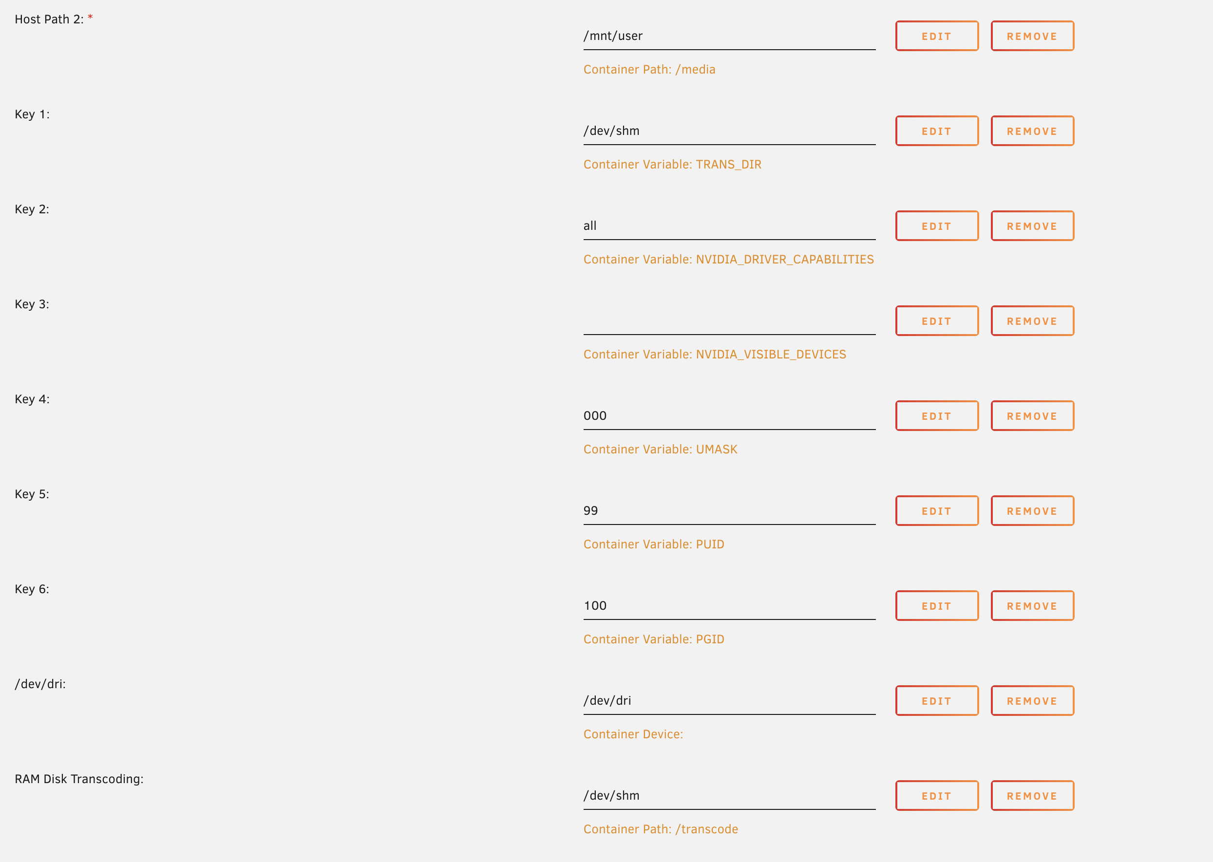

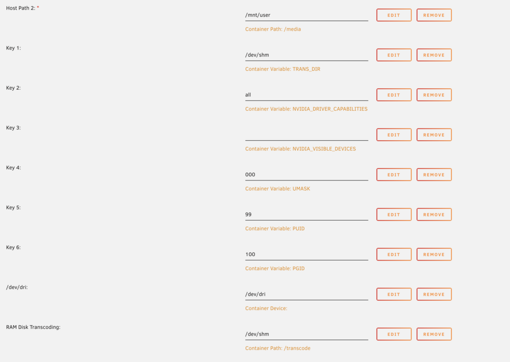

one thing i have spotted in your supervisord.log is this:-
2024-06-03 03:11:52.680887 [info] TRANS_DIR defined as '/dev/shm'
So using /dev/shm SHOULD be ok, do you have a bind mount for that, a screenshot of 'unraid webui/docker/plex/edit' container settings would help.
Yeah so that is incorrectly setup, you have a host path /dev/shm that bind mounts to /transcode, that is all good, you then set TRANS_DIR to point at the host path /dev/shm, this is not right, it should be pointing at '/transcode'.
Keep in mind env vars (container variables) are defined inside of the container, so you have to use container paths not host paths, the host path will not be accessible.
Thanks! I will change 'RAM Disk Transcoding' to '/transcode'. Just for reference, it was properly transcoding to RAM with the current settings.
To be honest, i dont see how that is possible with the settings you have, it would be of been transcoding to /dev/shm inside of the container, which for my containers is a measly 64MB in size, this MAY be the source of your disk space related issue.
