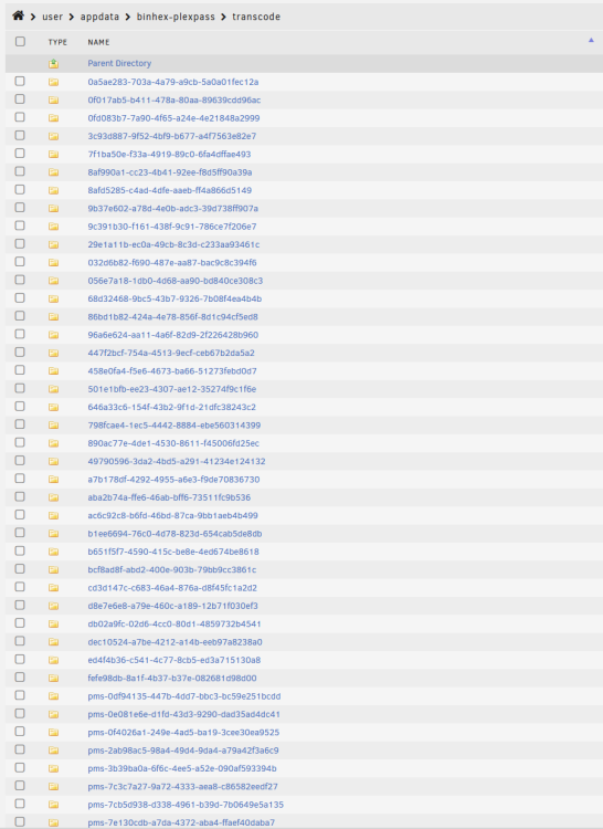

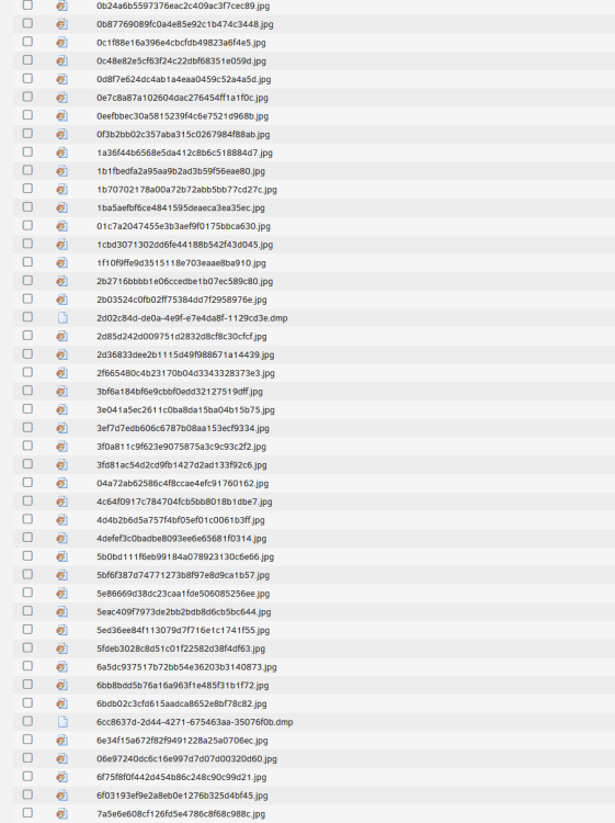

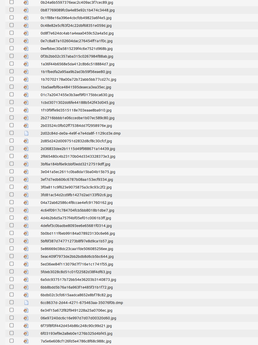

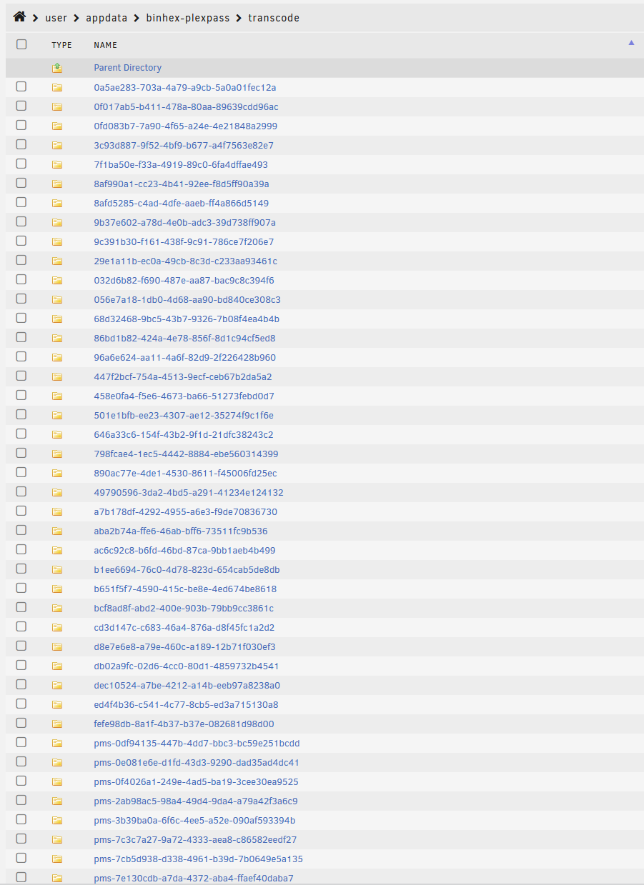

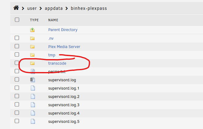

Can anybody tell me what these files are? They're in my Transcode folder and some folders are empty and others are filled with .jpg or .dmp files? Not sure exactly why they're here, any help is greatly appreciated.
Edited by GastonMT
added additional photo to show were folder that these files are located in is at
most probably crap left over by plex during transcode.
Awesome, thank you. Just wanted to make sure it was okay to delete. It's not taking up too much space but figured it might be worth it. Thank you again!

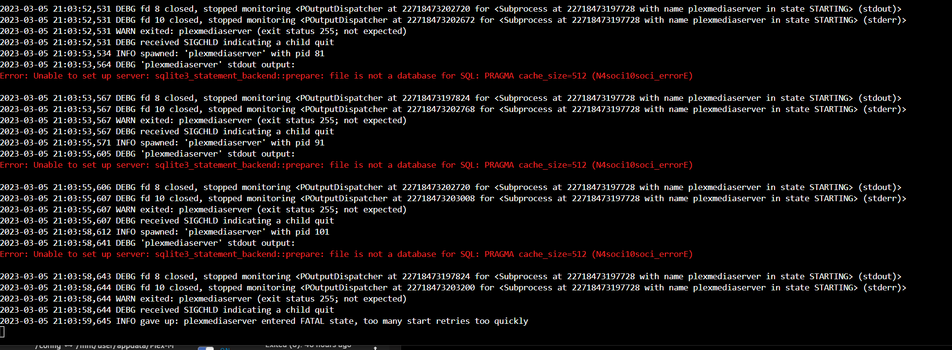

hey all,
in need for some help. my binhex-plexpass docker is not responding. when I click on the WebUI link it just times out and says This site can’t be reached. I've updated everything, rebooted. etc. Every other docker works fine.. it worked fine yesterday. My docker image said it was full, but i was able to clear that out and no longer have that error in fix common problems. No changes in network config.
sys dx attached. any help is appreciated.
Edit:
could it be something secure connection related? I had to renew my cert..
in the logs for the docker i found this:
Error: Unable to set up server: sqlite3_statement_backend::prepare: file is not a database for SQL: PRAGMA cache_size=512 (N4soci10soci_errorE)
bigboss-diagnostics-20230302-2024.zip
Edited by boianski
On 3/2/2023 at 8:25 PM, boianski said:
hey all,
Edit:
I could use some help, please.
10 hours ago, binhex said:
that looks like database corruption to me, see Q4:- https://github.com/binhex/documentation/blob/master/docker/faq/plex.md
I tried the troubleshooting steps nothing worked... so I decided to start fresh and delete the db..
now I am trying to add new libraries and I get the error : your changes could not be saved.

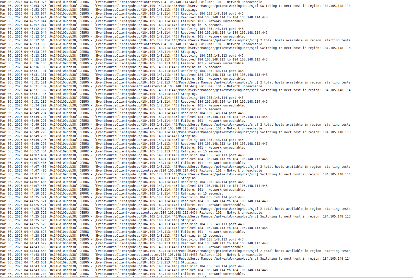

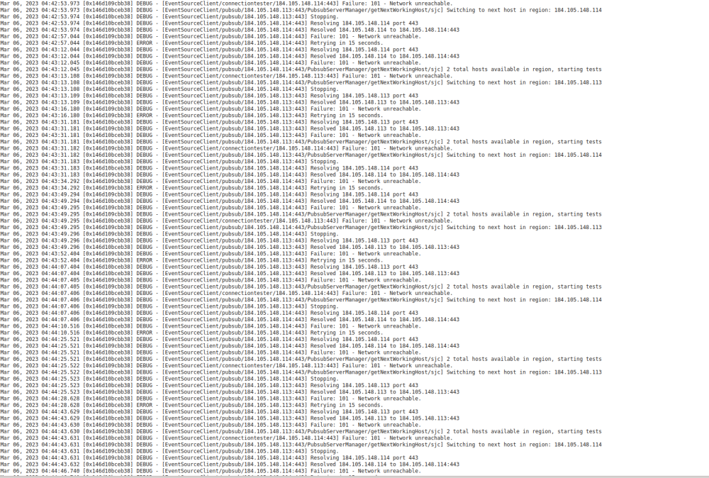

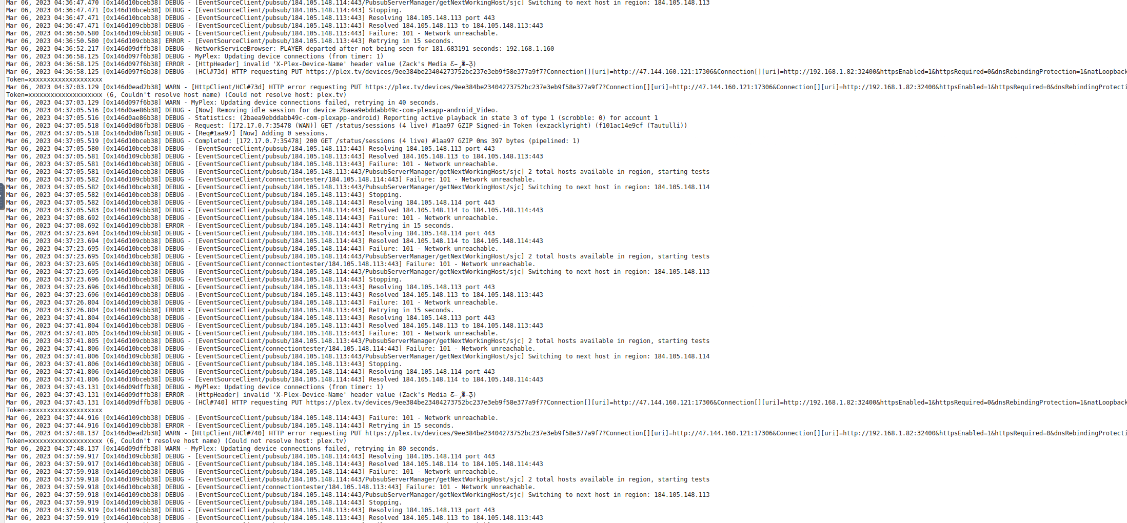

My plugin is started and also won't open the WEB GUI. Restarting it didn't help. Seems the preference xml file is corrupted.
Then just a lot of switch to next host in region, stopping, resolving, etc.

2023-03-08 10:01:06,763 DEBG 'plexmediaserver' stderr output:
Failed to load preferences at /config/Plex Media Server/Preferences.xml
2023-03-08 10:01:07,764 INFO success: plexmediaserver entered RUNNING state, process has stayed up for > than 1 seconds (startsecs)
2023-03-08 10:01:08,763 DEBG 'plexmediaserver' stderr output:
Tried replacing the .xml file with my backup one. But now I'm getting:
Error: Unable to set up server: sqlite3_statement_backend::loadOne: database disk image is malformed (N4soci10soci_errorE)
Update -- Repaired database and seems to be working now. F*#(!  power outages!
Edited by Supa
was that the root of your problem? I think the few re-boots during power on off did it for me..
I was not able to repair db and wiped all plex data and installed new container...
