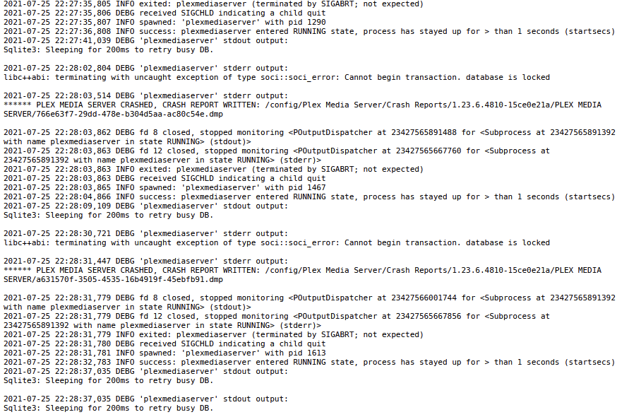

A couple hours ago my plex server started crashing and restarting.
Here is the log:
First problem I had had were I wasn't able to find the solution.
Plex log.zip
Here is the log:
I've got the same thing this morning and not sure what's wrong, let me know if you figure out the problem :)
Edit: looks like there may be an issue with Version 1.23.6.4810
https://forums.plex.tv/t/dead-in-the-water-after-version-1-23-6-4810-update-database-locked/730786
Edited by NomisNiksar
i would agree, def looks like a showstopper plex bug, be nice if they tested a bit more eh!.
ok if you cant wait for the fix and want to get going again then please roll back, instructions here Q5:- https://github.com/binhex/documentation/blob/master/docker/faq/unraid.md
Thanks, I have tried rolling back to a few previous versions now and but still getting the same issue. Hopefully they will release new update with fix soon.
a new version of plex pass has been released and built guys, give it a whirl and see if it fixes the issue.

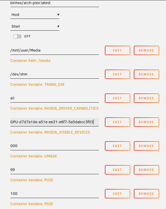

Is this the right place to post questions for support?
I recently moved Plex to Docker and it's been working great.
I have had several recent issues however with buffering whereas I didn't prior to migration.
I am trying to understand where the bottleneck (if any) is coming from.
From the Unraid Dashboard, all performance data seems to be in good shape.
Plex Dashboard shows all is well too.
Yet I have buffering, on DirectPlay as well as Transcoded content.
How do you suggest I work through to find the source of the issue that is causing buffering to occur?
I am attaching my Docker Config screenshot, a modified version of my Plex Dashboard, as well as a screen shot of my Unraid Dashboard while several streams are running if that helps.
Thanks for you insight!

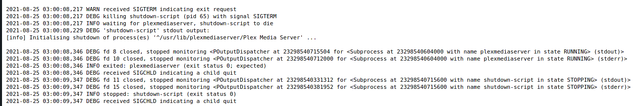

My container seems to be told to shut down every night at 3am.
Any ideas where this might be coming from and how I can prevent this?
I have been having problems with my plex container for ages now. It was originally causing problems a couple months ago, so I decided to nuke plex and rebuild from the ground up. It helped for a bit, but now the problems are back.
 If I shut down the plex container, it sends the signal for the shutdown script, and then never actually shuts down. Once this container is frozen, no kill or docker remove commands work to shut it down. It just hangs for good, and I need to do an unclean shutdown to get it 'fixed', until it breaks again within a few days.
Heres the end of the plex container log:
    2021-08-24 07:55:34,593 WARN received SIGTERM indicating exit request
    2021-08-24 07:55:34,594 DEBG killing shutdown-script (pid 65) with signal SIGTERM
    2021-08-24 07:55:34,594 INFO waiting for plexmediaserver, shutdown-script to die
    2021-08-24 07:55:34,605 DEBG 'shutdown-script' stdout output:
    [info] Initialising shutdown of process(es) '^/usr/lib/plexmediaserver/Plex Media Server' ...
    2021-08-24 07:55:37,608 INFO waiting for plexmediaserver, shutdown-script to die
    2021-08-24 07:55:40,611 INFO waiting for plexmediaserver, shutdown-script to die
    2021-08-24 07:55:43,614 INFO waiting for plexmediaserver, shutdown-script to die
If I try to do anything related to stopping the process, the server has issues. Stopping the array doesn't work, restarting/shutdown buttons don't work, only a hard power off will work. I had to do it last night as well.
I'm not sure if this behavior is a problem with the container, a problem with something inside plex going wrong, or a problem with unraid itself, but it only happens on this container (both plexpass and plex variant).
I have had a problem with my GPU dropping out of view of Unraid, and still do, so maybe thats related.
tower-diagnostics-20210826-0852.zip
