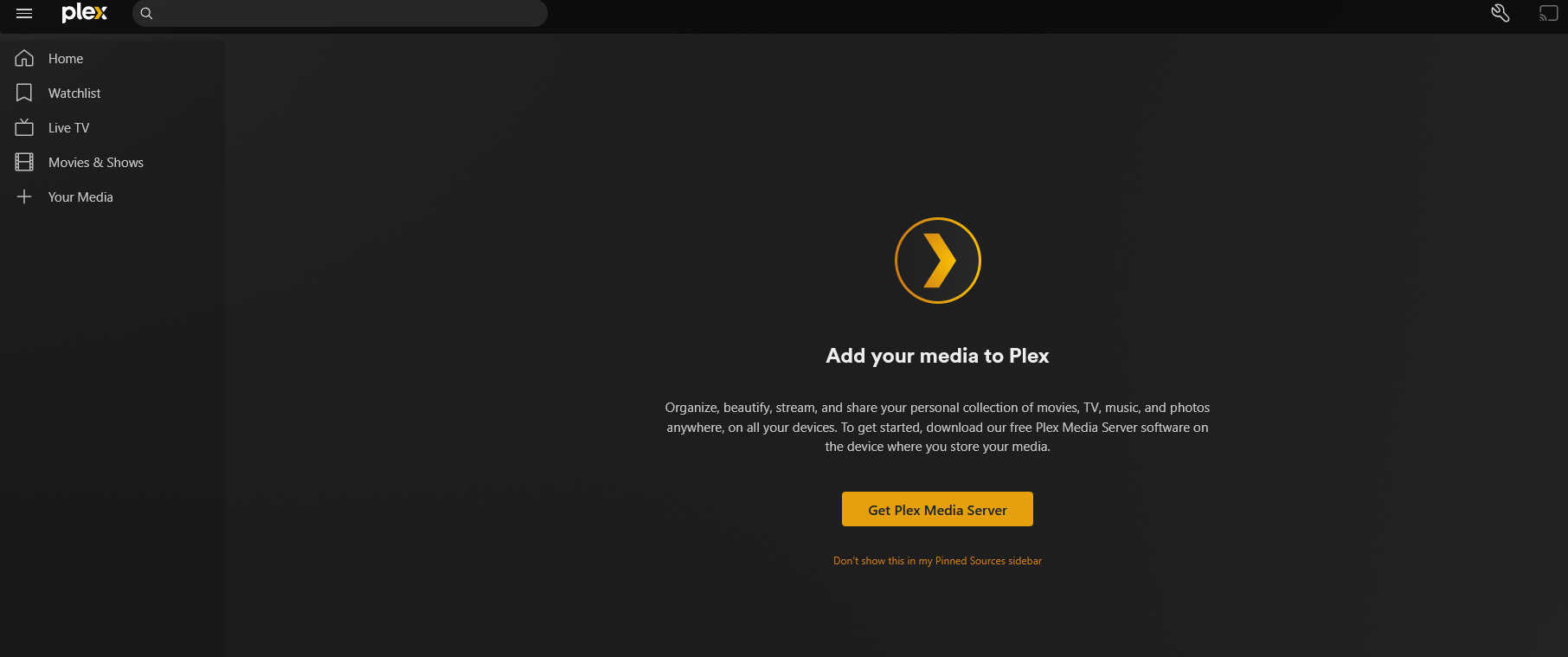

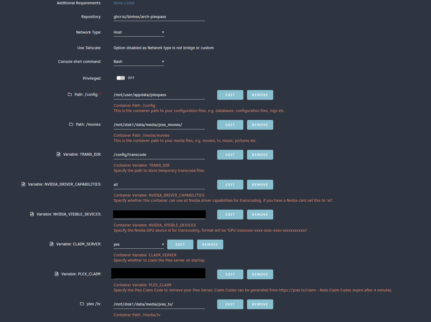

I'm possibly very stupid or have messed something up but when I click on "Your Media" after reinstalling this due to resetting my password, I get a link to "Get Plex Media Server"
I've added my claim key and my media under /mnt/disk1/data/media/plex_movies and /mnt/disk1/data/media/plex_tv like I had it before, but it seems the actual media player is missing? I feel like an idiot but I've had this set up before with no problem until the password fiasco and feel a bit dumb here.
Edit: I think I was just impatient. I came back to this after a doctors appointment today and it asked me to add my media. I guess the setup hadn't completed yet? Not sure, but this is resolved, sorry.
Edited by Taubin
Issue seems to have resolved

1 minute ago, Triplerinse said:
Check your settings and look for claim server. And try in an incognito tab.
If that's for me, I did try incognito and another browser (Firefox then Chrome). There aren't any server options at all.
Edit: I think I was just impatient, I came back after a few hours and the server asked me to add media. I guess I was just impatient, sorry about that.
Edited by Taubin
I have an issue where my plex server loses its claim after each restart. This started shortly after I did the reset password and log out of all devices - I had no issue with that process (other than needing to remember to use /web for my url). My docker container is a couple years old and I noticed the logs complaining about a CLAIM_SERVER variable not being set. I compared it to the current available version and added CLAIM_SERVER and it did not make a difference. I also notice the log complaining about:
2025-09-27 19:37:27,545 DEBG 'start-script' stderr output:
Error in command line:the argument for option '--userId' should follow immediately after the equal sign
I tried deleted my preferences.xml file but no change. I did try the official Plex version and I didn't seem to have an issue with that container but I don't want to switch (nor do I know how to safely switch).
Currently, I can either claim the server locally from /web or I can enter a new claim code but both options only work until the container restarts. I do get this in my logs but it doesn't appear with a new claim code entered:
2025-09-27 19:37:37,269 DEBG 'claim-script' stdout output:
[info] Claim response received:
<html><head><title>Internal Server Error</title></head><body><h1>500 Internal Server Error</h1></body></html>
You should set CLAIM_SERVER to 'yes' and put in a valid claim token for the value of PLEX_CLAIM only when you want to claim your server, once you have claimed your server then set CLAIM_SERVER to 'no', this will then stop the server from attempting to claim on startup.
