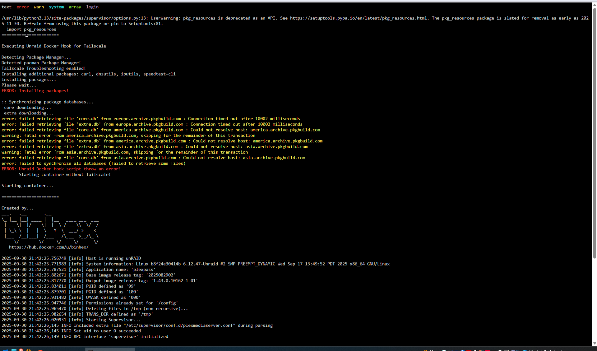

I setup tailscale and it was working, but now when I start the container it is unable to download the tailscale files.
I edited the pacman file with new mirrors I found, but still doesn't work. something about pkg_resources module is deprecated as an API

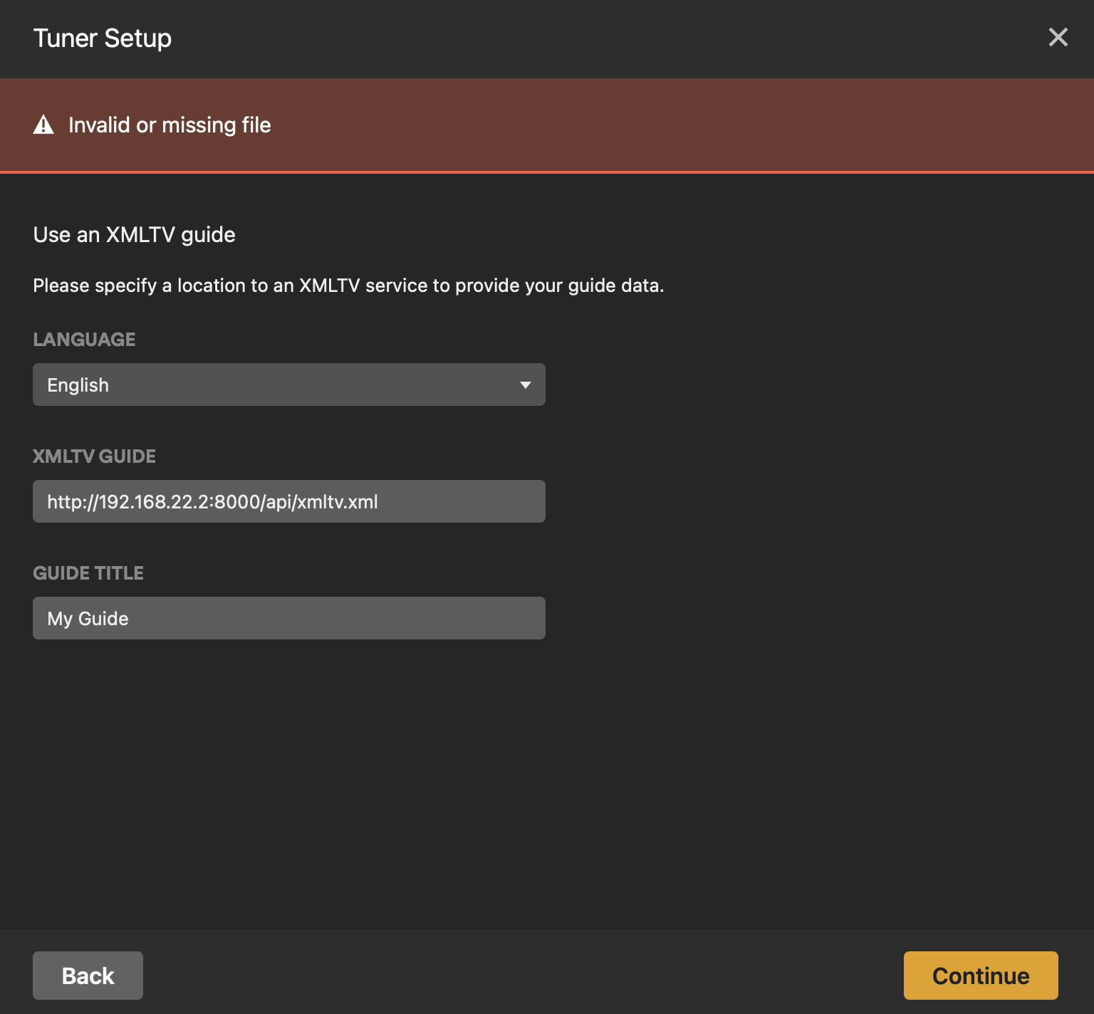

Having issue adding a network XMLTV file when adding a Tunarr or ErsatTV tuner
File works and have validated it
Any ideas?
Have tried both containers as Host & bridge and same error
Ok confirmed something wrong with the container that stops it loading local network XMLTV guides
Any ideas?
Anyone know how to get this to work with URLs with binhex containers? The official container works just fine using URLs in this field.
Any ideas?
I have this same issue and know the URL path works... I tested in the official Plex container with no issue.
Any ideas why binhex doesn't work with URLs here?
