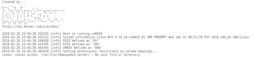

Im in the same boat. Just updated and get the following in the logs:
2018-02-26 13:57:20.068386 [info] PUID defined as '99'
2018-02-26 13:57:20.119727 [info] PGID defined as '100'
2018-02-26 13:57:20.195647 [info] UMASK defined as '000'
2018-02-26 13:57:20.235663 [info] Permissions already set for volume mappings
chown: cannot access '/var/lib/teamspeak3-server/': No such file or directory
e":"No such container: 61d96c22a624"}
Edited by wrightbaj
same - Seems like Permissions are screwed up
Exact same logs as this ^. Teamspeak starts but does not run successfully.
Edited by DaWord2011
additional information
Ditto.

@Big Wig
This was the first problem I was having setting TS back up yesterday.
Edit your docker for teamspeak and click the "Add another Path, Port, Variable or Device"
Config type: Variable
Key: TS3SERVER_LICENSE
Value: accept
But now we are having a permissions issue, so I'd say add the variable and you will have to wait for another update to fix the next issue.
im aware of the issue guys, but i have been ill so haven't got around to taking a look, i will try my best to get some time to fix it up guys, sorry for the delay.
