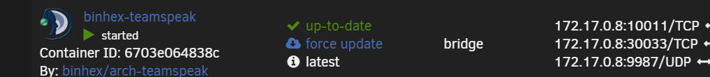

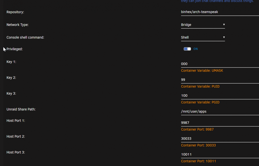

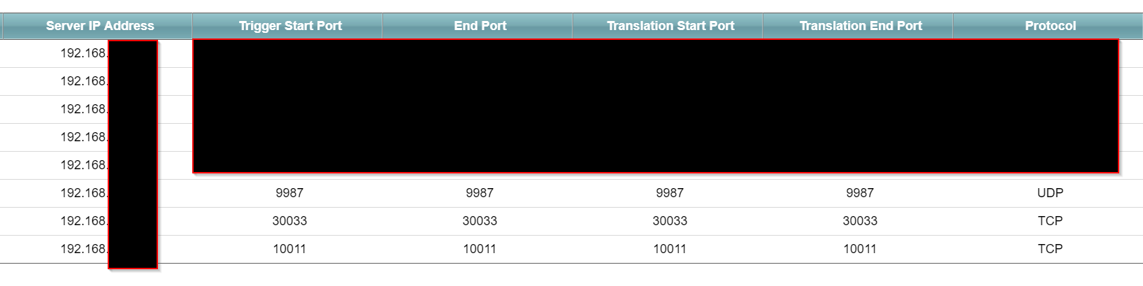

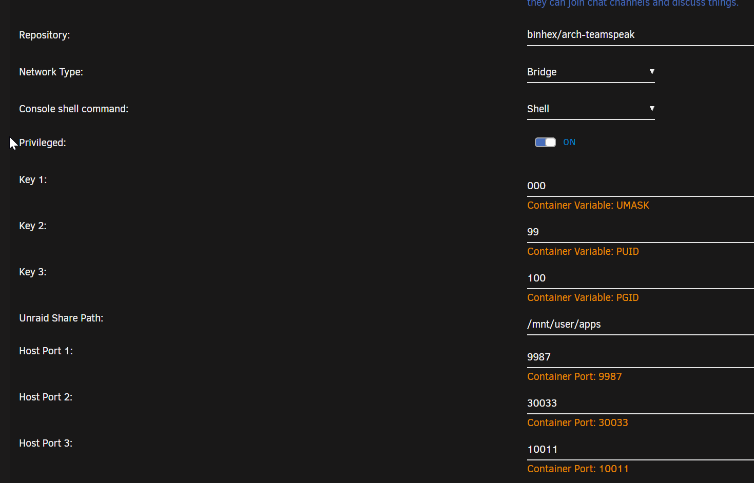

Hi Guys,
I can't forward the ports. I do have forwarding for several other dockers setup and running (via duckdns), but I just can't get that one to get going.
The server runs on local network, but can't reach it via duckdns or my public ip.
Any Suggestions?

13 hours ago, Jaster said:
Hi Guys,
Any Suggestions?
Would start by changing to Host mode instead of Bridge :) Got identical setup as you except I run Host mode, no issues.
Keep receiving the same error :(
You can reach it if you connect with your local ip? But not remotely? Are you sure it's not just from inside your network like others because of nat loopback?
Have you tried to reach it from outside your network? And if so, and it still dont work, then I would recommend you go over your port forwarding rules again.
My port forwarding seems fine and works for several other dockers, etc.
I can reach the TS server only from my local network using the ip, not the dns name of the server.
Sounds really weird. If you haven't tried it already, I would remove the docker, and all the files and start from scratch in Host mode. I just pulled another and it worked straight away. You are sure you can reach other dockers from inside your network with your external ip?
Some logs would also help, fresh supervisor, server log and run command to be safe :)
