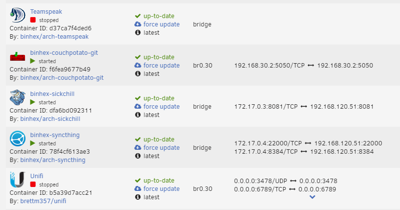

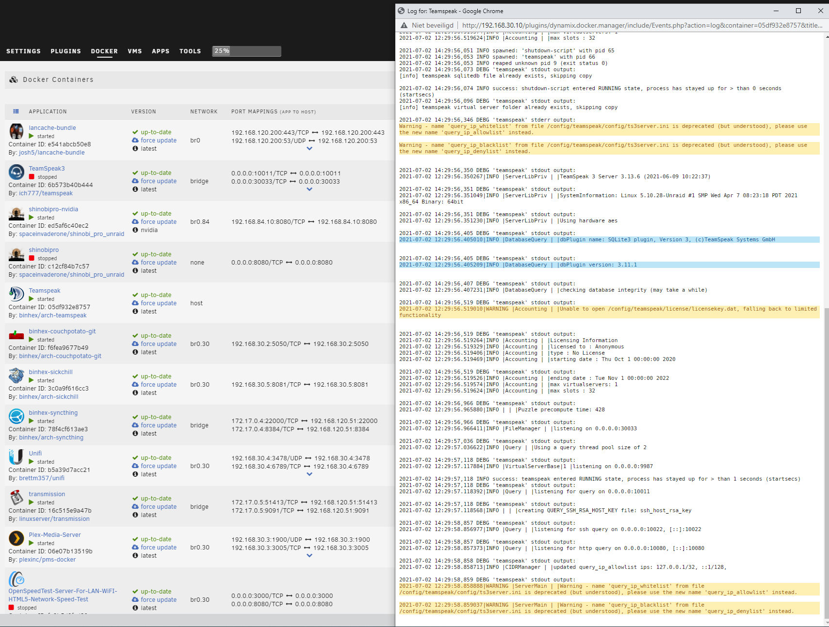

Caennanu Posted July 2, 2021 Share Posted July 2, 2021 Gday good sirs and madams, I have also posted in the engine section, as i believe it is more related to the docker engine than the docker itsself. but figured i would 'double' post it here too incase it IS related to the docker. Yesterday i migrated systems, from ryzen to epyc. And everything was fine. This morning i have issues with the TeamSpeak docker actually getting a mapping. It says it boots just fine, but if there is no ip assigned (host, bridge or manual) its obviously unreachable. Any idea if this could be part of the docker? I would atleast expect a 0.0.0.0:#### but not blank. Quote Link to comment
binhex Posted July 2, 2021 Author Share Posted July 2, 2021 1 hour ago, Caennanu said: It says it boots just fine it doesnt look that way from that screenshot, its stopped and thus 'but if there is no ip assigned (host, bridge or manual) its obviously unreachable.' is expected, especially as this container uses 'Host' network and thus no port mappings will be shown. Quote Link to comment

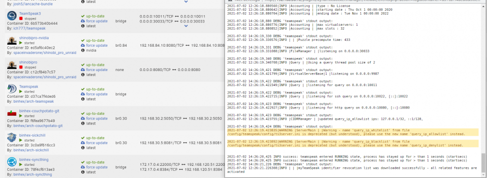

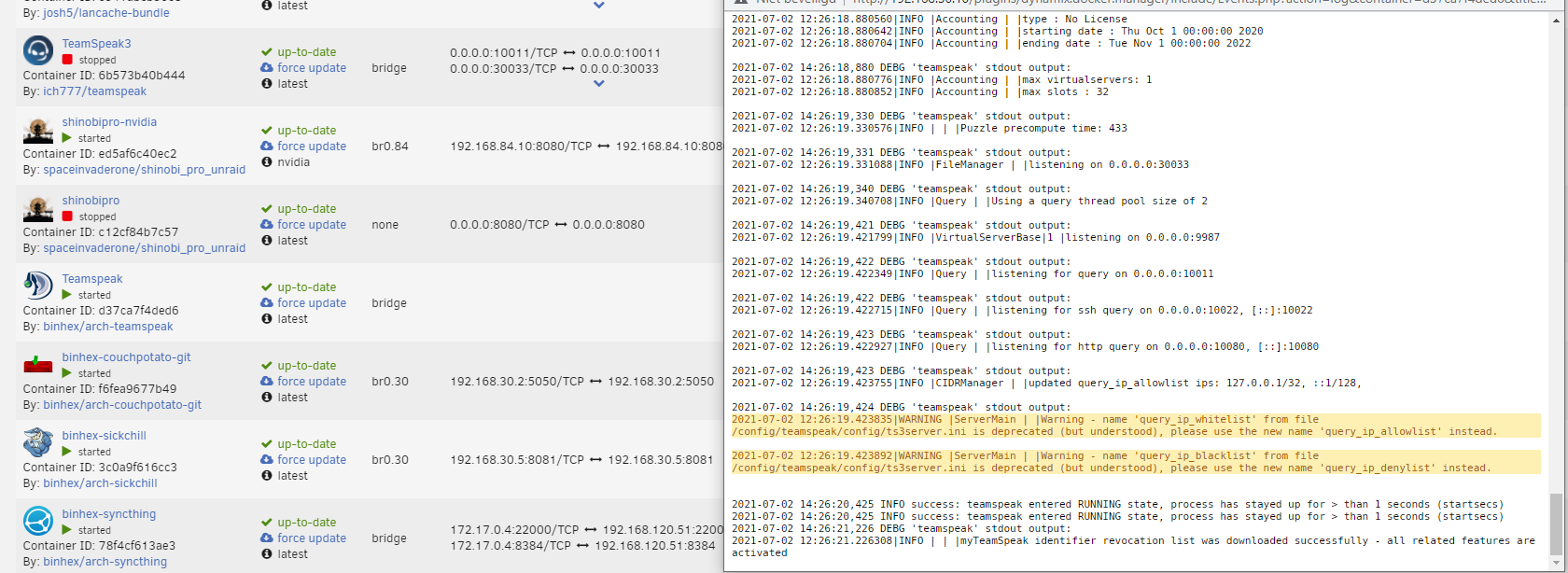

Caennanu Posted July 2, 2021 Share Posted July 2, 2021 allright, that makes sence from that screenshot. here a more proper screenshot, where i have the log open next to the field thats should ahve the port mapping. As you can see the other dockers who are running in bridge mode have atleast 0.0.0.0:### showing, while teamspeak (not teamspeak3) has not. Quote Link to comment
binhex Posted July 2, 2021 Author Share Posted July 2, 2021 2 minutes ago, Caennanu said: As you can see the other dockers who are running in bridge mode have atleast 0.0.0.0:### showing, while teamspeak (not teamspeak3) has not. correct, have a look at teamspeak this is using 'host' not 'bridge'. edit - looking at your screenshot i see something/somebody has changed it over to 'bridge' it should NOT be set to this, switch it back to 'host' Quote Link to comment

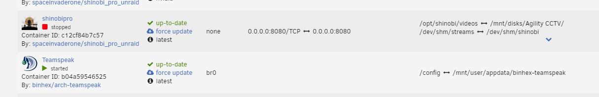

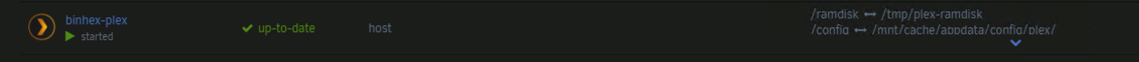

binhex Posted July 2, 2021 Author Share Posted July 2, 2021 so for example plex runs in host mode and looks like this when running correctly, note no ip's or ports are shown:- so teamspeak should look similar when in host mode (correct mode). Quote Link to comment

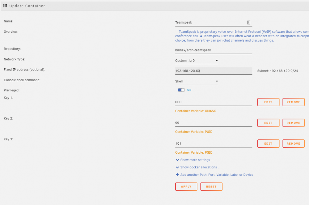

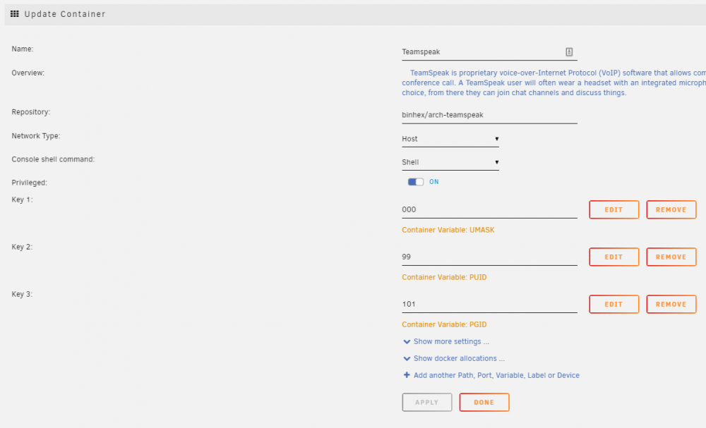

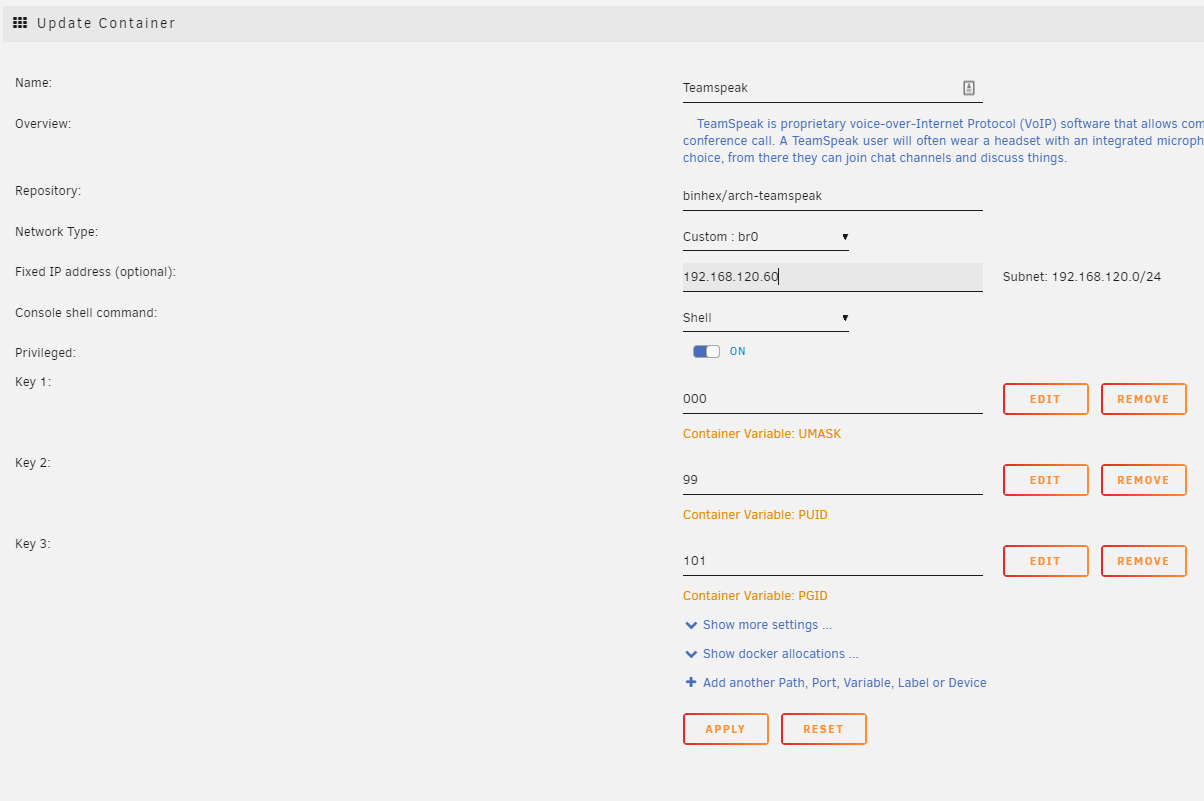

Caennanu Posted July 2, 2021 Share Posted July 2, 2021 no problem, too quick can happen when you're trying to solve something I switched it back to host, get the same issue. Field for port mapping stays empty. Even when applying a static ip. Quote Link to comment
binhex Posted July 2, 2021 Author Share Posted July 2, 2021 Just now, Caennanu said: I switched it back to host, get the same issue. Field for port mapping stays empty. Even when applying a static ip. ok so firstly you MUST set 'Network Type' to host, it cannot be bridge, or custom or anything else, just host, i see from your screenshot you have set it to 'Custom : br0' this is not correct, set back to Host. so in host mode you will not be able to define ports, i'm assuming that is what you mean by 'Field for port mapping stays empty.', this is expected. Quote Link to comment

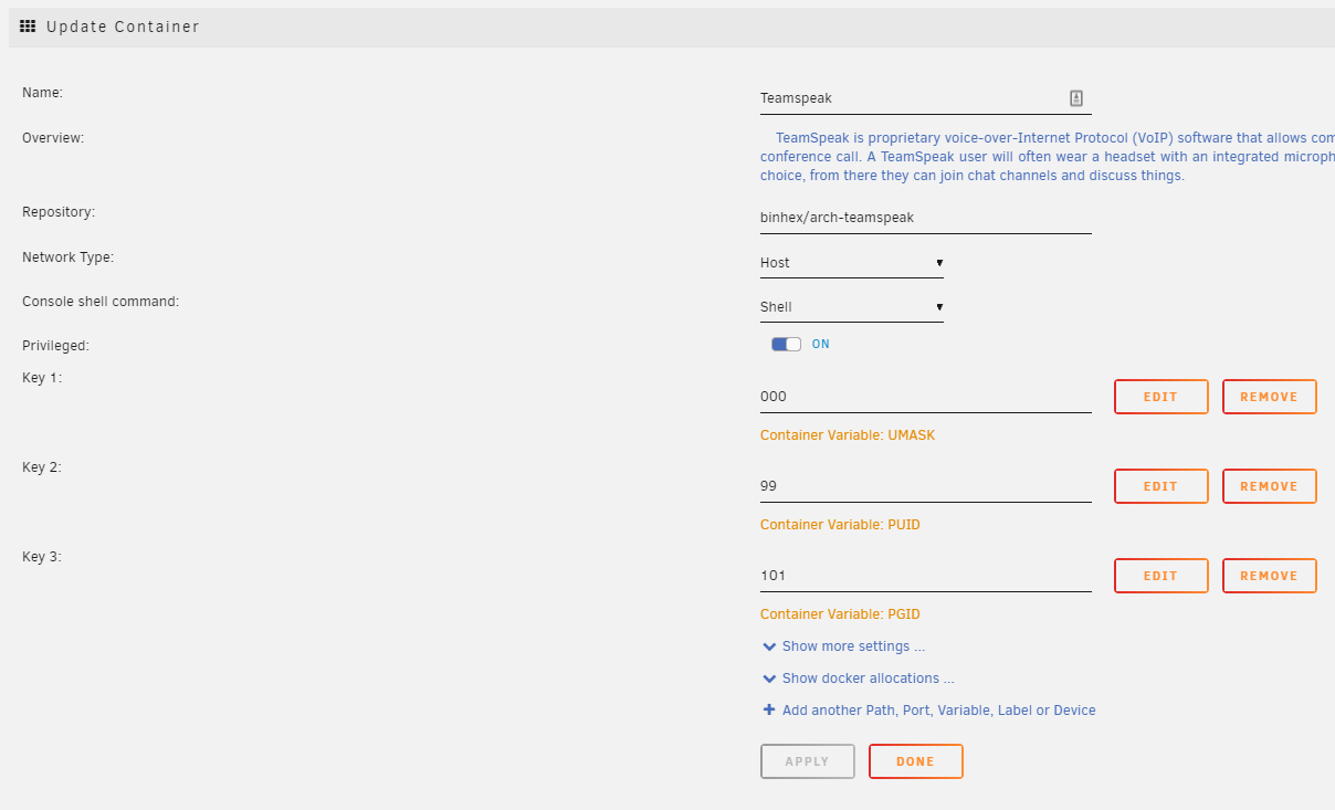

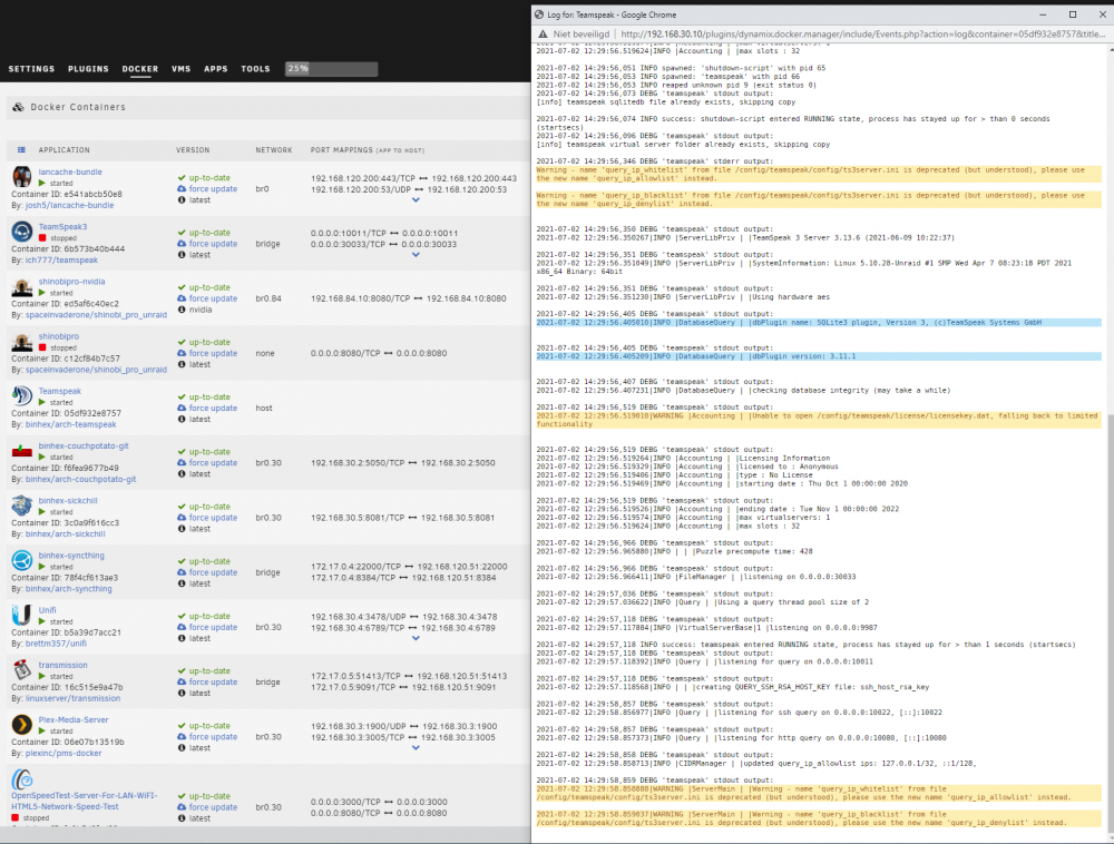

Caennanu Posted July 2, 2021 Share Posted July 2, 2021 Docker is set to host. That i can't assign port mapping i am aware, because its using the ports provided in the config file for the docker. But it should still read that from the port mappings field, which it did previously. Right now, since that part is empty, the docker is not reachable. Before today, it would state this when offline: and this when online But that is not happening anymore. Quote Link to comment
binhex Posted July 2, 2021 Author Share Posted July 2, 2021 10 minutes ago, Caennanu said: Right now, since that part is empty, the docker is not reachable. ok so the ports arent defined as exposed, so arent showing up in the unraid web ui, but they are still open, i would double check your teamspeak client and ensure its set correctly, i dont believe the issue is to do with the fact the ip and port is not shown in the unraid web ui. Quote Link to comment
