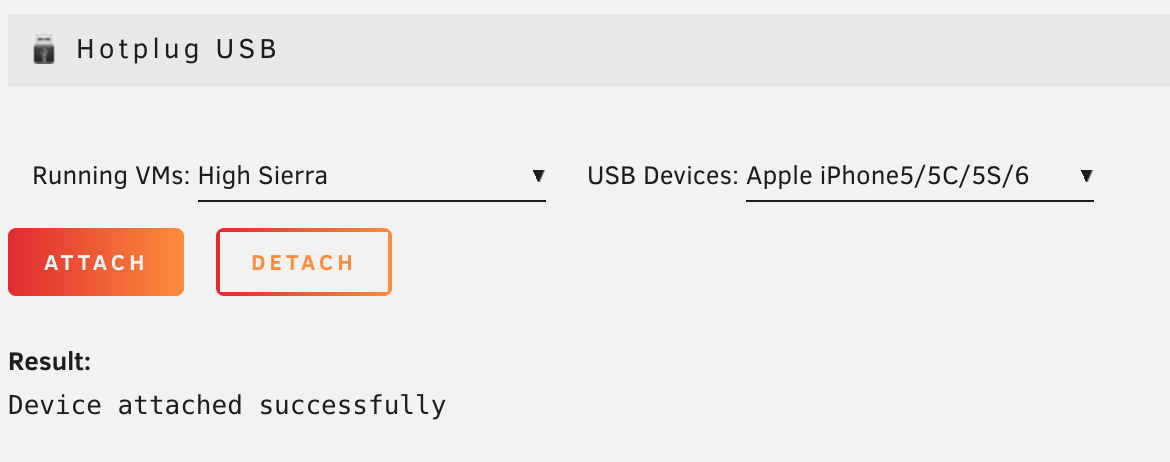

Hi, trying to use this plugin to pass an iPhone XS through USB to a macOS High Sierra VM I created using @SpaceInvaderOne's tutorial.
On the VM page the phone shows up in the dropdown as an "iPhone 4/5/6" and says "successful" when passing it through however it doesn’t show up in the macOS in iTunes?
Iphone was the main reason i wrote this plugin. You have to attach/detach multiple times for Iphone to work.
Thanks for the quick response @bshakil! Is there any specific order/steps that I need to follow when attaching/detaching?
I've tried several different incantations numerous time with no success. Tried different USB ports as well... the phone shows the charging symbol but doesn’t want to connect.
