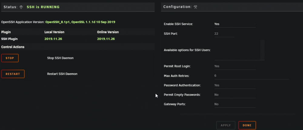

Just to clarify, this plugin wasn't tested with the latest RC right?
Cause it seems to not respond as it should.
If you set: PASSWORD AUTHENTICATION on "no" it doesn't change a thing.
No I have not tested with the latest RC yet. I need to double check that the plugin script does a full restart of SSH after the settings are changed. If not then it could explain what you are seeing. I'll check in a bit.
Looks like I was overzealous in my "fix" to protect folks from turning off password authentication by accident. I am no longer able to turn it off either.
I also noticed I have 3 entries for PasswordAuthentication in sshd_config. I'm not sure if that is also a bug or a left over from something earlier, or, I suppose, both.
I'll work on a fix today. Thanks for letting me know.
New update fixes some issues bugs introduced with 2019-11-10 causing changes made in the UI to be ignored.
In addition, The part of the script which updates /etc/ssh/sshd_config (and then copies to /boot...) was updating block comment lines which happened to have Keywords in them which are maintained by the plugin.
In particular are the keywords "PermitRootLogin"and "PasswordAuthentication".
It is very likely you will now have 2 lines with PRL and 3 lines with the PA setting.
The plugin will update all of them to the value set in the UI and sshd_config will function correctly but you should consider fixing the sshd_config.
To do so you will need to manually edit the /etc/ssh/sshd_config file and then copy it to /boot/config/ssh/sshd_config. I know the whole point of the plugin is to avoid such steps and I apologize for the problem. [ lame excuses for why this happened removed by author ;) ]
There was a bug introduced with the prior version. (2019-11-10). It should be fine now with 2019-11-26 or later

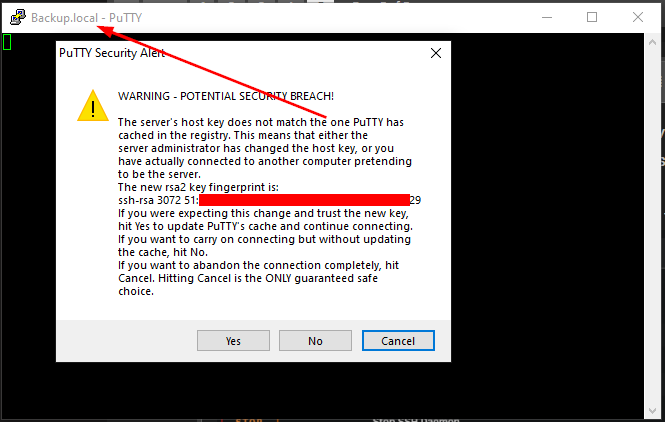

As noted in my rogue General Support form post, I'm having issues accessing my Backup server via SSH now that I've rebuilt the USB stick for the server. I started with a clean install and added all plugins/dockers 1 by 1 until everything was reinstalled.
I can log into the WebGUI, but I cannot SSH in. I do have the plugin installed and SSH is enabled, allowing root logins:
image.thumb.png.f5ebd9e1f84909e9c0171e34055e1ba6.png.726967eb074df086351993a74f469cfb.png
This is what I get when I try to login via SSH:
I click "No" to continue without saving the fingerprint (for now), then login with "root" and my password and get a simple "Access denied" response.
I would expect the fingerprint to have change after a rebuild of the flash drive, so that doesn't surprise me. What does surprise me is that the server name is now "Backup.local" - it's always reported just "Backup" in the past. I opened this PuTTY session by clicking on the same old saved session that I'd used before the rebuild. I've also tried connecting via IP and get the same response
Diagnostics are from my OP in the wrong forum - I've installed the preclear docker since then and currently have a drive preclearing. I wouldn't think that would impact the data in the diagnostics significantly since I had the issue both before and after installing the docker, but I can post new diagnostics if that would be preferred.
I'm sure there's something in the plugin that I have misconfigured. I put this server together as a backup 9-12 months ago, though, so I don't recall what configuration changed I may have made, and, of course, I failed to screen shot everything before starting from scratch... :/
backup-diagnostics-20200104-1517.zip
@itimpi in response to your question on my OP:
SSH is working just fine on my main server with the plugin and 6.8.0, so I don't think there are any compatibility issues on the Backup server between the plugin and 6.8.0. I haven't tried without the plugin on my Backup server, but will go ahead and do so, just because... you never know...
Nope, same "Access denied" with or without the SSH Plugin installed.
Under Settings -> Management Access -> Local TLD, it looks like that is set to "local". Mine is empty, although I don't really know what the downside is of "local" vs empty. I wouldn't expect either setting to prevent you from using SSH though
Interesting, I don't think I'd ever looked there. Both my main and backup servers are set to "local". I'd never noticed that it said that in the title bar of the window because it only shows that when I'm logging in. Once logged in it shows "< user >@< server >" and there's no TLD displayed at all. Thanks for pointing that out!

Try the following.
1. Uninstall the SSH plugin, if not already done
2. Delete (or rename) the folder /config/ssh on your USB device
3. Reboot your server. This will create automatically a new set of ssh keys
Edited by bonienl
