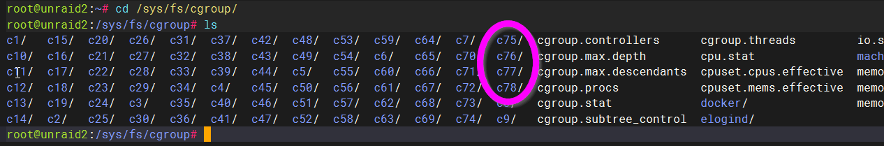

after some weeks  unraid gets problems  with the error  "elogind-daemon Failed to create cgroup xyz No space left on device" and if the error happens, it could be that I can no longer start (certain) docker containers. But that's just a guess. Unfortunately, I no longer have an Unraid installation in this state.
I have restarted unraid and I am now at c78 :)

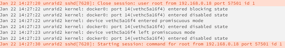

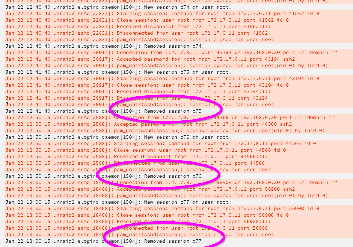

1 hour ago, andber said:
same here unraid 6.12.6
on the drive:
in the log:
but the session persists ....

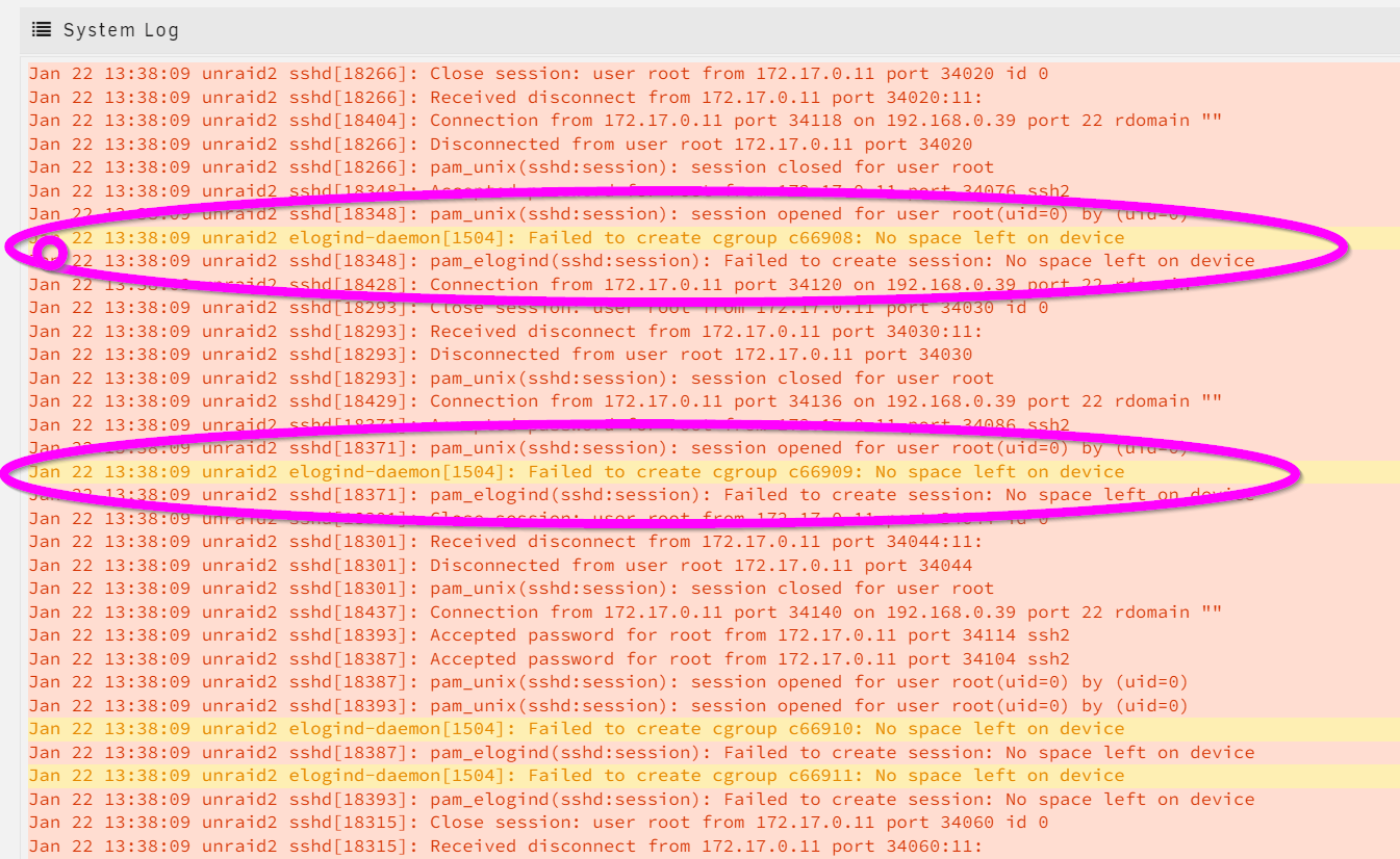

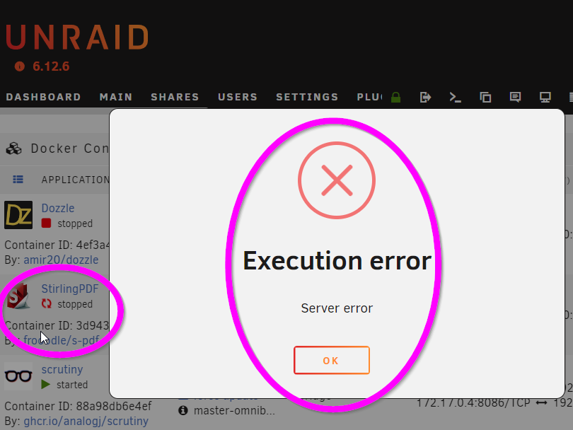

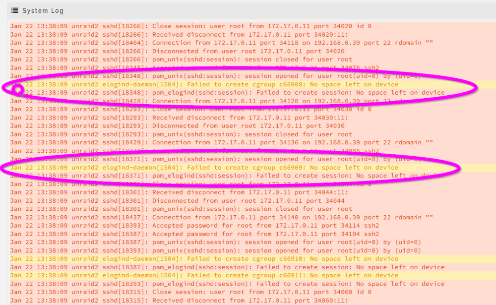

Ok, I have tried it again. I get the warning no space left on device from c65514:
Jan 22 13:37:52 unraid2 sshd[30614]: Starting session: command for root from 172.17.0.11 port 36846 id 0
Jan 22 13:37:52 unraid2 elogind-daemon[1504]: Failed to create cgroup c65514: No space left on device
Jan 22 13:37:52 unraid2 sshd[30694]: pam_elogind(sshd:session): Failed to create session: No space left on device
.... and I can confirm this with the dockers -> A docker that was not running when no error appeared in the log can no longer be started after the error appears. Before that it starts without problems.
Do you have diagnostics when that occured?
