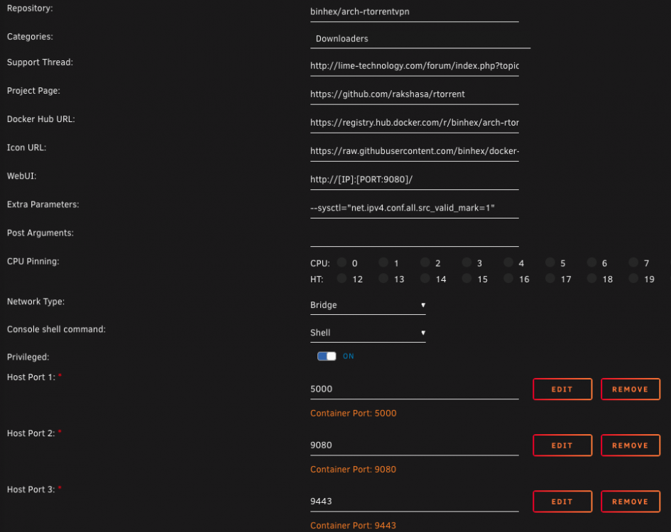

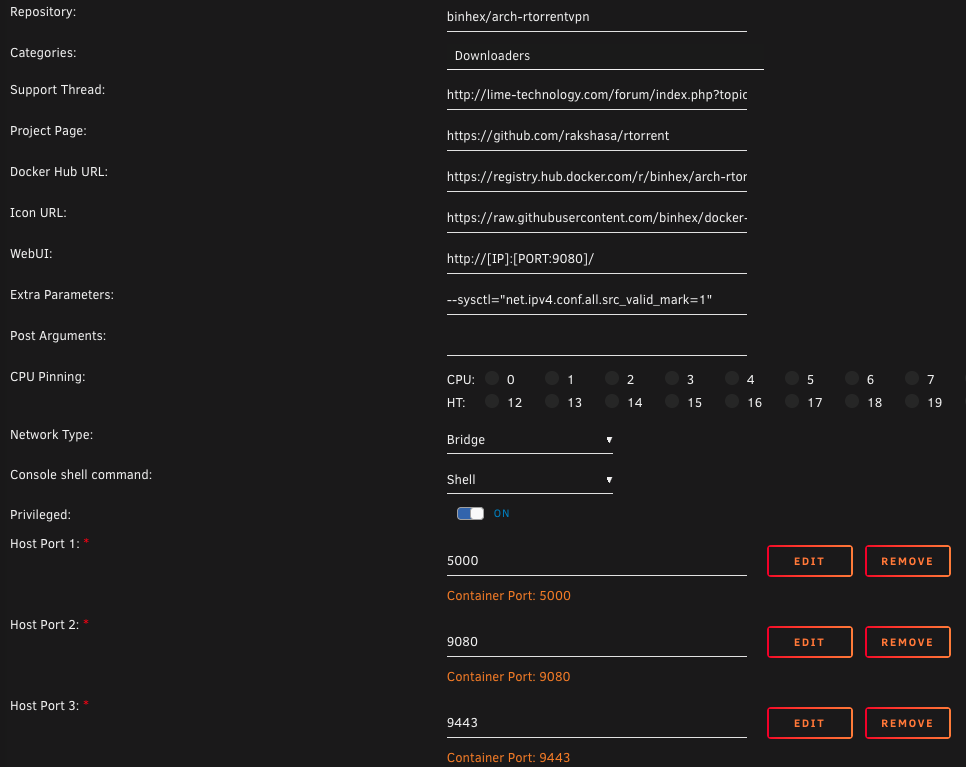

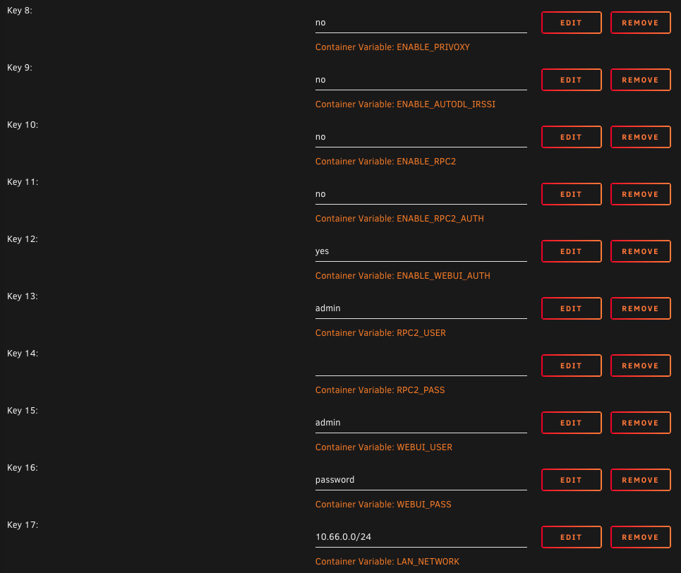

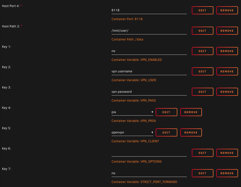

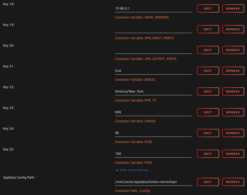

I just set up this container for the first time in order to replace the Linuxserver ruTorrent container since it is no longer being updated, however I've run into an issue and can't seem to access the WebUI. I've attached my log here, however it never seems to get past the stage "Setting permissions recursively on volume mappings..."
My settings are very basic as I'm not currently setting up any VPN and am only trying to access ruTorrent locally. You can see my settings below. Any ideas?

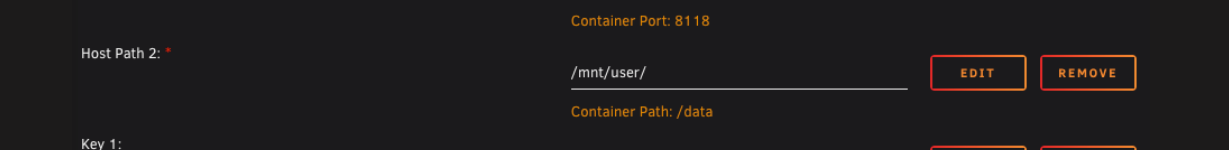

this is why:-
so it will recursively be setting permissions on /mnt/user, which will obviously take some time!, edit this path and change it to a more specific folder, /data is used to store downloaded data, so something like /mnt/cache/appdata/downloads/ would be a better fit and should get things running for you.
5 minutes ago, binhex said:
this is why:-
Ah okay, I just assumed this was used to map volume access, I didn't realize it was specifically the download directory. Thanks!
