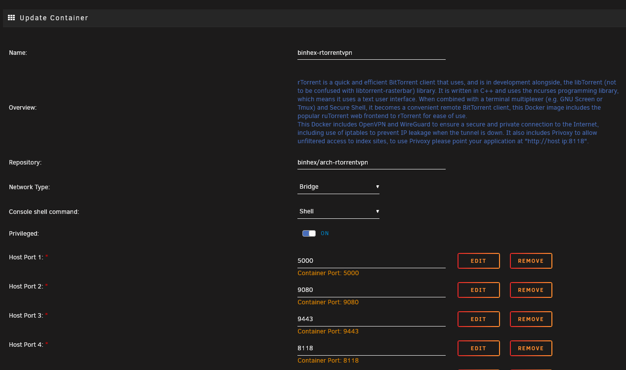

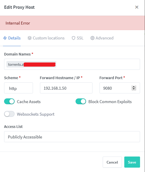

Any reason why this seems incompatible with Nginx Proxy Manager?
Basically I have this running with the following port and IP settings:
1644036142_Screenshot_2021-03-23TowerUpdateContainer.thumb.png.01fa4f89ced510713913f1d0cd69512b.png
This means it runs on 192.168.1.50 which is the same local IP that my Unraid control panel is accessible by.
The problem is that Nginx Proxy Manager really seems to like it more when each container has its own IP address and the interface for each container is my br0 adapter. Eg. Hedgedoc @ 192.168.1.60, Ubooquity @ 192.168.1.61 etc.
When I try to use any other network interface for this container, the webui won't even load through its local IP. The webpage just stays loading forever. Though the log shows that the container is definitely running in the background.
The thing is, when using bridge Nginx Proxy Manager throws all sorts of errors. Firstly, it can't even determine the status of the container and secondly throws internal errors:
185055844_Screenshot_2021-03-23NginxProxyManager.png.12057f95e7e7b2c5d1a42a9fc446f49d.png
54028711_Screenshot_2021-03-23NginxProxyManager(1).thumb.png.fdc02c0c4e4d0477a0d93eef5e79eb42.png
I'm using the Pivoxy function if that matters. Nothing changes either if I choose to try and port forward 9080 or 9443 either. Even with the CNAME set up properly and all my other services/containers working via reverse proxy. For this container the page just doesn't load no matter what.
Here's my port forwarding setup:
415881654_Screenshot_2021-03-23ASUSWirelessRouterRT-AX88U-VirtualServerPortForwarding.png.6960d651d287493036bbddbaad7e6d18.png
Does anyone have any idea what seems to be the problem?
