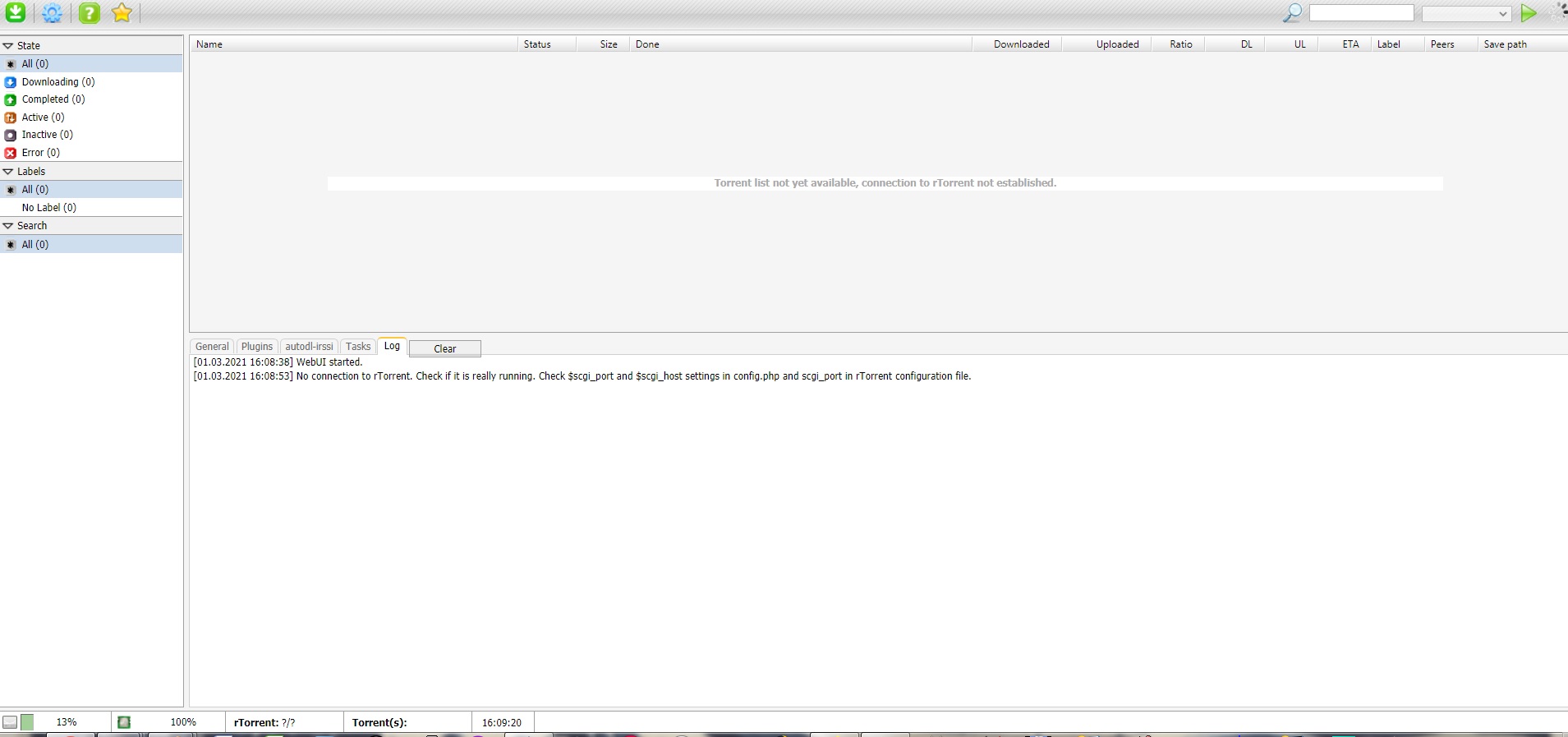

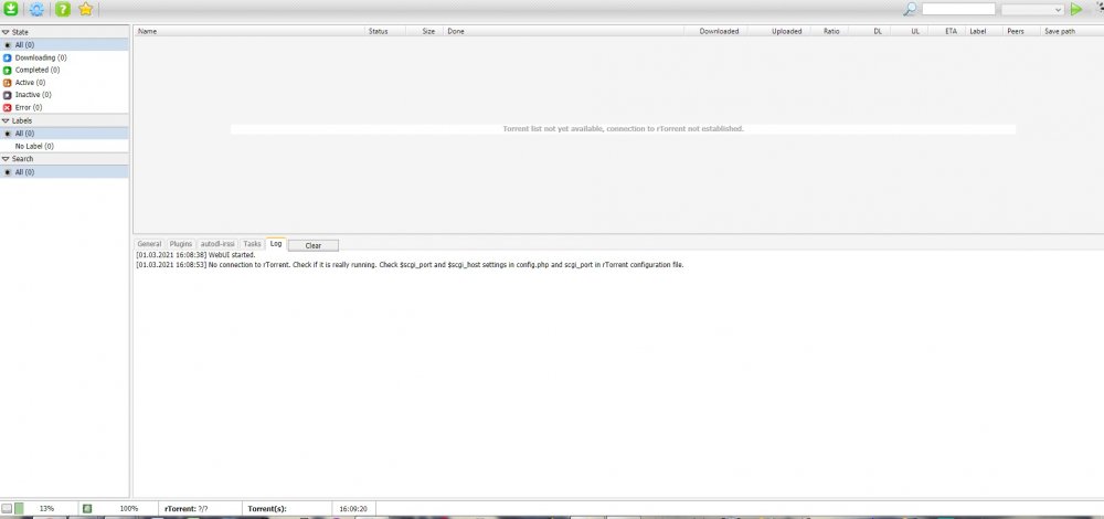

Out of nowhere my container is messing up. I've had it running with no problem for months and now I am getting a bunch of errors.
[01.03.2021 08:56:39] WebUI started.
[01.03.2021 08:56:42] _cloudflare: Plugin will not work. rTorrent user can't access external program (python).
[01.03.2021 08:56:42] _task: Plugin will not work. rTorrent user can't access external program (php).
[01.03.2021 08:56:42] autotools: Plugin will not work. rTorrent user can't access external program (php).
[01.03.2021 08:56:42] create: Plugin will not work. rTorrent user can't access external program (php).
[01.03.2021 08:56:42] datadir: Plugin will not work. rTorrent user can't access external program (php).
[01.03.2021 08:56:42] history: Plugin will not work. rTorrent user can't access external program (php).
[01.03.2021 08:56:42] loginmgr: Some functionality will be unavailable. rTorrent user can't access external program (php).
[01.03.2021 08:56:42] ratio: Some functionality will be unavailable. rTorrent user can't access external program (php).
[01.03.2021 08:56:42] retrackers: Plugin will not work. rTorrent user can't access external program (php).
[01.03.2021 08:56:42] rss: Plugin will not work. rTorrent user can't access external program (php).
[01.03.2021 08:56:42] rutracker_check: Plugin will not work. rTorrent user can't access external program (php).
[01.03.2021 08:56:42] scheduler: Plugin will not work. rTorrent user can't access external program (php).
[01.03.2021 08:56:42] trafic: Plugin will not work. rTorrent user can't access external program (php).
[01.03.2021 08:56:42] unpack: Plugin will not work. rTorrent user can't access external program (php).
[01.03.2021 08:56:42] xmpp: Plugin will not work. rTorrent user can't access external program (php).
[01.03.2021 08:56:42] _task: Plugin will not work. rTorrent user can't access external program (pgrep).
[01.03.2021 08:56:42] mediainfo: Plugin will not work. rTorrent user can't access external program (mediainfo).

I'm having a strange issue with the rtorrentVPN container. I installed this a week or so ago and it has been running fine but overnight it crashed and then every time I boot it up, it will only work until for a few minutes before rtorrent crashes. I can open the rutorrent gui but none of my torrents show up and it just says it can't connect to rtorrent (see attached photo). One time it worked for a day or so, but only because (seemingly) I never actually opened the webgui. That seems to be what kills it.
Per your instructions I:
1) Deleted the supervisord log file
2) Removed the container
3) Rebuilt the container using my stack
I waited until I knew it had crashed and then copied the log file.
If you could point me to some way I can fix this, I would greatly appreciate it.
Thanks!
supervisord.log
