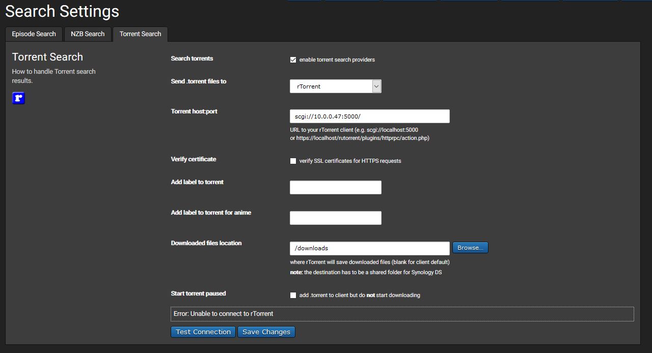

On 13.1.2018 at 2:12 PM, KriZ82 said:
I got it working now. I was using the username and password and it wasn't working. Without it works fine.
Speeds are very good but I do get a Tracker: [Unable to connect to UDP tracker.] error.
 I still can't make Sickrage talk to rTorrent, sorry.
My torrent host/port line is scgi://10.0.0.47:5000/ (I use 10.0.0.0/24).
I do not quite understand " I was using the username and password and it wasn't working. Without it works fine." Which username and PW?
your config should look like this:-
https://github.com/binhex/images/blob/master/docker/config/sickrage-rtorrent.png
It does.

On 4/30/2018 at 11:39 AM, binhex said:
ok, and rtorrent is up and running?, as in rutorrent can communicate with rtorrent?. another question, how have you defined the port mappings?, im assuming container port 5000 is mapped to host port 5000 right?.
rtorrent and rutorrent are running without a problem and I did not touch port 5000 at all - so to my understanding it should be handed straight through.
Edit: Shit, I just saved the Sickrage configuration file again - and now it works. Stranger things....
Thanks for the help!
One other question: If I wanted to access rtorrent remotely, via a DynDNS, I assume the Container Variable: LAN_NETWORK will keep me from doing so unless it is set to a value that accepts all incoming IP addresses (I deleted the standard user, created my own and avoid using standard ports, so I figure I am reasonably safe).
If that assumption is correct: What value would I have to use?
