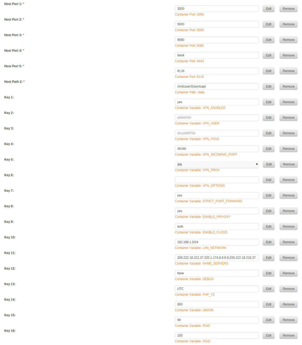

6 hours ago, pervin_1 said:
Hey binhex, can you explain how to use this docker image in multiple containers, meaning, if I can use this docker image with multiple running rtorrent clients?
I tried to do it myself, started by creating brand new with completely different ports to avoid port conflicts, but for some reason, it does not work, I can see the folder created for the new container, but nothing inside. Can you explain the proper way of doing all this, please. Thank you!!!
yeahs sounds like your close, so there are 3 things you need to do:-
1. use unique ports on the host side for each container (sounds like you have done this)
2. use unique host path for the /config volume mapping - required as each container needs a clean area to create configs etc
3. ensure your vpn provider allows concurrent connections - not all do, i know pia allows 5 (i think) concurrent connections.
1. Unique ports are done, verified with Unraid as well to make sure no conflicts.
2. Also used unique path for /config volume mapping, as you said, each container requires a clean area for config folders and files.
3. Don't use VPN anymore, I am with private trackers at the moment, Privoxy disabled, Flood UI disabled.
I tried again this morning, I named the new config folder on the host as "binhex-rtorrent", during the installation, which is unique, and for some reason, docker merged the new container with the old running one after the installation, it does not create the config files for some reason, check the picture down below, please:

hmm ok post the supervisord.log file.

@pervin_1 ahh its a bug!, a rogue function slipped into one of the scripts, god knows how it got committed but its there (late night coding with beer perhaps hehe), i will remove it and rebuild, obviously this only affects you if you turn off the vpn (thus why i havent spotted it :-) ), watch out for a new image.
You are right about the VPN, I was able to run the 2nd container from the same image of your's last week and it worked with VPN enabled just fine, this time I was trying to do without VPN and it kept messing things up, glad to know you are on top it, god bless you and your hard work, binhex. Don't drink too much beer, haha, its addictive, can tell that from my beer belly..
the image is built so you should be good to go now.

Can confirm that everything works on my end, your magic did the trick, you are awesome, binhex!!!

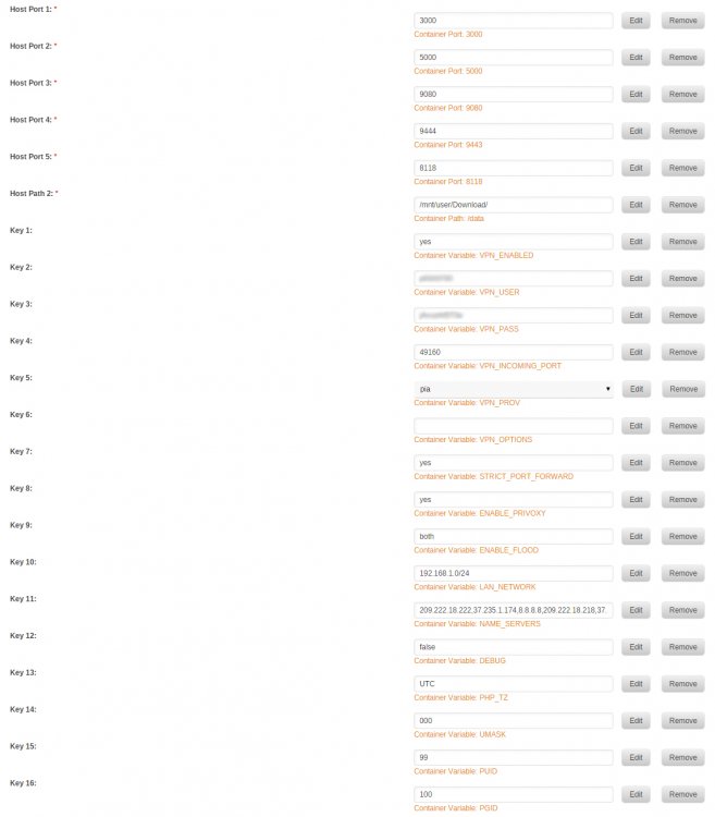

I hope someone can help. I have been having issues with Privoxy not working. I have had it setup in Jackett working fine before but it has now stopped working. I have not changed any of the configs and there don't appear to be any errors in the logs. I also used a proxy testing tool on my windows machine to test Privoxy and it fails. I know the VPN is up and working for rtorrent as I have tested it with an IP testing torrent. Any ideas whats going on?
rtorrent logs: https://pastebin.com/J7cXpqr8
proxy test logs: https://pastebin.com/AJi2uugh
screenshot the unraid/docker webui with advanced view switched on for this container, i want to see what port mappings you have defined.
I hope that is all you need to see @binhex ?
