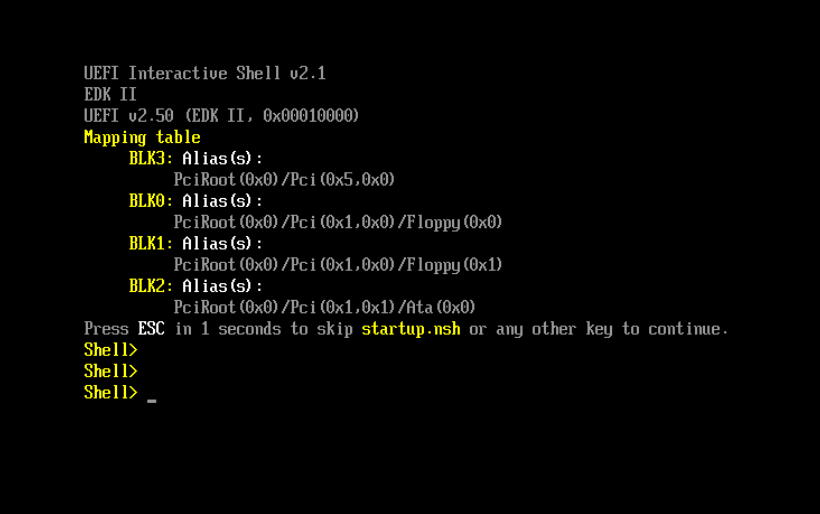

The VNC output shows this:
switch your VM install from OVMF to SeaBios perhaps?
I thought about that but it was greyed out. I redid it with seabios and it is booting, albeit very slowly. I need to assign, and buy, more RAM. Thank you all.
I thought about that but how do I do it? The VM is stopped but the option to change is greyed out.
You can't change it without creating a new VM
Yes, I figured that out eventually. Thank you everyone.
