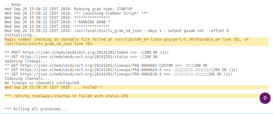

Good day Huxy!
I've installed your grabber as I had played back then with WebGrabPlusPlus and couldn't get it working. I've installed the docker, configured it as per your doc and I get this after every run:
Checking for XMLTV directory
Done
Checking for data directory
Done
Downloading newest JSON script.
Done
Done
.. Done
Sun Jun 5 13:17:07 EDT 2016: Running grab type: STARTUP
Sun Jun 5 13:17:07 EDT 2016: *** Launching Grabber Script! ***
Sun Jun 5 13:17:07 EDT 2016: ****************
Sun Jun 5 13:17:07 EDT 2016: * RUNNING GRAB *
Sun Jun 5 13:17:07 EDT 2016: /usr/local/bin/tv_grab_sd_json --days 14 --output guide.xml --offset 2
Sun Jun 5 13:17:08 EDT 2016: ... Failed!!!
I've followed how to manually configure it as per described here: https://hub.docker.com/r/huxy/xmltv-sd-json/:
##Configure grabber
sudo docker run -ti --rm huxy/xmltv-sd-json /usr/local/bin/tv_grab_sd_json --configure
Once I've run this, I was expecting files to appear in my /config folder but both folders (/config and /data) remains empty.
Would you have some insights on what could go wrong?
Thanks for the nice docker and have a great day!
EDIT: I've been attempting to troubleshoot the issue by myself. Basically, whenever I run this command:
, it seems to create temporarily a container where the file is saved and removed as soon as the command exits. (Wouldn't this be caused by the -rm argument?) Anyway, I've tried working around this but couldn't get to copy the .conf file it generates.
Is there some way to keep the config file into my /config folder? Thanks!

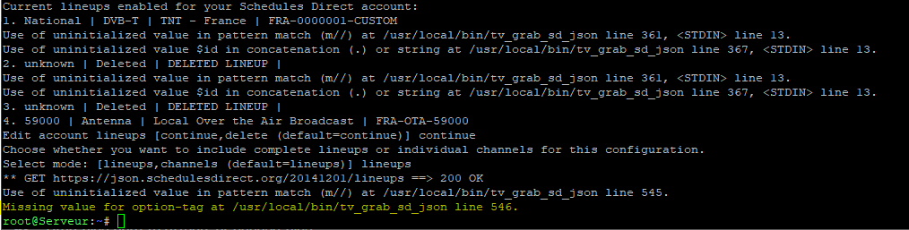

I have installed the docker image for XMLTV Schedules Direct.
I used the commande ' sudo docker .....-configure' to create the 'tv_grab_sd_json.conf' file.
At the end of the script, a first warning appeared (see attached capture1 file).
When I start the docker via the GUI, the grabber seems to run  but when I look at the event log , I can see other events (please see capture2 file).
The /usr/local/bin/tvgrab_sd_json file doesn't exist and I can't define a lineups.
I hope you will be able to help me.
Thank you in advance.

Hi
Thank you for your responses.
The issue is still here.
Please, to help me, could you look at the capture attached and tell me if the last line is normal.
The /usr/local/bin/tv_grab_sd_json does not exist . I don't understand the warning.

On 9/28/2018 at 6:21 PM, didiergo said:
Hi
I've tested the docker and it works fine. The grabber script hasn't been updated in a couple of years, so it's not as if a new bug would have been introduced. Looking at your screenshot, there's a significant number of issues with the lineup data being retrieved. It's possible that the data is corrupt or not in an expected format from Schedules Direct. I would use the client and delete all your lineups, then add one and retry the process.
