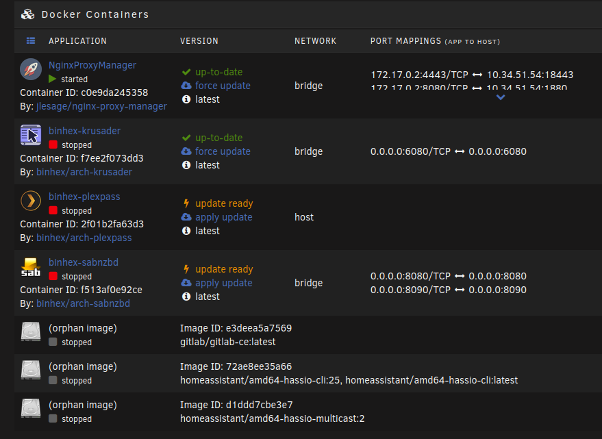

I'm about to panic -
I was in the middle of a the update process of the gitlab.ce image when a power-outage occurred.. unRaid is up but not sure how healthy my docker environment is. One thing is for sure that gitlab.ce is definitely not 😞 - It does not even show anymore as installed - only the inactive container - Will the docker pick up everything that was allready there or do I have a serious problem ??
EDIT:
Trying this at the moment - not having fun at the moment (because I'm too lazy to sort out my backups)
EDIT2:
Panic attack over - gitlabce is running fine - no data lost there..
