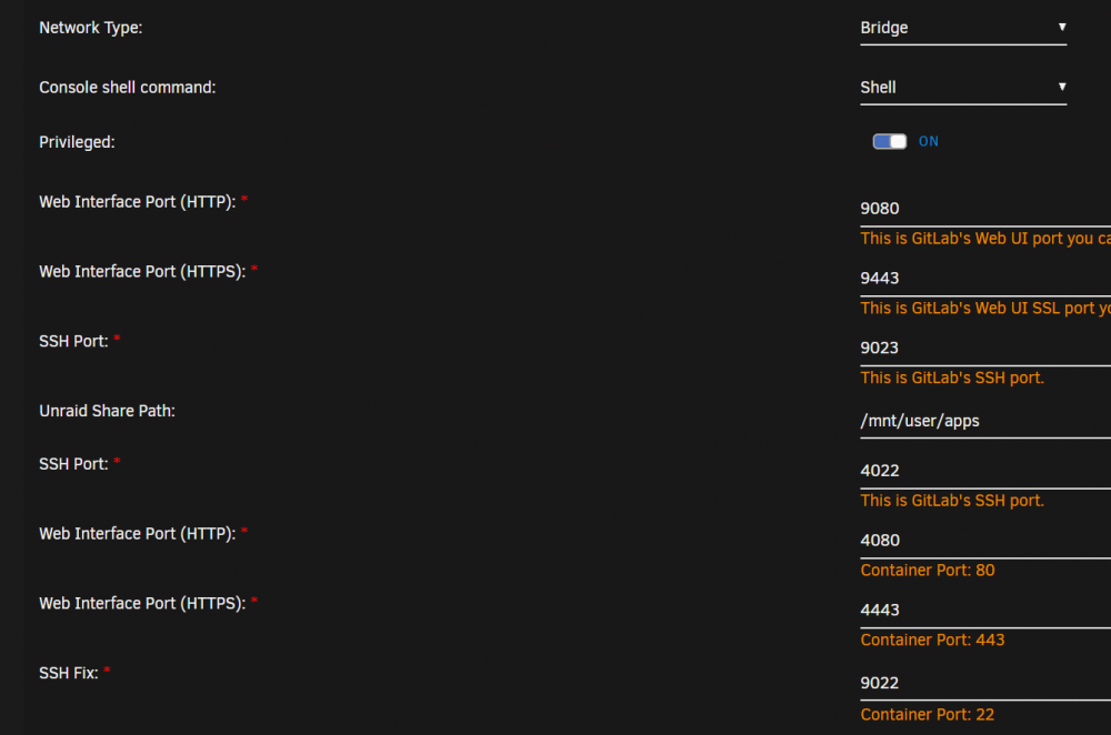

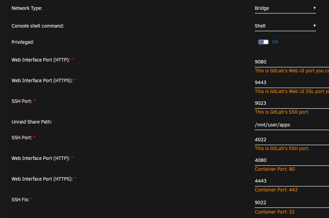

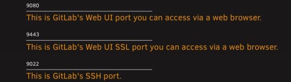

Anyone have an issue with there being two instances of port 9022 in the template and it makes the docker not start?
I originally fixed it by removing one, but then Fix Common Problems complained, so I just changed one to 9023.
Just wanted to check on this to see if it's truly the original docker template or if my template was somehow misconfigured by me.
Mine just has these three ports: 9080, 9443, 9022 by default.
Kind of a noob here, hopefully someone can help me out.
Got the docker image from CA and i have most of it working via letsencrypt to my [email protected] and its working well but now i want to try it with SSH to avoid passwords (for school projects) but i simply cannot get it to clone, it just hangs...
changing the inside port to 9023 doesn't seem to change anything and changing inside port to 22 makes the docker simply not open....
here are some of my configs.... Do i have to open port 22?
