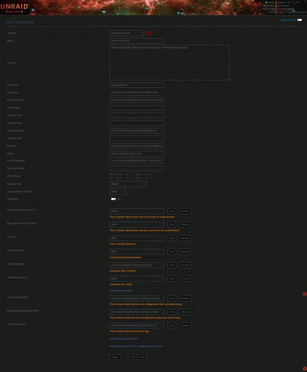

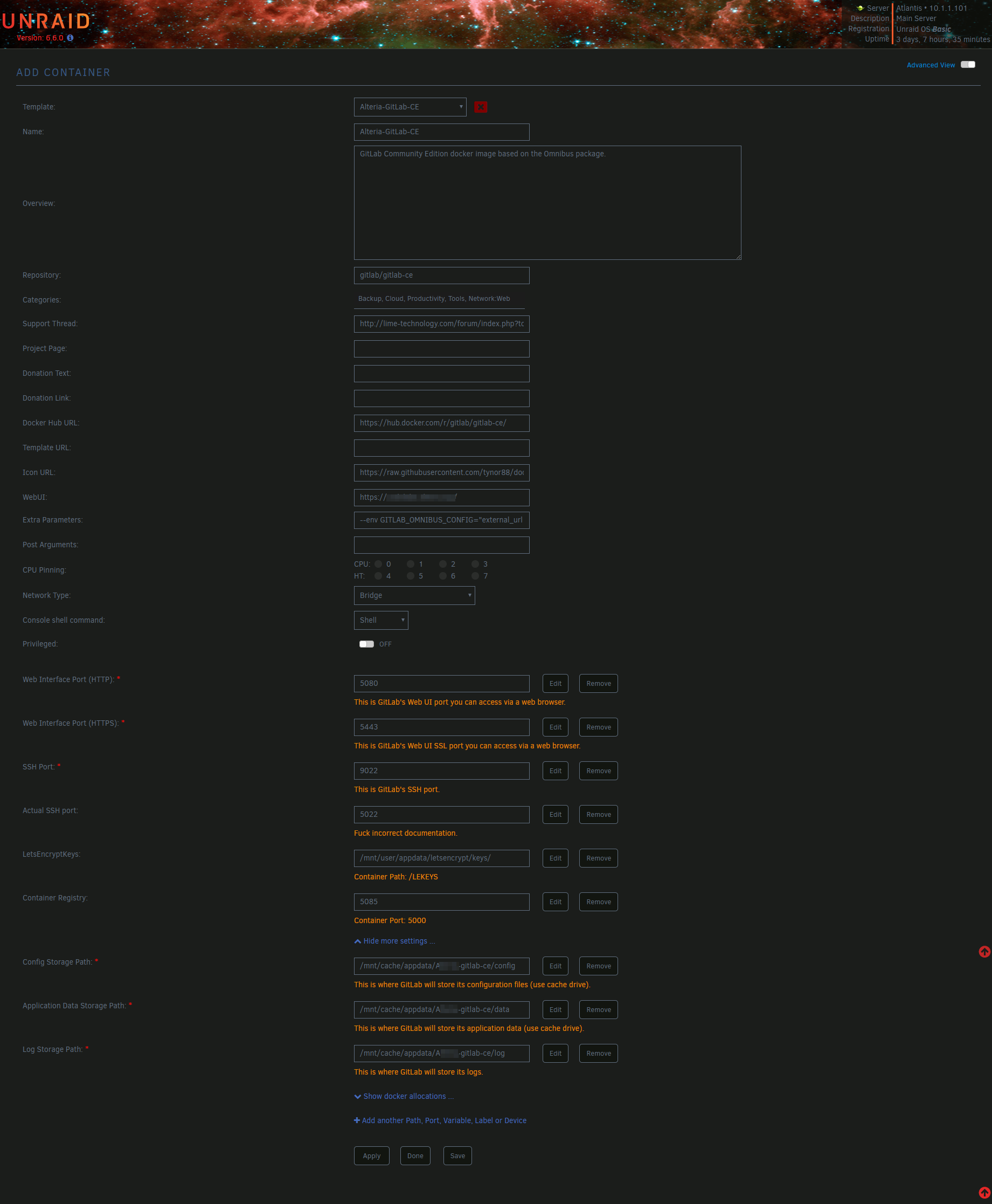

This docker is failing to load for me after updating it this morning. The following error is returned:
root@localhost:# logger 'docker command execution halted due to security violation (Bash command execution or redirection)'
The command finished successfully!
Because in the extra parameters or something you are attempting to run a bash command and/or redirect the output of the docker run command somewhere else.  (and it's not related to an update of the container, but rather its a 6.6 thing) It is a security violation, and can potentially trash the host OS.  Edit the container, switch to advanced mode and post up a screenshot.
Edited by Squid
The extra parameters are `--env GITLAB_OMNIBUS_CONFIG="external_url 'https://abc.def.com/'; nginx['listen_port'] = 9080; nginx['listen_https'] = false"`
ok.  Bug in unRaid (my fault actually).  Logic error in how its looking for a bash command, and it's picking up the semi-colon wrongly (due to the nested quotes).
I won't be able to issue a PR for a couple of days to fix this issue, but in the meantime on unRaid 6.6 you can execute this command via user scripts (run once at array start) to bypass it
sed -i 's/function dockerRunSecurity($command) {/function dockerRunSecurity($command) {return false;/g' /usr/local/emhttp/plugins/dynamix.docker.manager/include/Helpers.php
Edited by Squid
8 minutes ago, Squid said:
Actually, go to plugins / install plugin and paste this url in instead:
https://raw.githubusercontent.com/Squidly271/misc-stuff/master/unRaid6.6.Hot.Fix.plg
Very quick and dirty, FCP will complain about it, but it should do the trick for you.
Alright, that's done the trick beautifully. Thank you very much, that was an amazingly fast hotfix >.<
