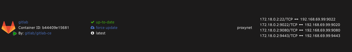

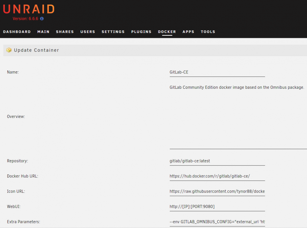

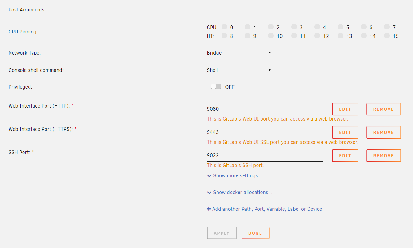

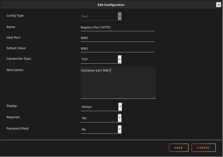

I'm trying to configure the Docker container registry on GitLab-CE but I don't seem to be able to add a port for it to listen on.
I've added this to my extra parameters:
registry['registry_http_addr']='192.168.69.99:9081';registry_nginx['enable']=false;registry['enable']=true;
and added a redirect for port 9081, but it does not show in the container list after clicking "apply" (see screenshots).
The container's network type is set to "proxynet", as per SpaceInvaderOne's nginx proxy video, so I can access the container registry from outside my own network.
What could be going wrong here? Port 9081 doesn't seem to be mapped to any other containers (and, even if it was, I'd expect unRAID to open a dialog telling me this, rather than silently failing : ) and other ports I've tried fail to show up in a similar way.
I've found that the network type is the cause of the problem — when this is set, unRAID allows setting the host port but not the container port. To fix, change the network type to "bridge", add/edit the port setting, then change the network type back to "proxynet".
I'm not sure if this is an unRAID bug or not — it doesn't seem like the correct behaviour, but I'm not sure how unRAID is supposed to know what to do with a network created with "docker network create"…
If you set a container to custom network and it's own IP, there are no port mappings anymore. It's like setting the network to host. The ports specified in the application is then used.

I'm new here and quite unexperienced with UnRaid and Docker as well... I have been able to install GitLab-CE and running, but after reboot it breaks down and won't be able to start up again. If I nuke the folders etc and reinstall it i works. Yesterday I was able to reboot aswell. Tried to reboot this morning and after that it won't come back up again.
The extra parameter field contains this:
--env GITLAB_OMNIBUS_CONFIG="external_url 'http://unraid:9080/'"
Please se the attached pictures of the configuration and copied logs.
Please help me to solve this problem once and for all... I really like this application and want to be able to host it by my self.... Maybe a backup-config could be something to think about to.....
Regards.
The logs give me the gave message every time this error occurs.

Just set this up and the SSH service on the container runs on port 22, but the template is configured to use 9022.  I used P.ortainer to resolve the issue
What does portainer have to do with the ports of the template and inside the container?
Let me easily edit the port mapping after using the template.  Rather than dropping into the CLI.  I did create a pull request to fix the port in the template though.
