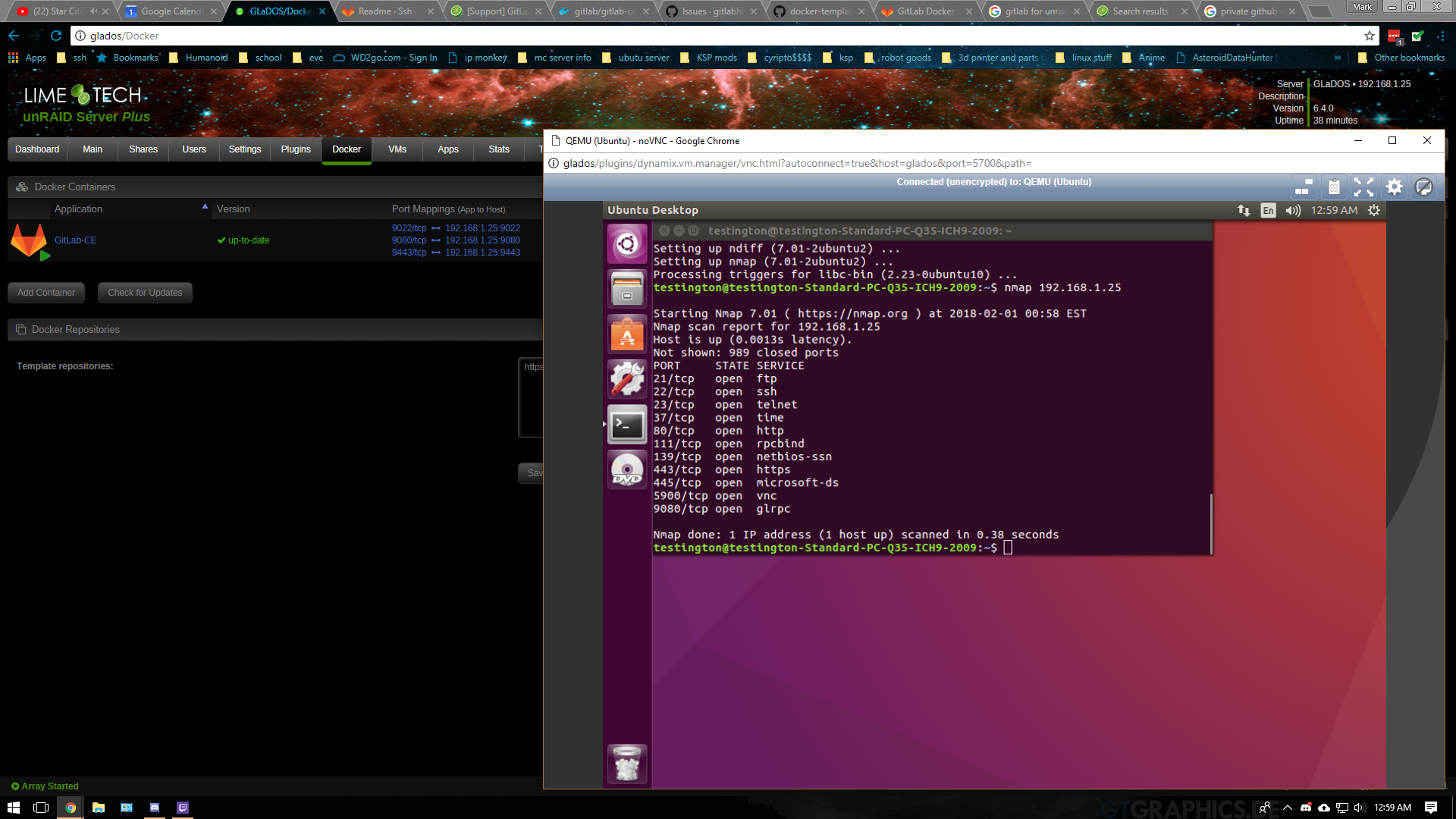

Hi everyone,
I am currently trying out gitlab for the first time and am having issues with the ssh connection. It continues to ask for a password and I cant seem to find out what is causing this issue. Does anyone have any ideas what could be causing this and or also having this issue?
Mark
Hi Everyone,
Just a bit of an update that seems weird to me is that the ports aren't being forwarded. Am I seeing things or could this be my problem?
