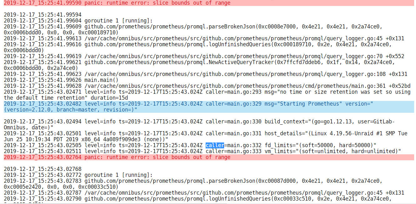

I'm not even talking about sourcegraph. the gitlab container "died" after one of the latest updates. It does come up, but no way to connect to it.
The log give some panic errors:

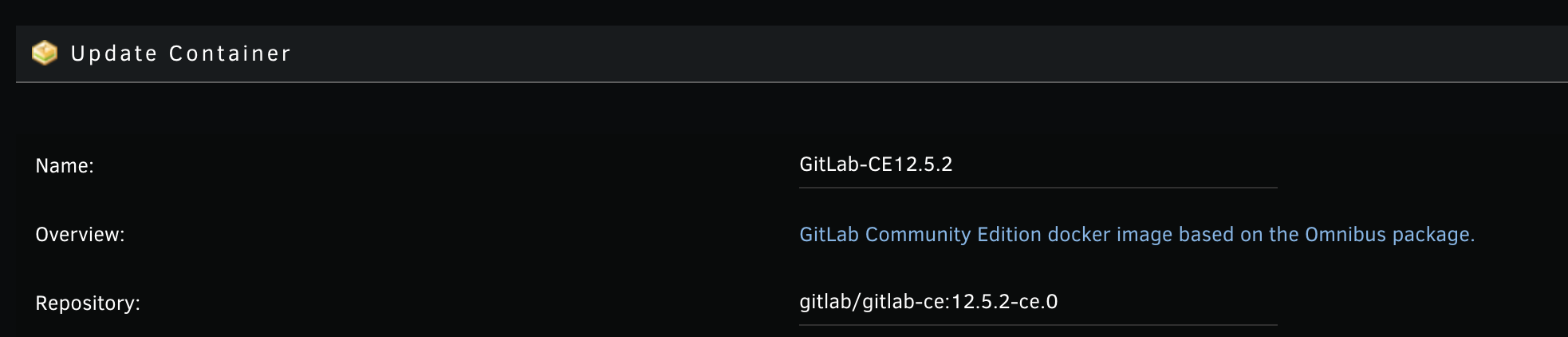

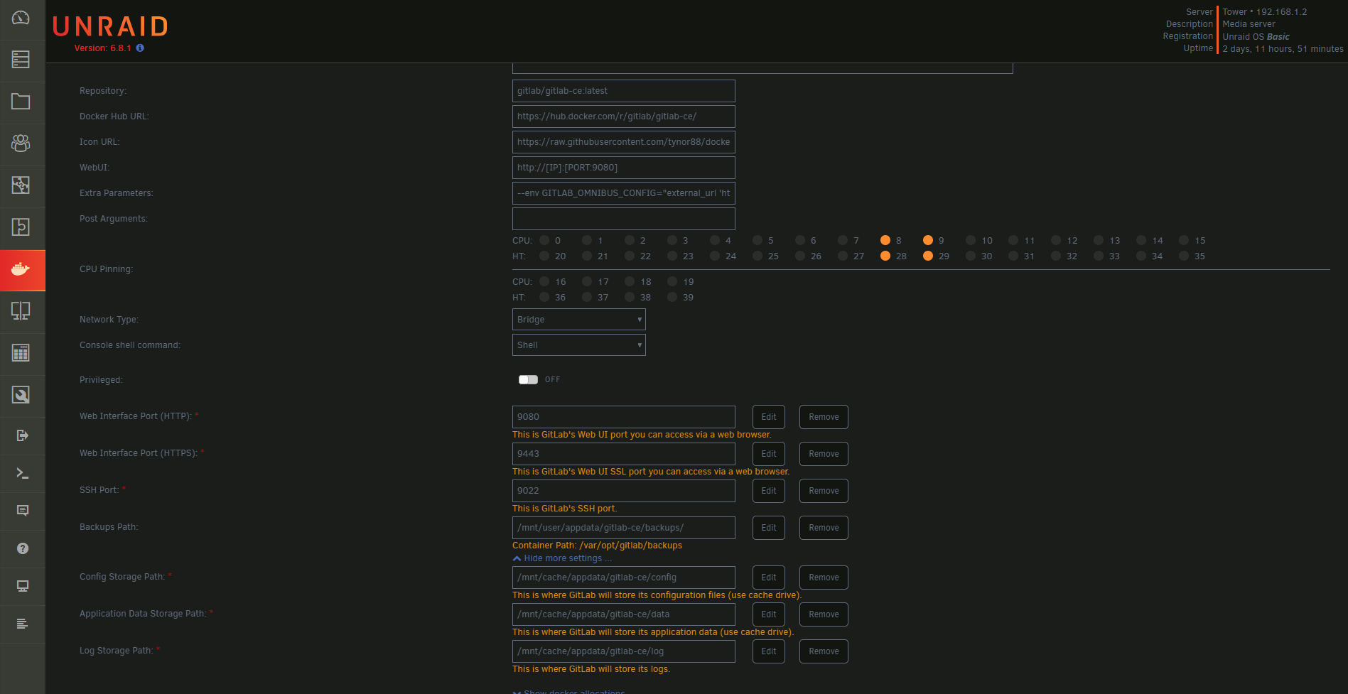

@ElectricBadger @JasterCan you go back to a working earlier version? I have mine pinned to 12.5.2-ce.0 which I know works for me. I don't update the docker but when I do, I pin it to the version I want. See screenshot below for my Docker Settings
How do I go back to a specific version?...
In my screenshot above I show the string I used for "Repository". This allows you to select the tagged versionof Gitlab that you want.
Change it from:
gitlab/gitlab-ce:latest
to :
gitlab/gitlab-ce:12.5.2-ce.0
(or anything you want)
You can go to dockerhub and choose from a list of official tags.

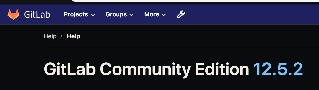

On 12/17/2019 at 10:02 AM, Jaster said:
Does anyone has a running/working instance of that docker?
I just updated mine to the latest 12.5.2 and it works fine:
I've noticed that on some docker containers that keep crashing sometimes, that if I edit the Docker configuration and just add an empty field or make a trivial change to the description and Apply it, then it re-runs the docker command to create the container and it starts working again. Even with a pinned version of the image so it can't be because of a new feature or bug-fix. Try doing that.

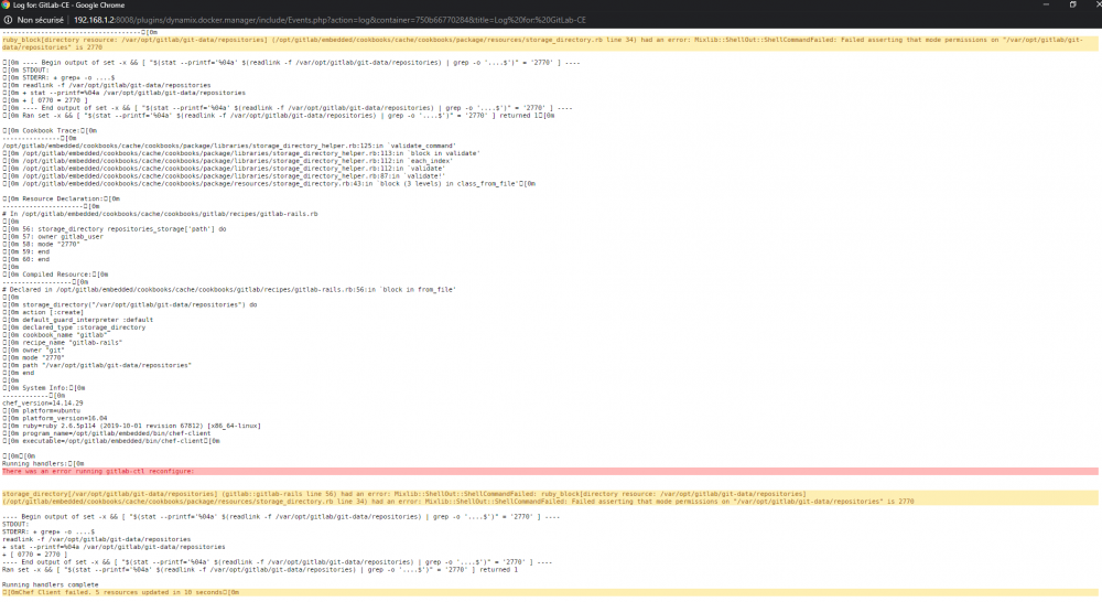

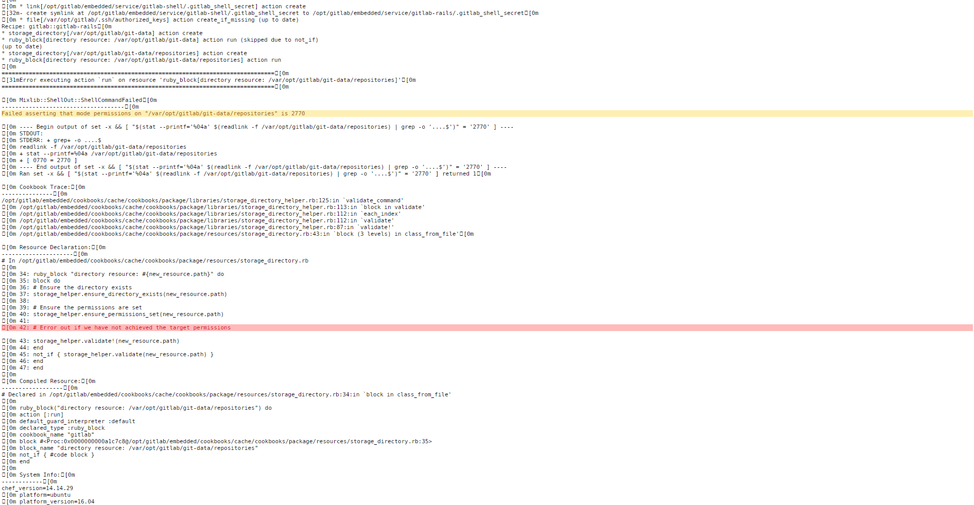

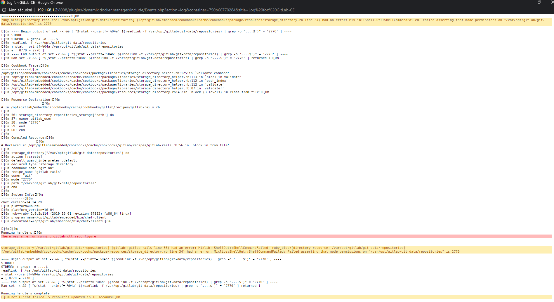

Hi guys,
I got a problem with my gitlab-ce docker, it cannot start anymore. I use the latest version.
If someone can help me, it well be appreciate.
It appears to be permission issues against what is presumably your appdata share for GitLab.  Have you inadvertently run the new permissions tool against that share?
Do you have any other problems with the server / shares?
What's you docker run command look like?
Thanks Squid, yes I think I have run the new permissions tool on appdata, it's a mistake. At this moment I don't think I have other problem, but I will find out pready soon.
About the "docker run command", I want to show you but I don't know where I can find that, could you tell my more about that.
Thank you
Yup.  That's the reason why the Fix Common Problems plugin has also on the Tools Page a "Docker Safe" permissions tool which specifically excludes the appdata share.
Trouble here is that any given docker app may have its own arbitrary permission and ownership requirements within it's appdata.  Generally it's just plain easier to delete the entire folder in question and start over than try and figure out what it's requirements may be.
But, in a pinch this command *may* work in a last resort (it can't get any worse ;) )
chmod 0777 -R /mnt/cache/appdata/gitlab-ce
@Squid I have already tested to give all access to the folder with this command, the docker want start. [emoji45]
Envoyé de mon SM-G965W en utilisant Tapatalk
@Squid, I resolved my problem using WinSCP and changing the permissions on appdata/gitlab-ce to 0777 (I have check "Set group, owner and permissions recursively"), I don't understand why it didn't work with "putty" the first time... Thanks

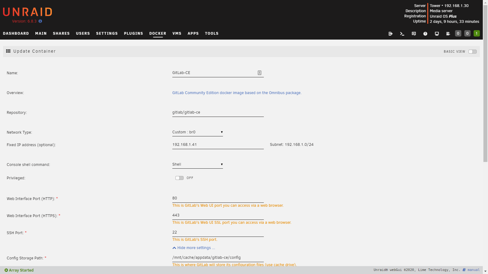

So I've got this image running, but I'd like to be able to point my browser directly to it without having to specify the http(s) port. I've set the network to br0 with it's own IP address. I also changed all of the port numbers to their standard values (80, 443, 22). When I open the webgui from the unraid docker page, the url still goes to port 9080 and it works. But if I just enter the IP address without specifying a port, the connection is refused.
How come the image doesn't respect the port settings?
What else do I have to change?
You only changed the port mappings. Gitlab itself doesn't know about those mappings.
When you set an IP for the container, the port mappings are obsolete and will be the ones set in the container (Which is the container ports in the template).  So to change these to the standard http/https/ssh ports, you need to change the settings file in gitlab.
