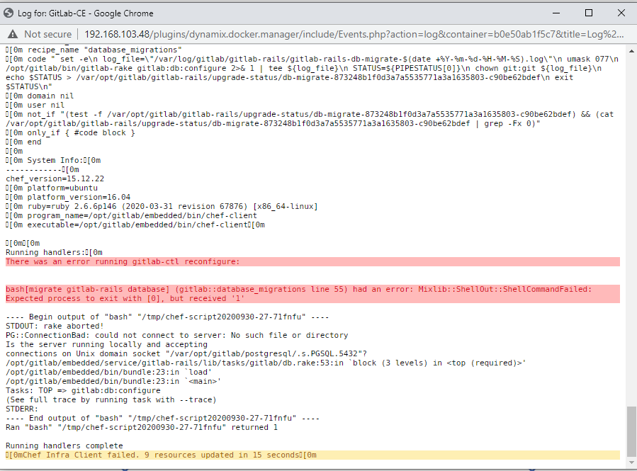

I tried to install few times this docker container into my unraid, but always a have the same error:
[0m[0m
Running handlers:[0m
There was an error running gitlab-ctl reconfigure:
bash[migrate gitlab-rails database] (gitlab::database_migrations line 55) had an error: Mixlib::ShellOut::ShellCommandFailed: Expected process to exit with [0], but received '1'
---- Begin output of "bash" "/tmp/chef-script20200930-27-71fnfu" ----
STDOUT: rake aborted!
PG::ConnectionBad: could not connect to server: No such file or directory
Is the server running locally and accepting
connections on Unix domain socket "/var/opt/gitlab/postgresql/.s.PGSQL.5432"?
/opt/gitlab/embedded/service/gitlab-rails/lib/tasks/gitlab/db.rake:53:in `block (3 levels) in <top (required)>'
/opt/gitlab/embedded/bin/bundle:23:in `load'
/opt/gitlab/embedded/bin/bundle:23:in `<main>'
Tasks: TOP => gitlab:db:configure
(See full trace by running task with --trace)
STDERR:
---- End output of "bash" "/tmp/chef-script20200930-27-71fnfu" ----
Ran "bash" "/tmp/chef-script20200930-27-71fnfu" returned 1
Running handlers complete
[0mChef Infra Client failed. 9 resources updated in 15 seconds[0m
***I tried to start up the docker few times, i tried to reinstall and the same result. Someone have a idea that's hapen.
***Unraid version 6.8.3
Regards

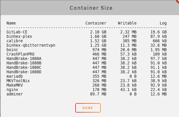

How big should this container get?
I'm getting warnings about my docker image running out of space and this is the chief offender with the log taking up 19.6 GB. Is that supposed to be the mapped log directory in my config? Because that is mapped to /mnt/cache/appdata/gitlab-ce/log and that directory has files written in the last 20 minutes, as I shut it down, and is only 2.6 GB.
I can kill off the docker image and expand it's allocation, I'm just not clear what this is trying to tell me.
Add --log-opt max-size=10m --log-opt max-file=1 to the extra parameters of the docker template. You can also disable prometheus_monitoring to trim it down a bit if you're not using that. Mine looks like this:
--log-opt max-size=10m --log-opt max-file=1 --env GITLAB_OMNIBUS_CONFIG="external_url 'http://xxxxxx:9080/'; postgresql['shared_buffers'] = '256MB'; sidekiq['concurrency'] = 15; prometheus_monitoring['enable'] = false;"
While that looks useful, I'm still not clear on why the docker image would balloon when the paths are mapped to actual storage. I was under the impression that the docker image would only grow from things that were not on mapped storage.
Ah, a bit more reading makes it obvious why that's the magic to make this work. Thanks frankman1!
